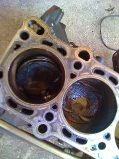

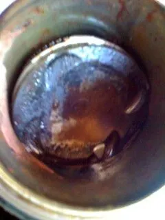

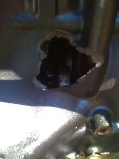

so i have finnally pulled everything apart and gotten started!!!!!!!! two holes in the block on the number 4 cylinder an a messed up piston and rod!!!! bout to be fully built and alot of power to come soon!!!! (I HOPE) the last picture was to make the hardship of stripping car down better!

i blew my motor last nite. it had a 141,546 miles and i did it at 15 psi and shiftin to fourth. i have six holes in the block.
