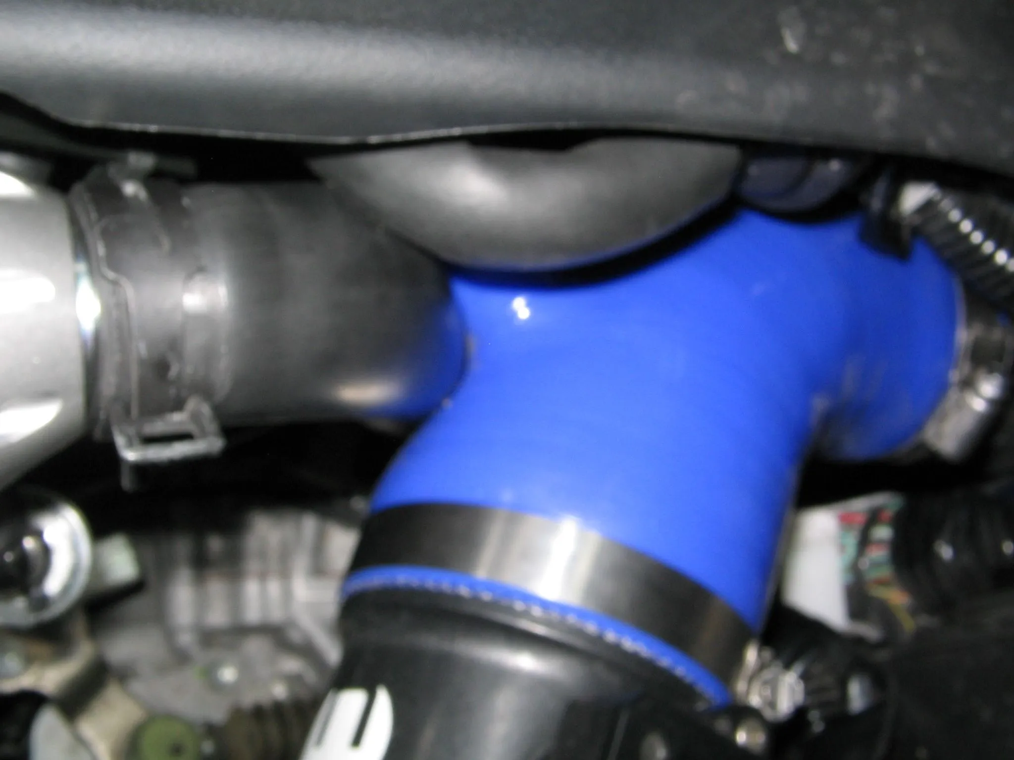

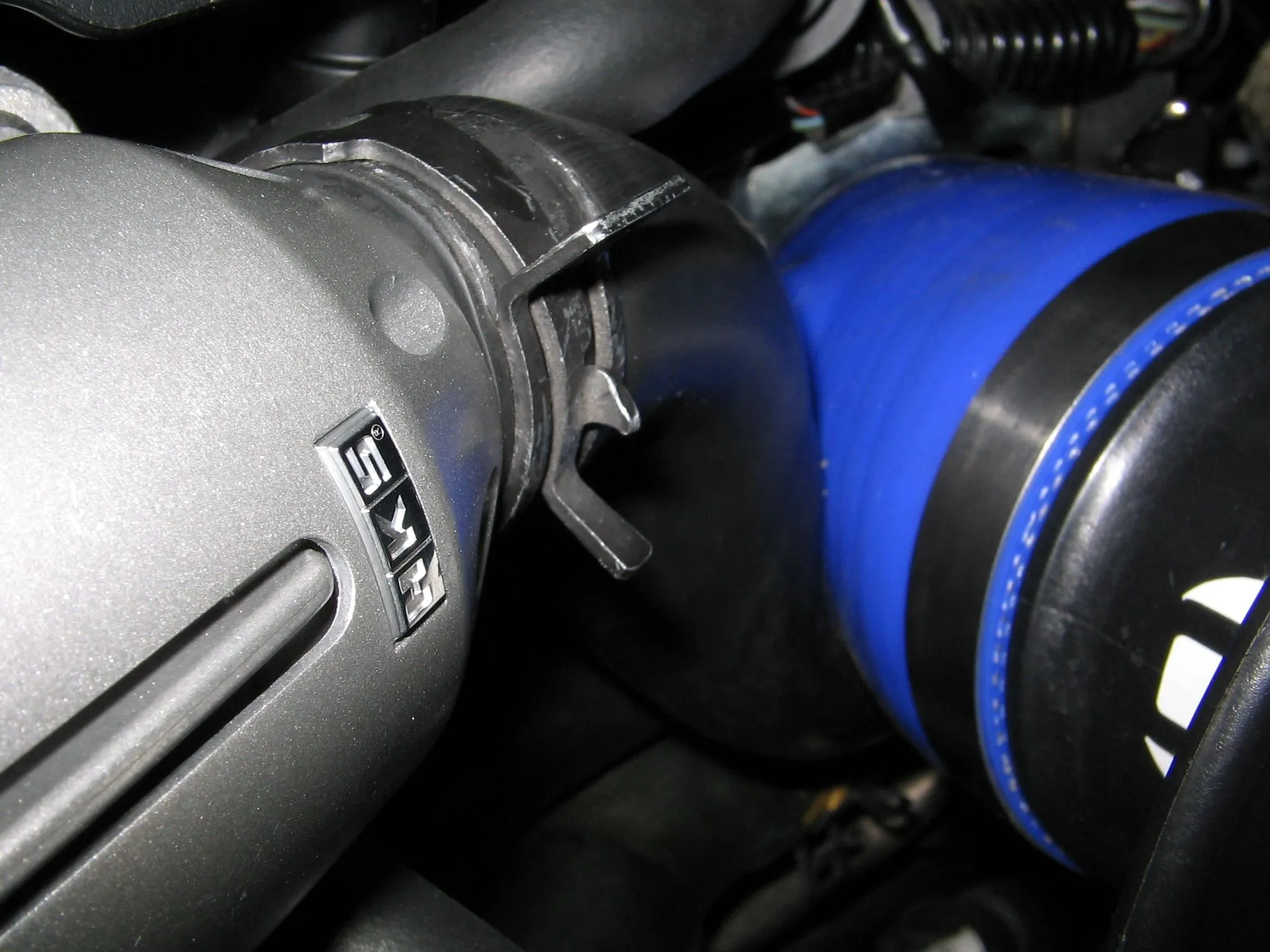

Fitment question for you Craig: how close is the bpv/bov mounting location/angle on your fmic compared to the stock mounting location? I'm curious to see if the Synapse will fit set-up for recirc along with a COBB SRI and stock IC. With the SRI and a stock IC, I had trouble getting the stock recirc hose around this particular intake charge hose when attempting to run a HKS SSQV no matter how I turned the stock hose. It just kinked way too much. I think the only option I had was to piece my own recirc hose together. Also, any chance the Synapse will include a recirc hose for MS3's or is the stock one to be re-used?

According to Synapse, you re-use the stock recirc hose, but need to cut an inch off of it. Looks like it will fit with the stock IC and a Cobb SRI.
why would you need to cut it? I don't want to cut my recirc hose, I want to be able to go back to stock.

I've posted these pics in another thread, but here is what the recirc tube looks like when attempting to install the HKS bolt on with the COBB SRI. The hoses were much too restricted due to kinking in my opinion no matter how I rotated the stock hose. You could see it pulling on the intake. I think you'd need to look for another piece of hose with a descent bend to it in order to get underneath the intake with this particular combo.
