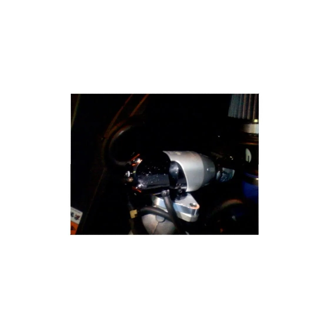

the synapse is a tight fit with the cobb SRI

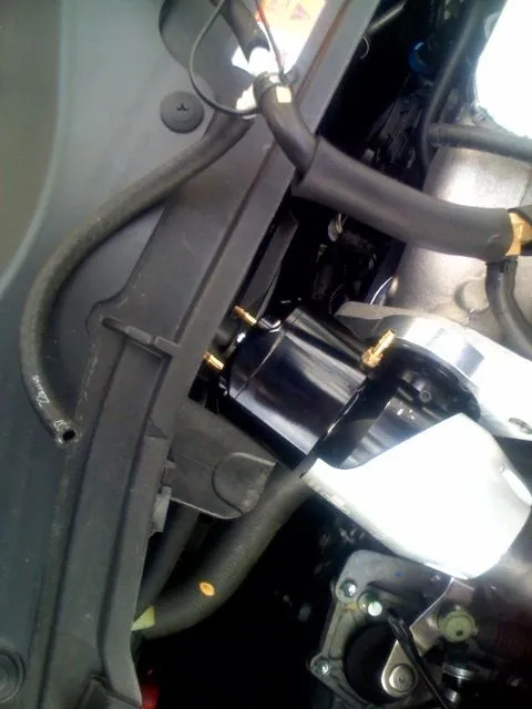

Hard to tell from those pics, but does the recirc hose have any kinks in it? Is it so tight that it's an issue? What flange did you use?
if you angle it the way they want the cobb SRI is completely in the way of the recirc tube.... thats what you see in the pic.... But if you angle it a bit down you get a better fit ill take a pic of waht i mean in a min....... also you may not want to cut the recirc tube untill you know you need too (on the 3 with the cobb SRI only) by the angle you select i had to pick upsome new hose and i only cut .5" off....

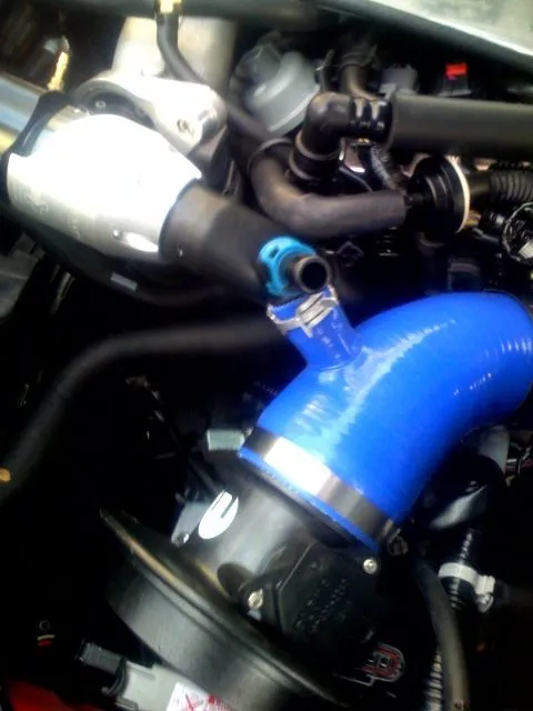

OK pic is a little dark but it was at 5:30 am so ill get a better pic up latter but you can see the position you need with the cobb SRI
The FMIC kits move the stock mounting flange location making it a little easier to get a good figment/adjustment **if you are using the stock mounting location and the Cobb SRI it takes some patients.....
