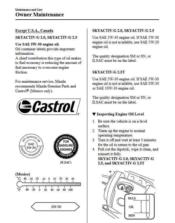

I've compared Mazda manuals from Europe vs USA. In the Europe's manual it says that the 5W30 oil can be used on non-turbo models, while in the USA's manual it says that it can be used only on turbo. So I decided to screw the CAFE requirements and I will ask the dealer to put 5W30 at the next oil service. I understand the requirement to make a car to achieve a certain mpg but that's not realistic. Each one of us has a different driving style, different mpg. I don't see how the CAFE thing applies to someone's car once the person bought it.
This is from the North American manual. I think you will be happier with 5W30, the engine definitely runs quieter.
⋯ So I decided to screw the CAFE requirements and I will ask the dealer to put 5W30 at the next oil service.
The only thing you want to make sure is you ask your Mazda dealer to put in full synthetic 5W-30 oil for you and put it in writing on the invoice. There’re plenty of conventional 5W-30 oils on the market but not on 0W-20. Even Mazda’s OEM 5W-30 oil isn’t a full synthetic.

Where does it say 5w-30 is ok for USA models? I only see 5w-30 listed in the “except USA, Canada” section.
