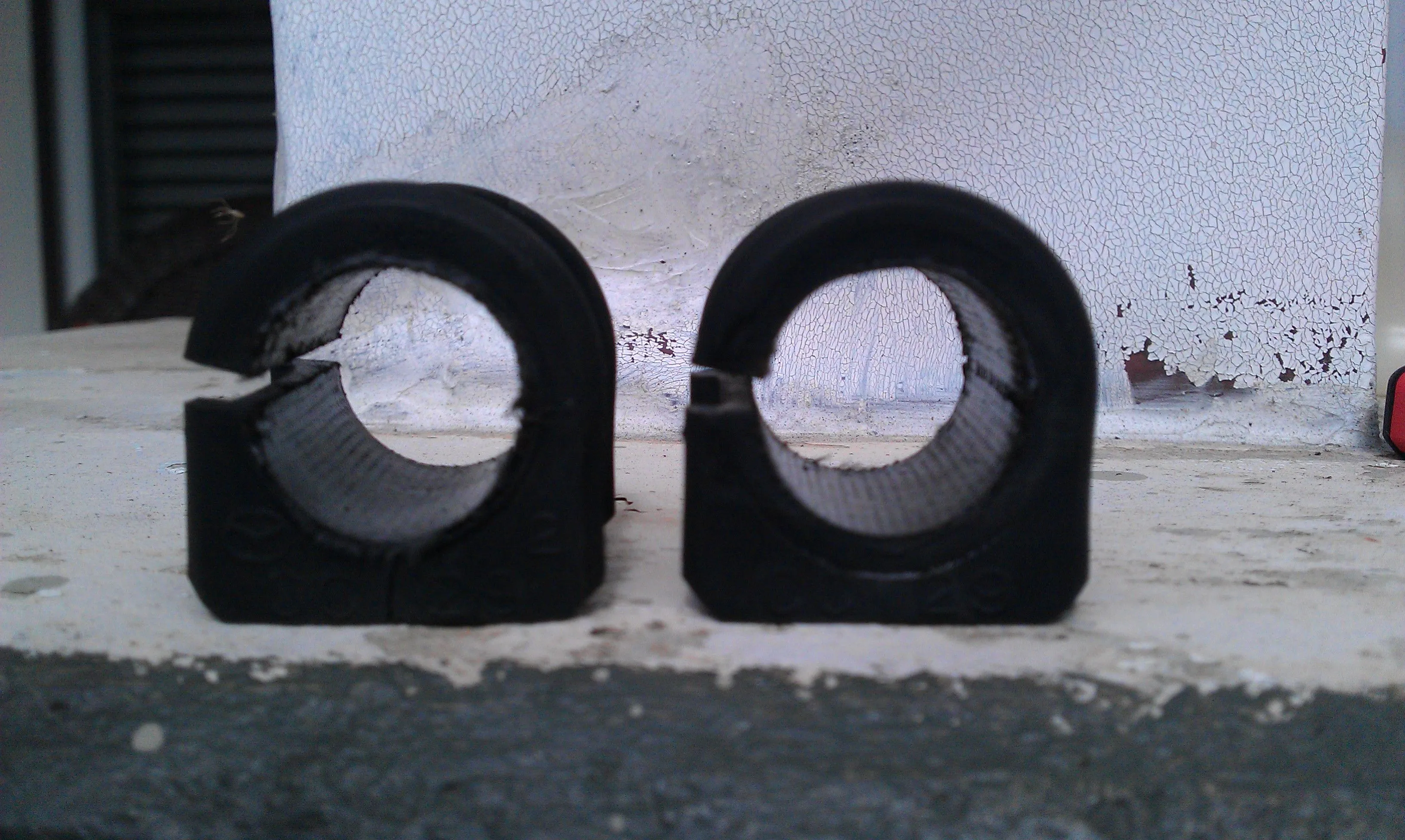

This is kinda weird. It's almost a year ago when I started this thread, and I just now today got around to replacing the bushings. Did brakes as well. First: Bushings. Yes. They are a pain in the rear to change. I was able to do it without loosening the subframe (I just didn't want to bother with all that - that's my reason and I'm stickin' to it!!). I got the vehicle up and sitting on jackstands then took several minutes looking at my options and decided to go for it. For me (and I must emphasize that this is what worked for me), I worked from underneath, behind the subframe, with one hand behind and one hand in front of the subframe and worked by feel. Since I knew what it looked like, it wasn't difficult. Loosened the bolts (14 socket with a small extension for the front bolt), raised the bar with a jack a little to remove and replace the bushing, lower the bar, locate and replace the bolts. The driver's side is little harder because the power steering lines are in the way, but same method applies. From start to finish, the bushings took about an hour or so. These are the old ones IMAG0012.webp. I purchased the new ones from the dealer ( I didn't want to deal with lubrication and zerk fittings etc. I'm lazy) so they are just like the ones in Post #34.

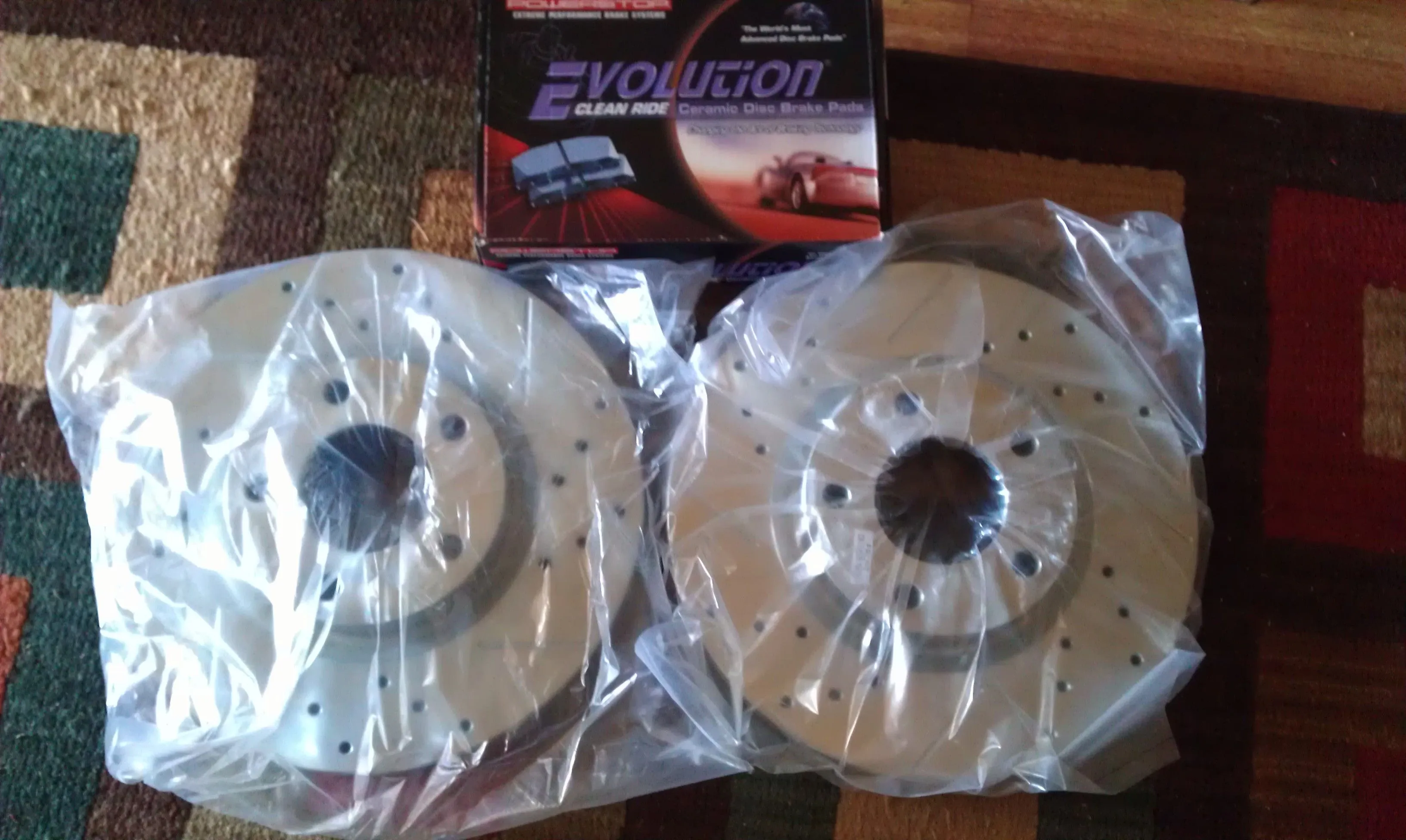

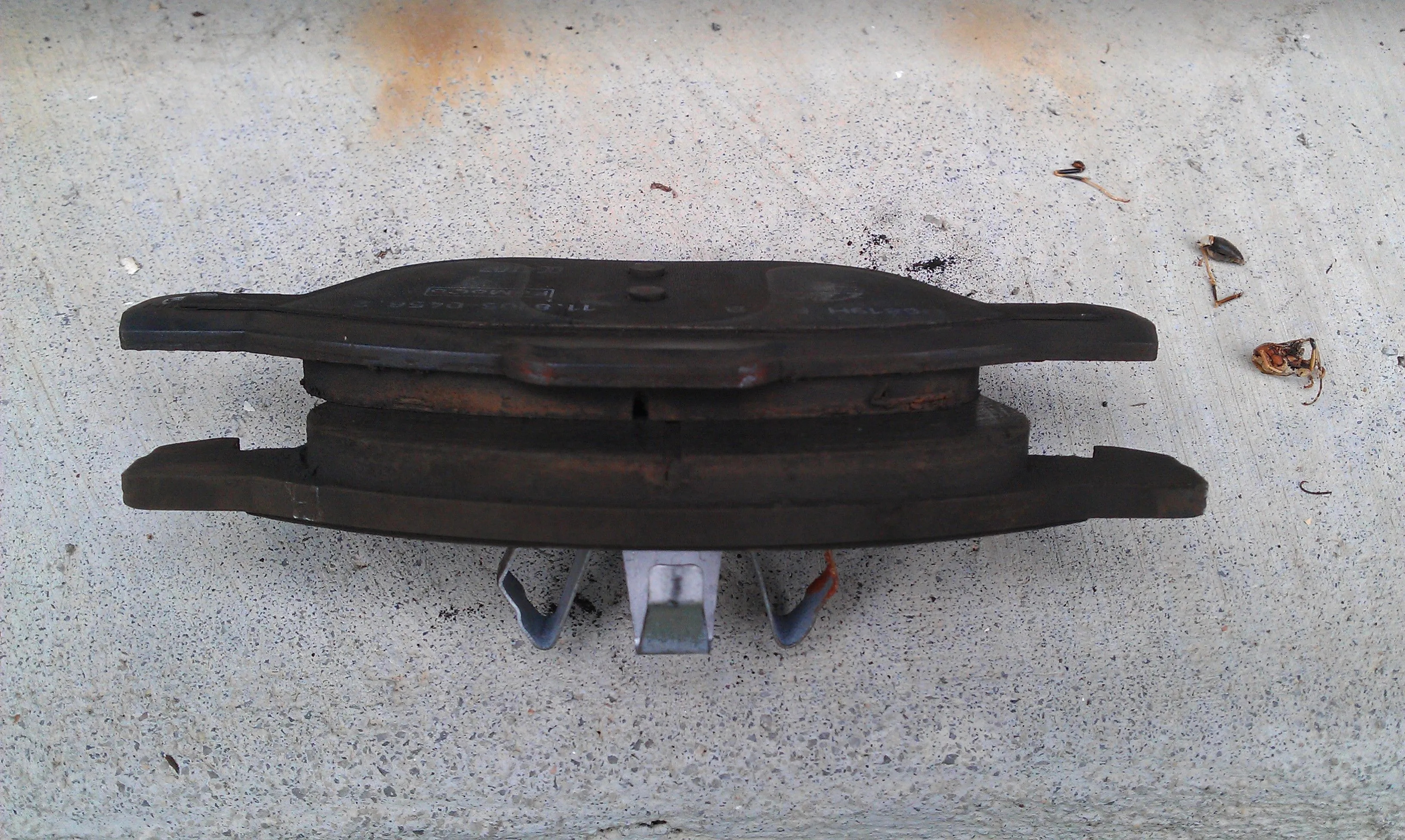

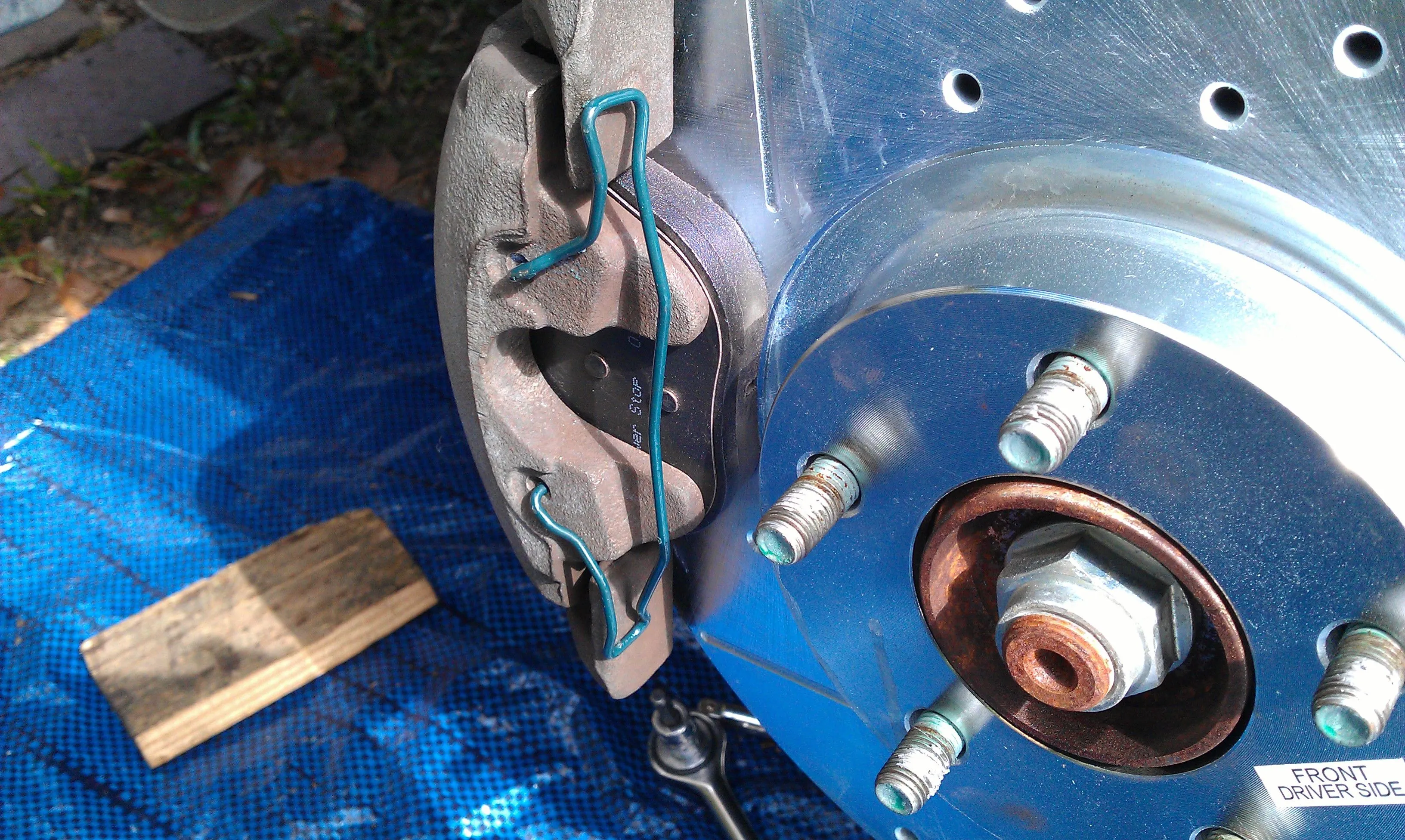

Brakes were a simple affair. I purchased a IMAG0002.webpPowerstop kit from Rockauto (Ceramic pads and drilled/slotted rotors). Yes I know about drilled/slotted rotors on the street, but was a good deal. When I teach HPDE's or Decisive Driving, if I use the car, I can change pads quickly. The old rotors do need to be hammered to take them off. I sprayed Sea Foam lubricant on the hub and lugs then used a block of wood and a hammer and off they came with little effort. Everything fit well except the caliper spring retainer IMAG1222.webp on the driver side. It didn't fit as securely as the stock one. Curiously, the passenger side one fit fine, however, I reused the stock ones. Here's what the old pads looked like: IMAG0015.webp
Pads are bedded in and everything feels good. Oh yeah. These are the original pads and rotors. The car is a 2010, bought new, now has 65, XXX miles on it.

This is kinda weird. It's almost a year ago when I started this thread, and I just now today got around to replacing the bushings. Did brakes as well. First: Bushings. Yes. They are a pain in the rear to change. I was able to do it without loosening the subframe (I just didn't want to bother with all that - that's my reason and I'm stickin' to it!!). I got the vehicle up and sitting on jackstands then took several minutes looking at my options and decided to go for it. For me (and I must emphasize that this is what worked for me), I worked from underneath, behind the subframe, with one hand behind and one hand in front of the subframe and worked by feel. Since I knew what it looked like, it wasn't difficult. Loosened the bolts (14 socket with a small extension for the front bolt), raised the bar with a jack a little to remove and replace the bushing, lower the bar, locate and replace the bolts. The driver's side is little harder because the power steering lines are in the way, but same method applies. From start to finish, the bushings took about an hour or so. These are the old ones View attachment 204614. I purchased the new ones from the dealer ( I didn't want to deal with lubrication and zerk fittings etc. I'm lazy) so they are just like the ones in Post #34.
Brakes were a simple affair. I purchased a View attachment 204615Powerstop kit from Rockauto (Ceramic pads and drilled/slotted rotors). Yes I know about drilled/slotted rotors on the street, but was a good deal. When I teach HPDE's or Decisive Driving, if I use the car, I can change pads quickly. The old rotors do need to be hammered to take them off. I sprayed Sea Foam lubricant on the hub and lugs then used a block of wood and a hammer and off they came with little effort. Everything fit well except the caliper spring retainer View attachment 204616 on the driver side. It didn't fit as securely as the stock one. Curiously, the passenger side one fit fine, however, I reused the stock ones. Here's what the old pads looked like: View attachment 204617

It's been a week today since I installed the bushings and brakes. All is well. Clunking is gone and the response to steering inputs is back. It feels good. Maybe next time I WILL upgrade to poly bushings! The brakes are great as well. Takes a little getting used to. They are not grabby (and I'm not a heavy braker as it is) but they slow the car down a little faster than the stocks did new. The only thing I have left to investigate is a potential bearing noise... just not sure about it yet, or which end of the car it's on, but my ears are telling me it's the right rear... I may just go ahead and change them both for peace of mind. Time for a little more research!

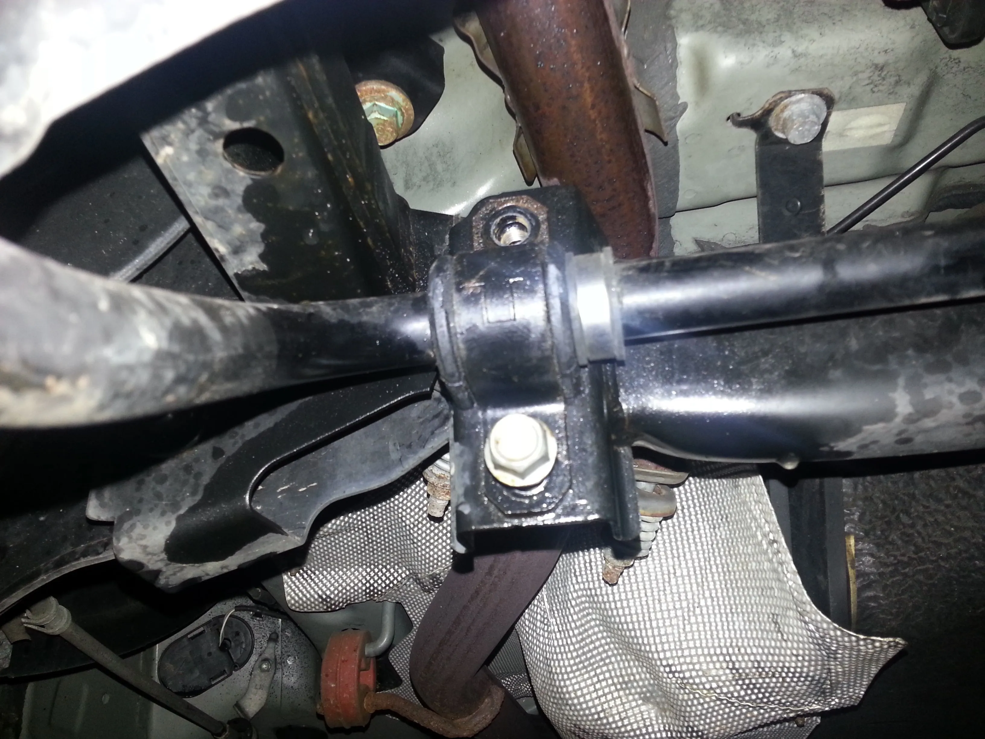

No pics. There was no room! Basically it sits on top of the sub-frame. The sub frame roughly where the footwells are located. Two bolts hold the bushing retainer on either side (fore/aft). Unless the bushings are shot completely you'll have to raise the bar a little to remove and replace the bushings. I used my jack under the bottom of the strut to lift the wheel assembly.

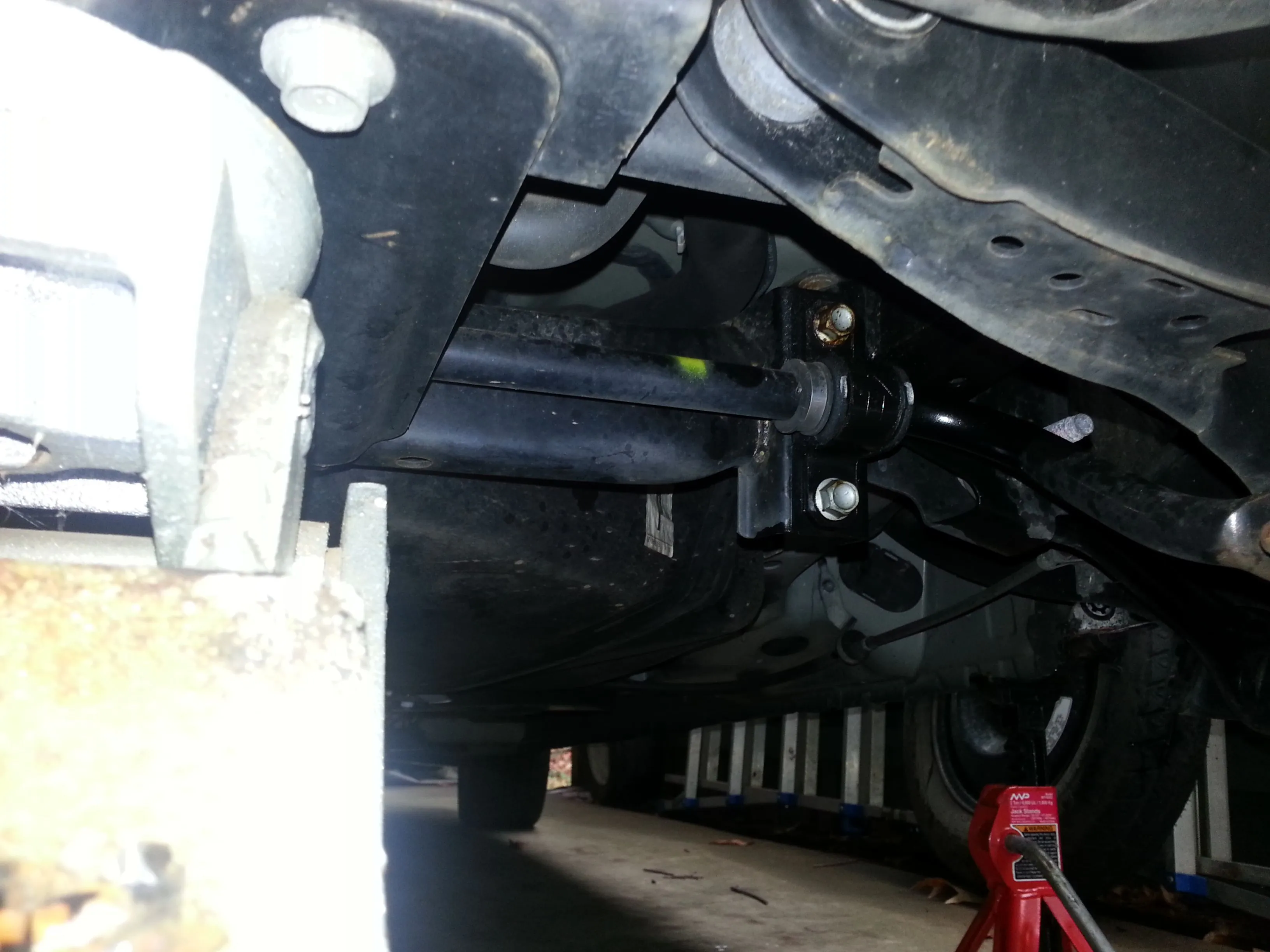

Long time lurker, first time poster. Front Bushings is a bit of a PITA but do-able. Definitely have a 14 MM wrench to take off both sides of the sway bay (2010 has a 5 MM Hex despite previous posters saying 6 MM but I didn't need it). The passenger side isn't too bad, but the drivers side is really tough to get at so you'll want to disconnect the sway bar for wiggle room. My front bushings actually looked in pretty good condition and at 43 K I was surprised to have to replace them. But, the new Moogs reduced 85% of the noise. I just replaced the rear shocks and bushings a week later to get things completely quiet. All in all, not a bad job for a shade tree mechanic who has jack stands and basic tools. I'll post pics of the rear bushings since nobody else seems to have done that, but basic at best to do.

Followed the post by these guys and was able to tackle the job. I'll add something that made it a little easier for me...Other than the use of a combinatin of U-joint socket and extension, I used an open end wrench on the rear bolt to help loosen and tighten the bolt a lot easier. Test drove it right after I replaced the bushings, and I was pleased that the clunking sound was gone. And yes it feels like a new car without the annoying clunky noise. Attached pic shows the new bushing (left), next to the old one (right). Notice the new design; cut out on the side, thicker piping with extra waxy surface, also the new bushing feels more tougher and rigid than the old one that I pulled out which was very flimsy and soft. No wonder the FSB was making contact with cross member, the old bushing was too weak to hold down the FSB...
