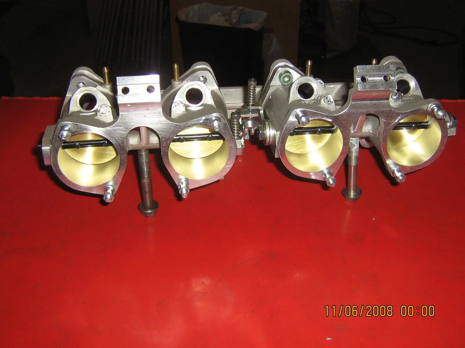

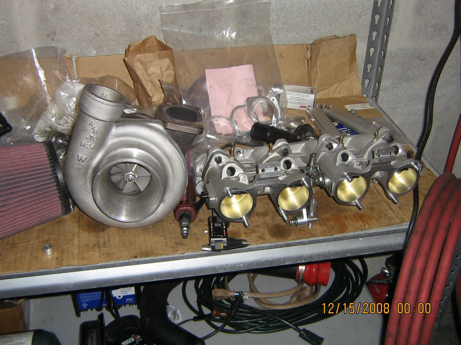

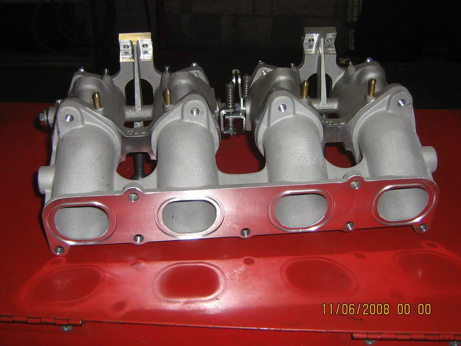

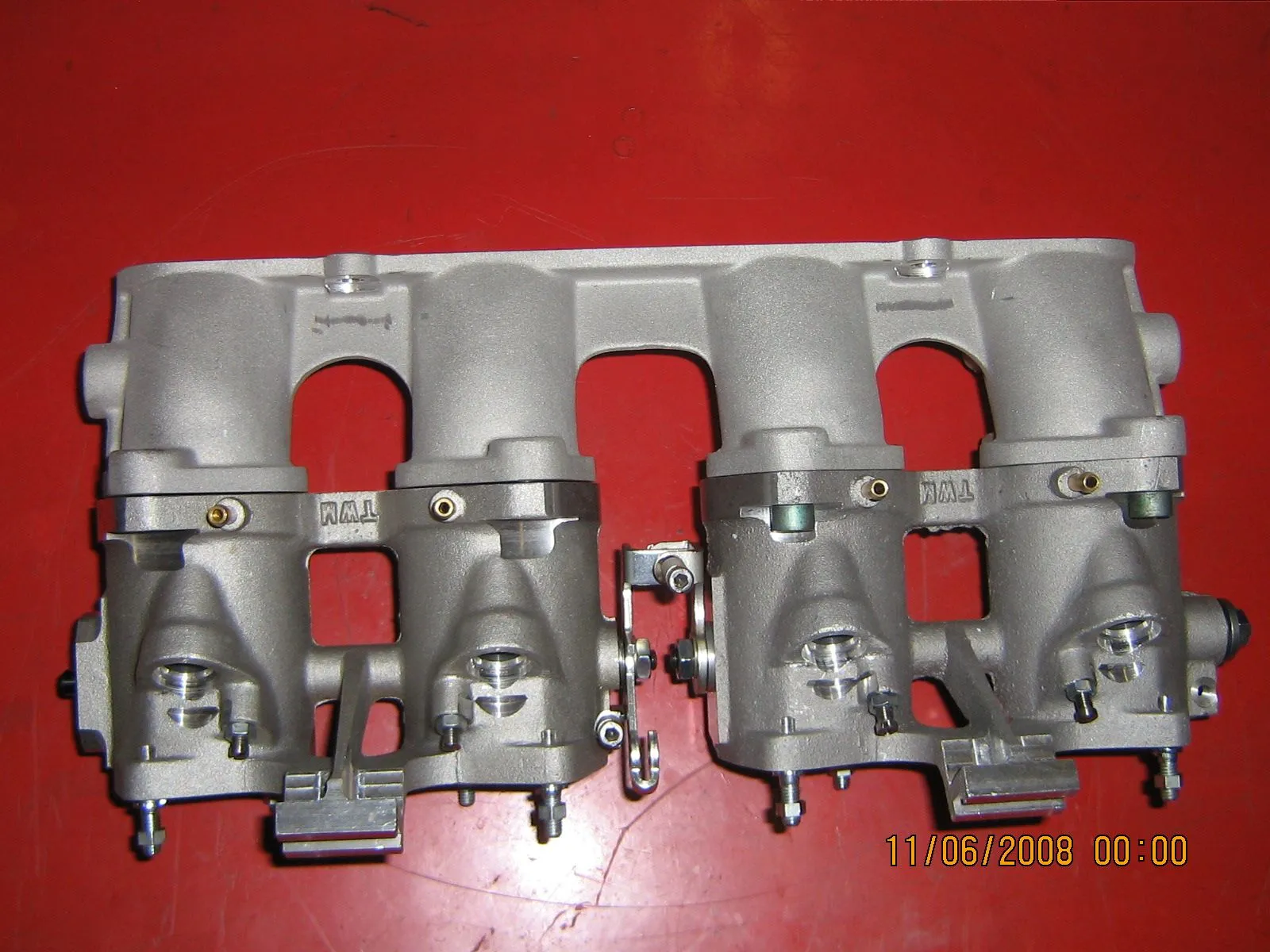

Please see pics of the individual throttle bodies and intake manifold. We also have a built head on the way with bigger valves, stiffer springs and ported & polish.

More pics of individual throttle body
More pics of the individual throttle body and manifold
wow that piece looks like if it were a stock part. I wonder how many peopole would buy these if they were sold in mass quantities. Any idea on price for those?
Response
Good stuff Alfredo, I am going to check with Manuel on the price.
I know the intake portion came from Cosworth but I am not sure where the individual throttle bodies came.
I am hoping to have pics of the builted head and the regrinded cams once they are completed

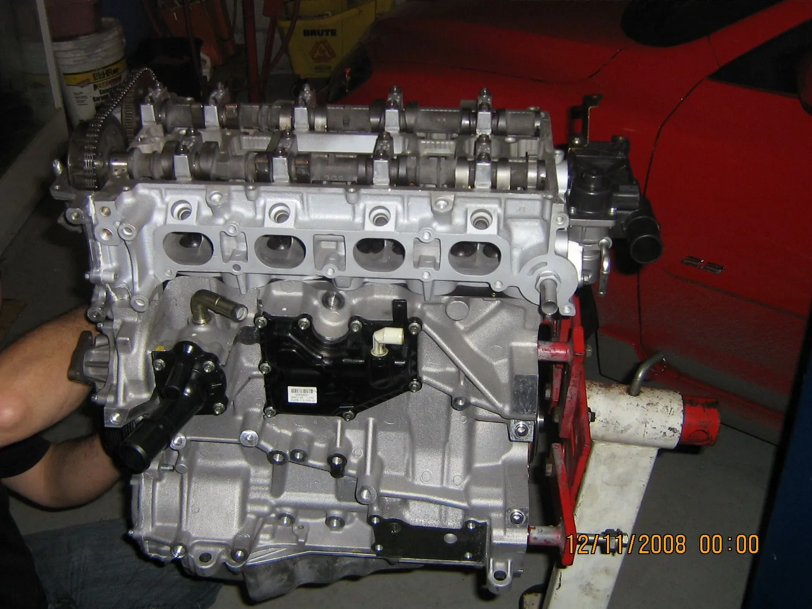

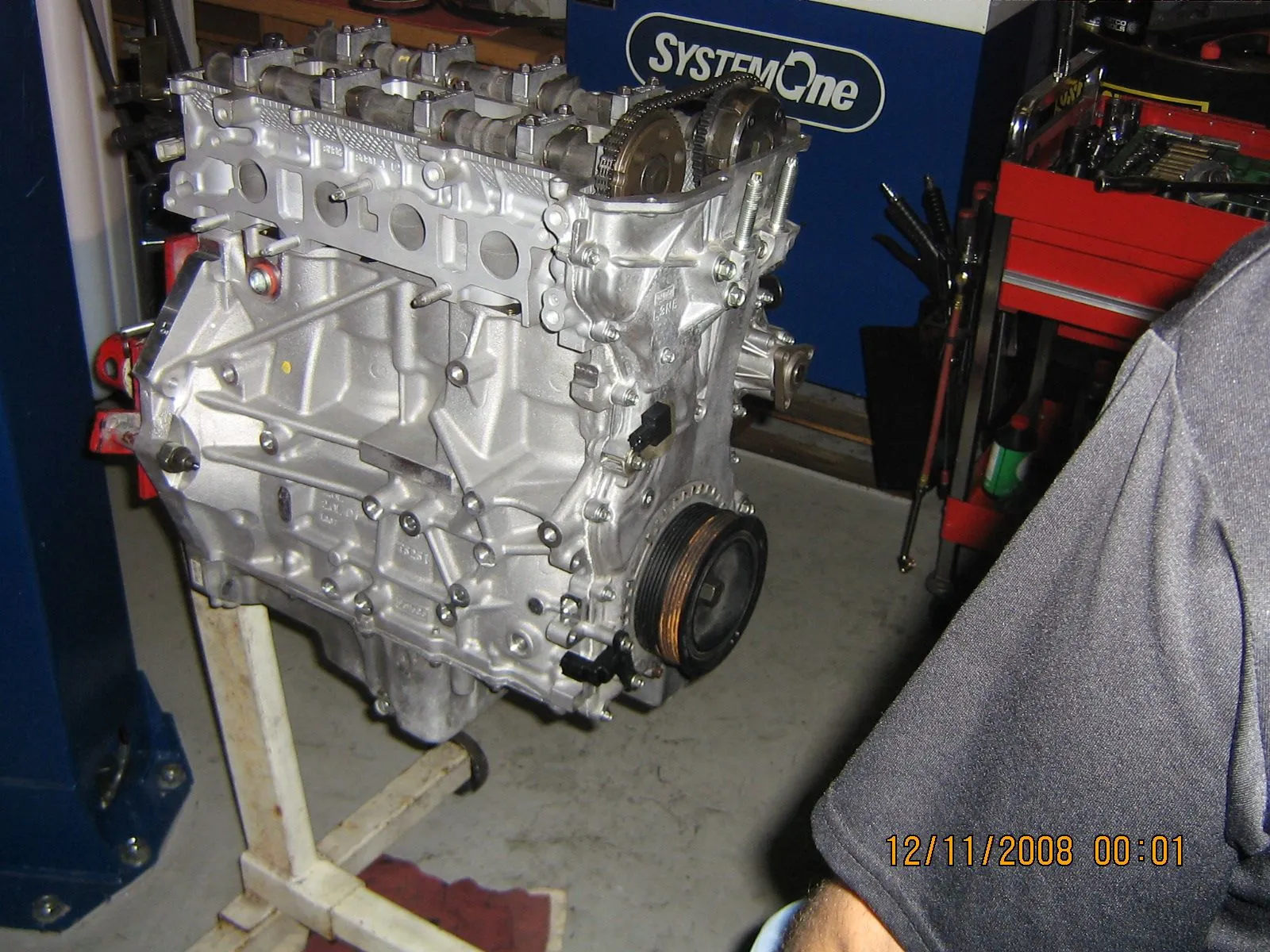

It has been awhile but the quest for big power continues. Please see the pics below of the big engine being put together.
We have ran out of time and willnot be able to go back to the track to test the car before HIN but should have dyno numbers for the big engine by then.

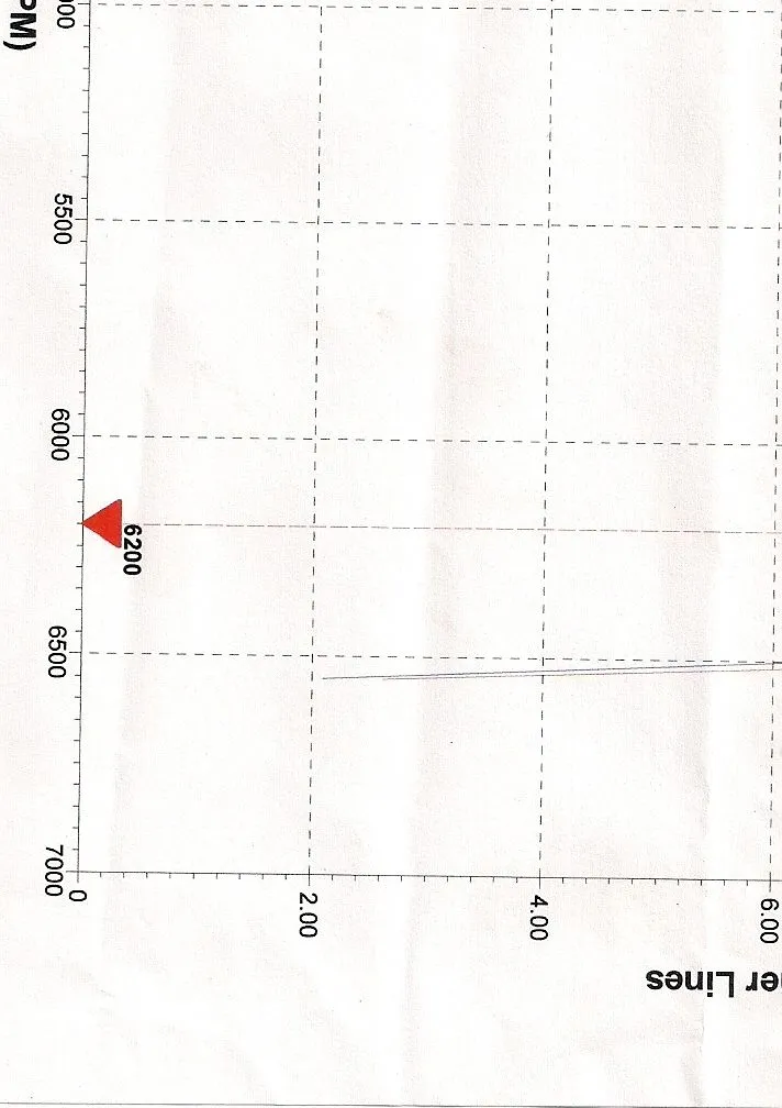

We had a fuel problem which was prevented us from boosting more than 18psi at the Nopi on 4/18 with the GT35R turbo. The fuel problem was solved, the car was retuned for higher boost and we went to the dyno recently.
Unfortunately, it was a dynomite dyno not Dynojet like we are used to. Please see the 494 whp @ 25 psi slip below. We were disappointed and did not even ask for the next run which was 501 whp @ 27 psi. We did the caluclations later and realized that on a dynojet, the 501 would have been about 525 whp

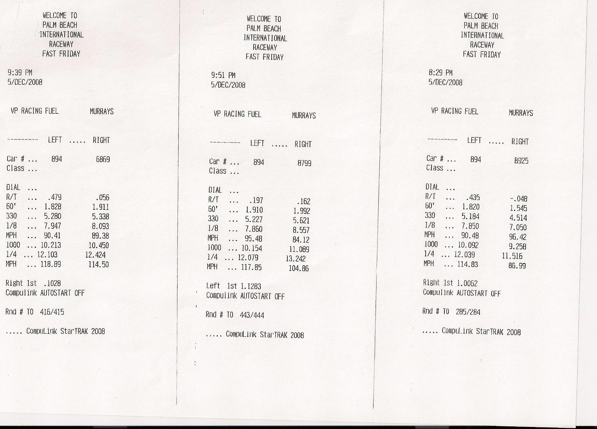

We went to the tracks on 12/5 to blow some stem since we had not been to Moroso since it was close for renovation. We realized in hind site now that we were unprepared.
As you can see in the video the rear was loose (we need to adjust the rear shock + install the bigger rear sway bar) and the runs were made with too much boost between 28-34 psi. The car was spining tires through almost every gear, too much boost.
Once we start testing the big engine, we are going to have to go low boost and slowly raise the psi till the tires start spining. We are going have to go with wider tires also.

Link to dyno sheet
http://s415.photobucket.com/albums/pp235/supermazda3/?action=view&current=scan0001.jpg

Manuel working on the big boy

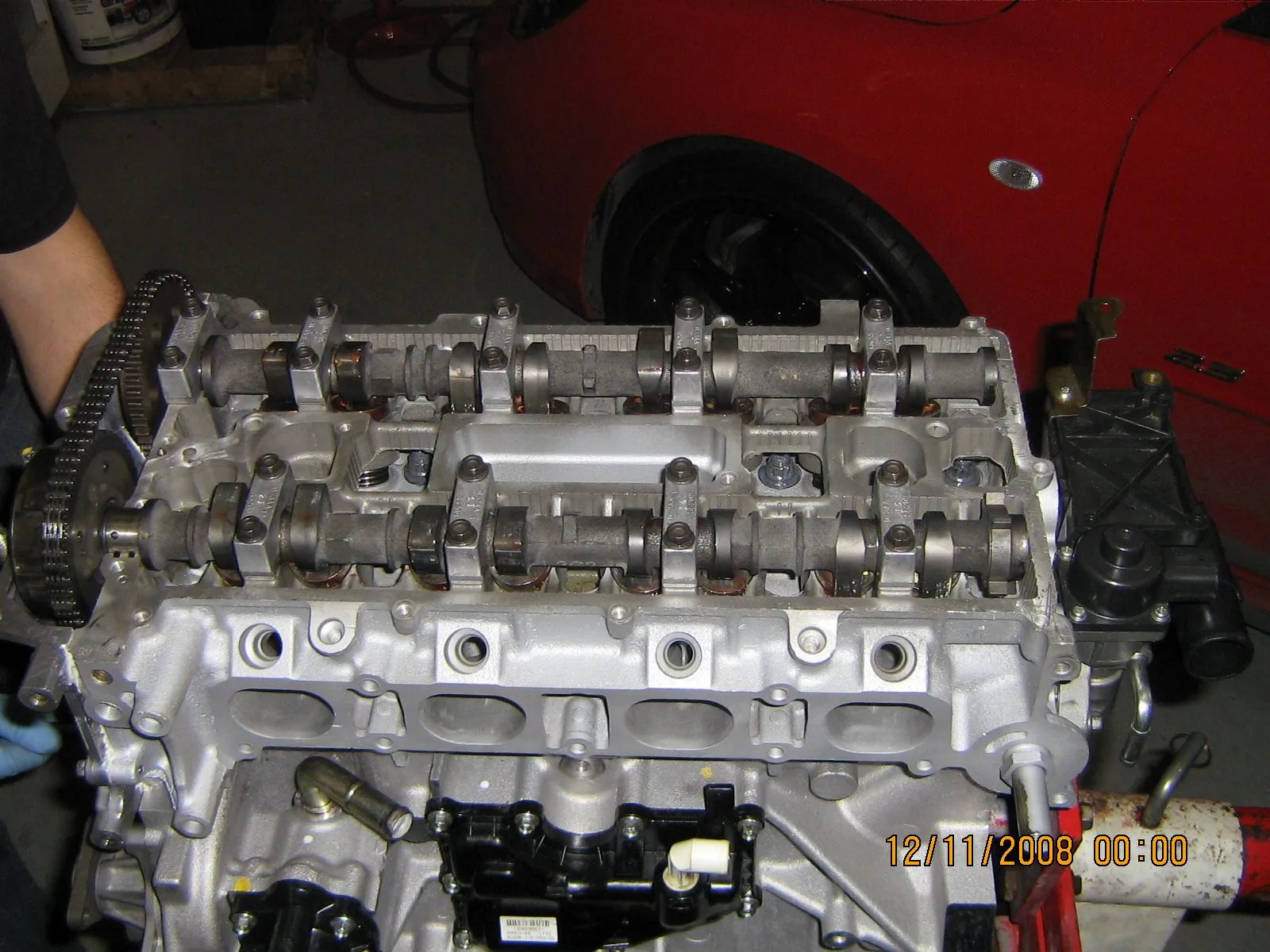

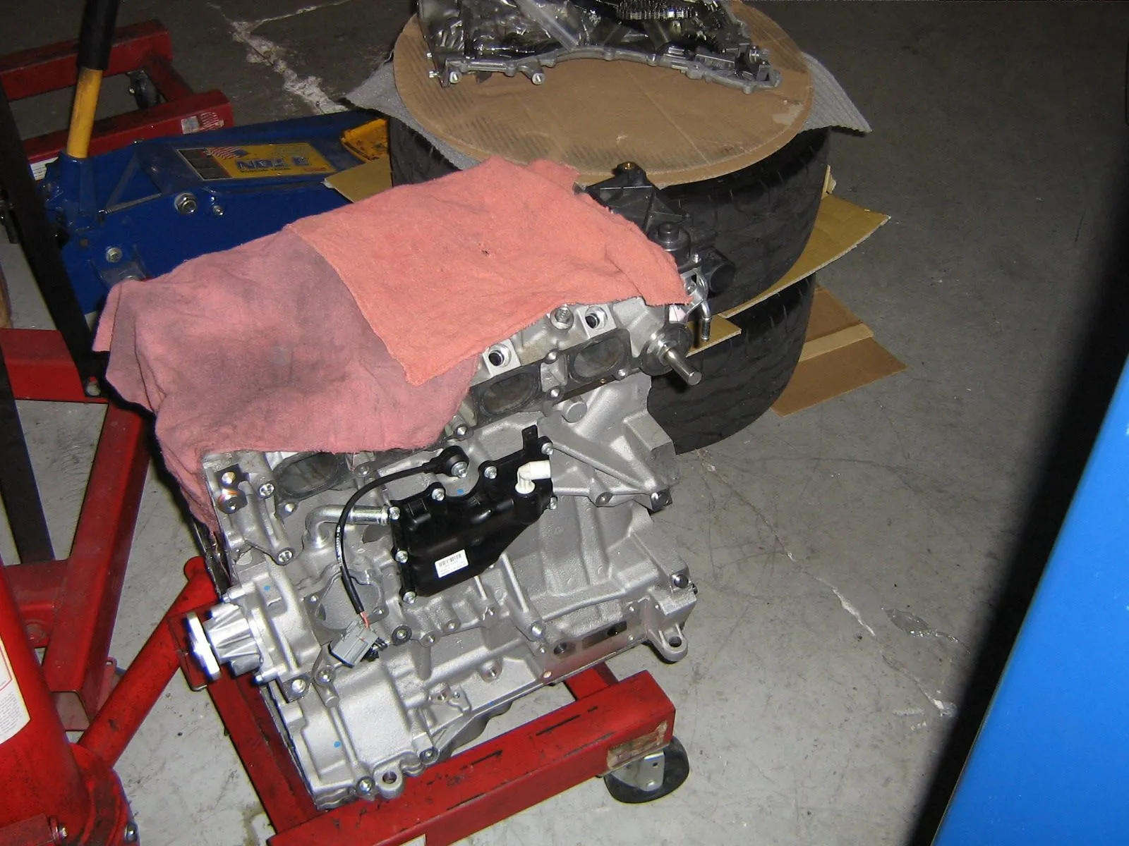

I forgot the pics of the big engine being worked on.

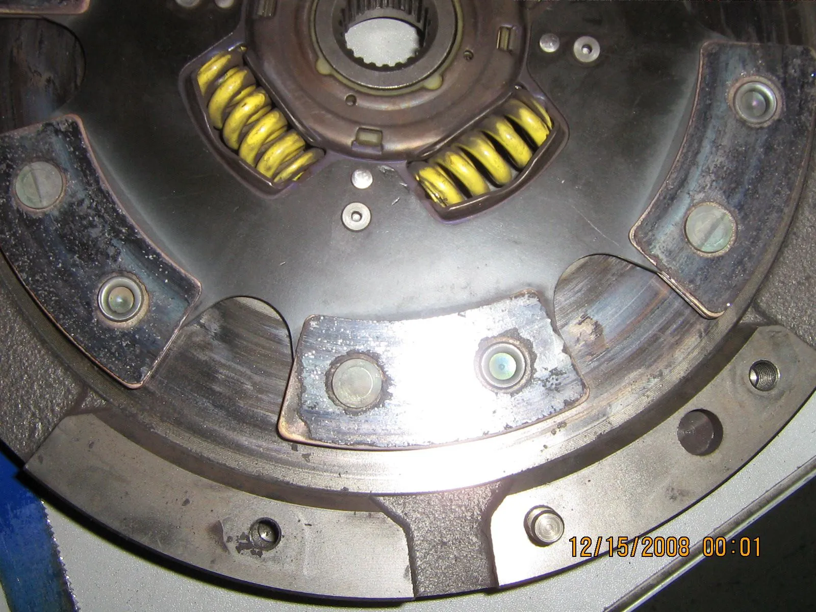

Good post Owen...I still have yet to see you again in such a long time. The only bad thing about the post is that you should've gotten shots of the engine without the head to show the sleeves that would've been better. But good nonetheless....also wanted to add that in those videos the clutch was slipping. You can hear it clear as day in 4th gear on the second video. Even someone says it in Spanish lol. Thanks for the update!
Car sounds amazing, I wish that I could have gone to the track that night to check it out. It definitely needs some wider slicks though. A 525whp car should trap much higher than 118mph, it looks like your were spinning in every gear.

We found the cause of the problem of the car slipping gears, the clutch is burnt.
Hoping to have the car ready for dyno on Thursday but still got a lot of work to go.

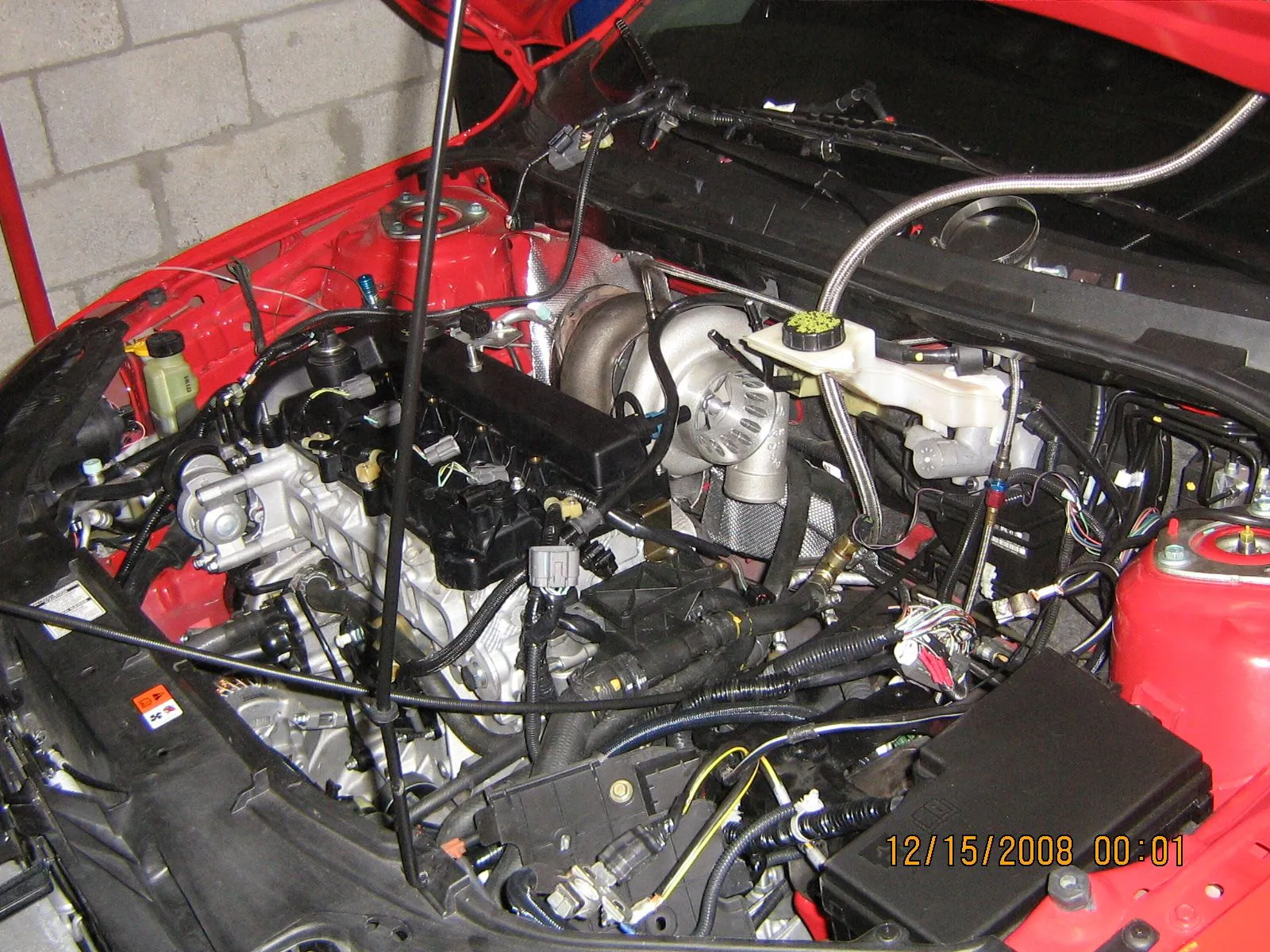

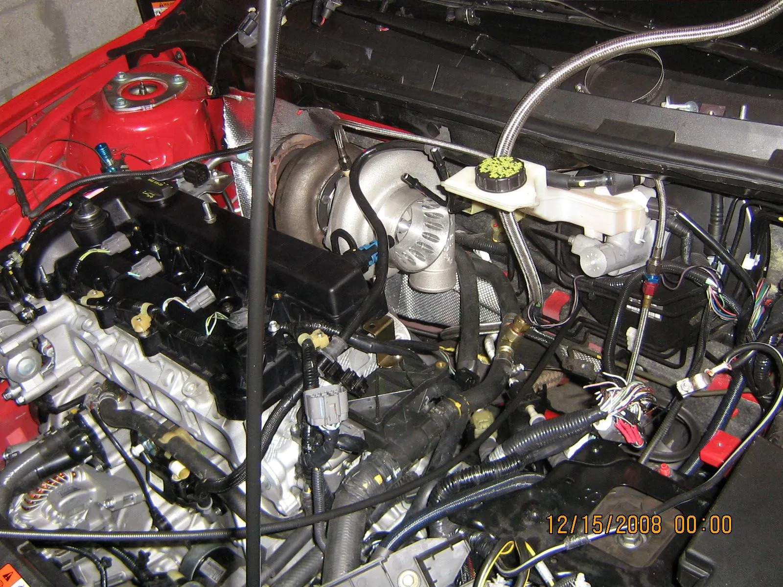

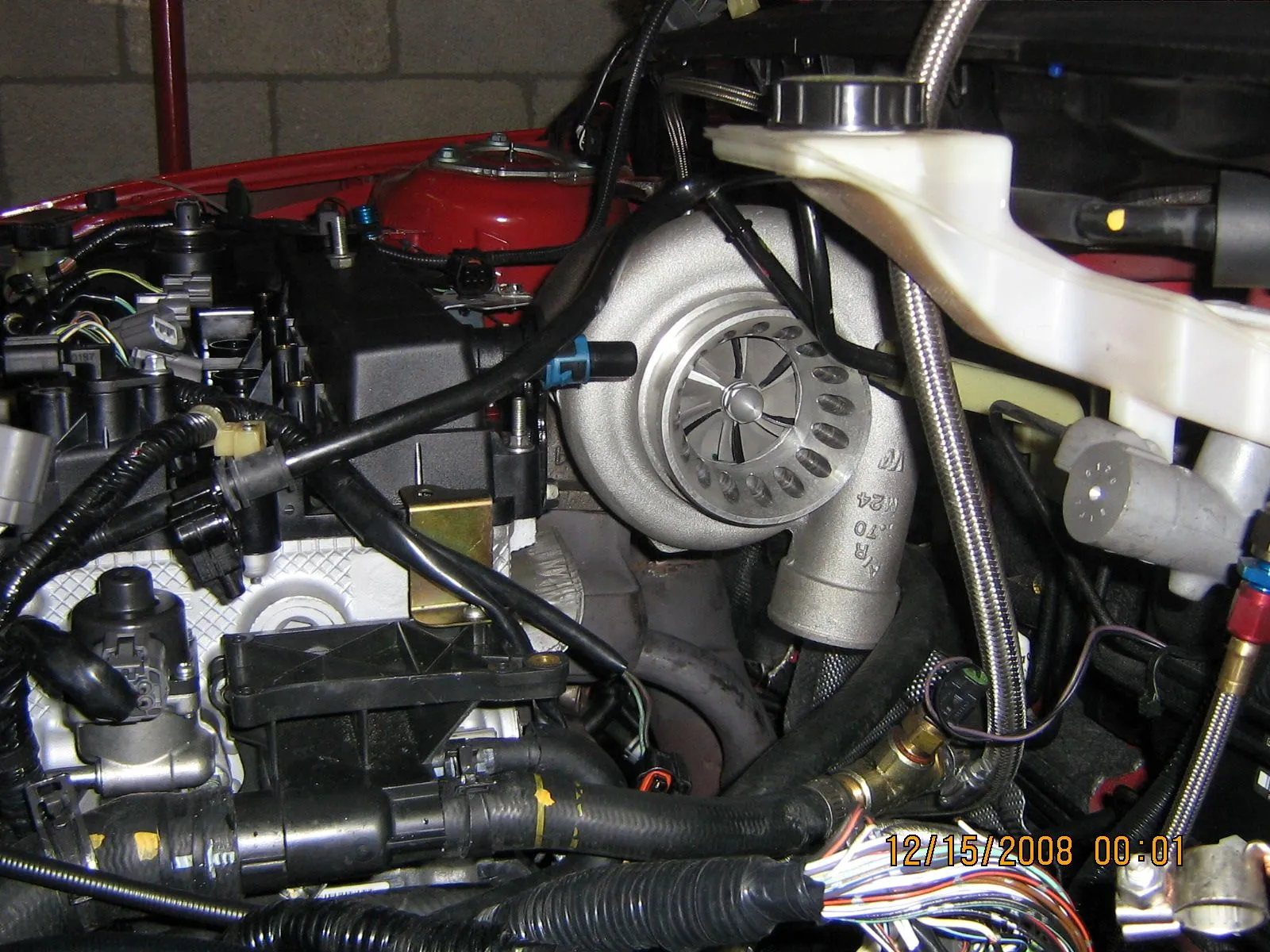

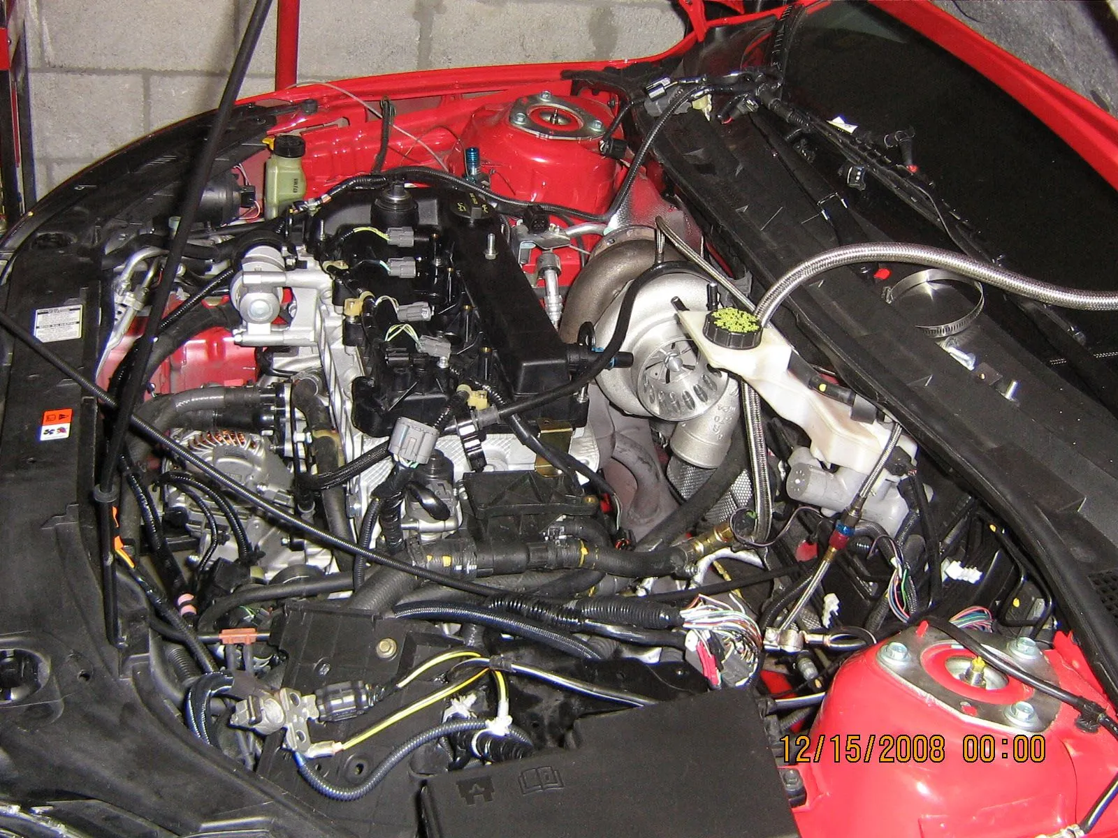

Old turbo and engine out, big turbo and engine in.

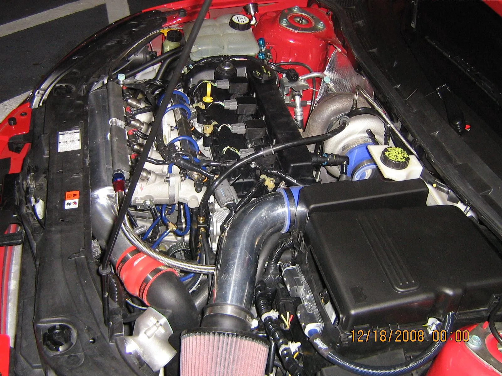

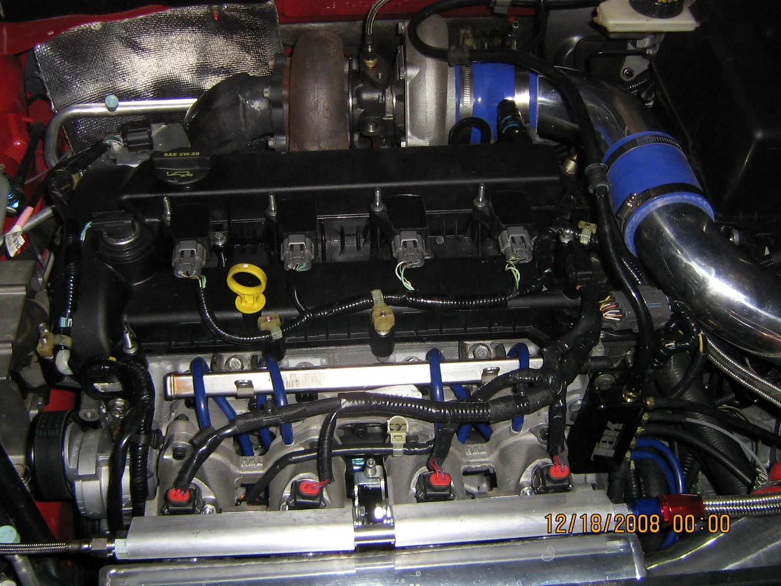

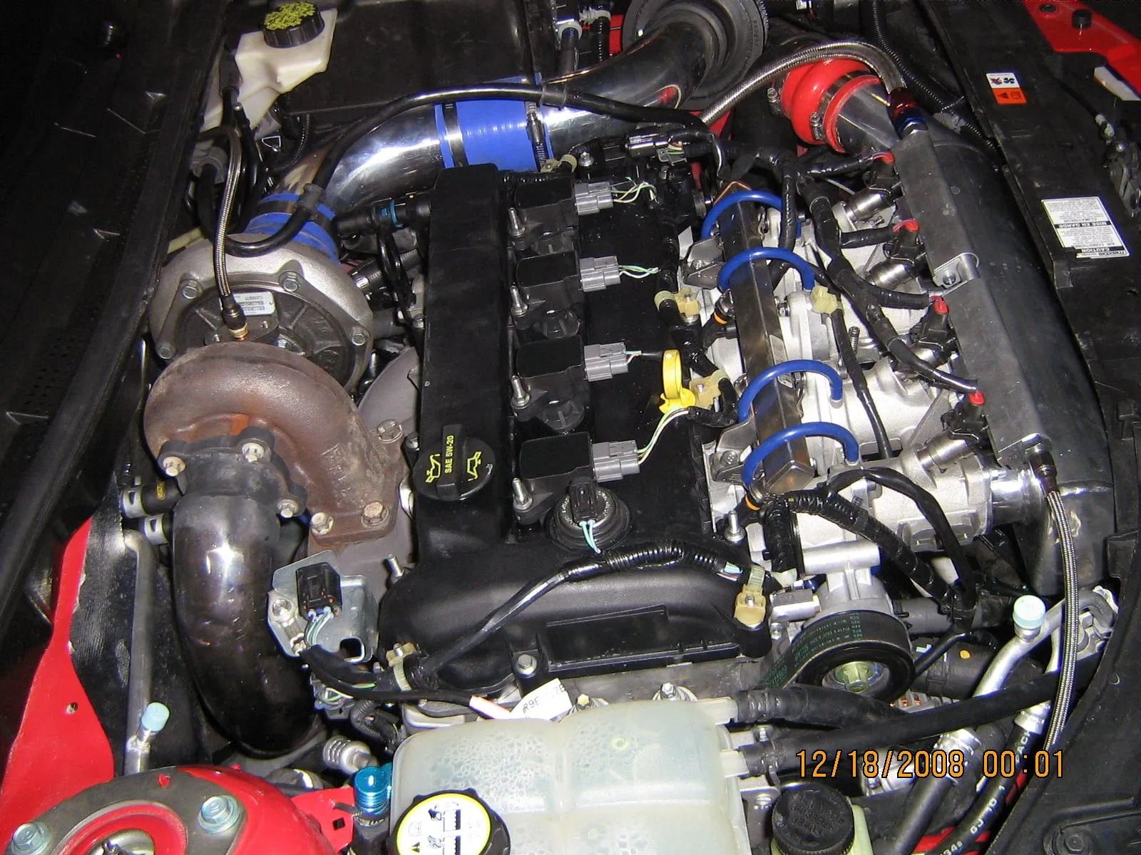

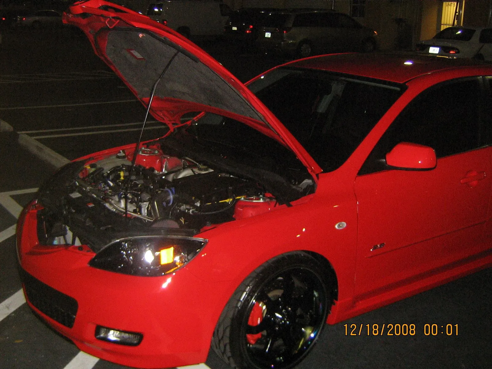

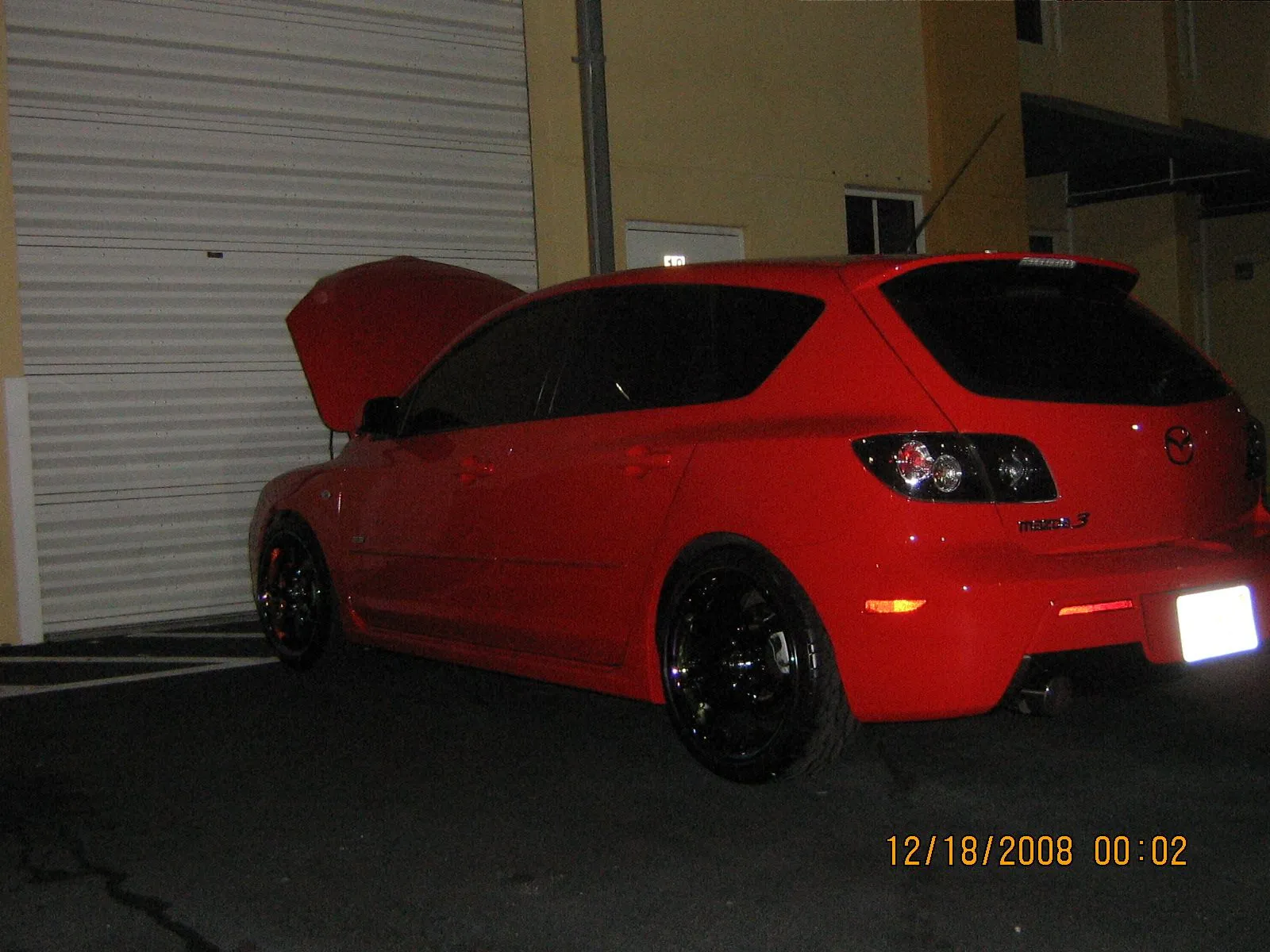

The cars are almost ready for Hot Import Nights 12-20-08
By God's grace and mercy and staying till midnight the entire week, both cars are almost ready for Hot Import Nights (HIN) 12/20/08.
We just need to put the fuse in the sound system for Supermazda3 and install the oil pressure gauge. We need to put seats back in Superprotege along with a thorough cleaning.
We went to the dyno late last night but did not get the numbers we were looking for, the car needs alot more tunning and we ran out of time.
