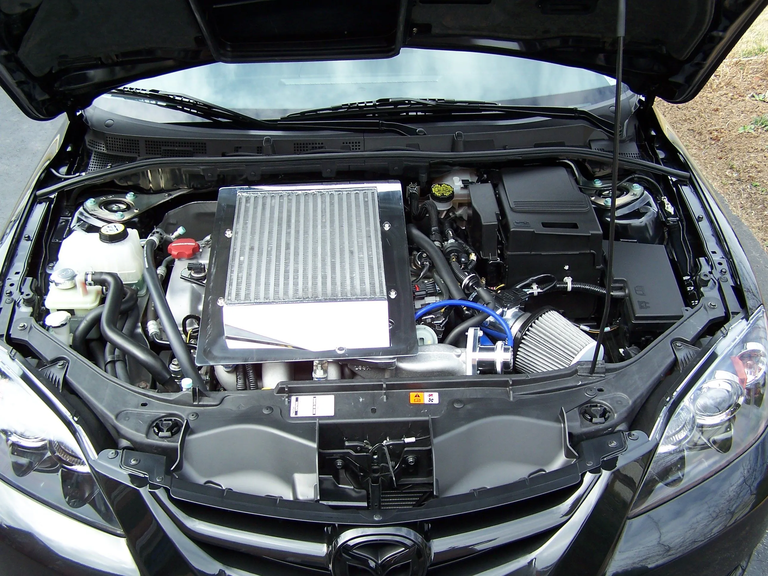

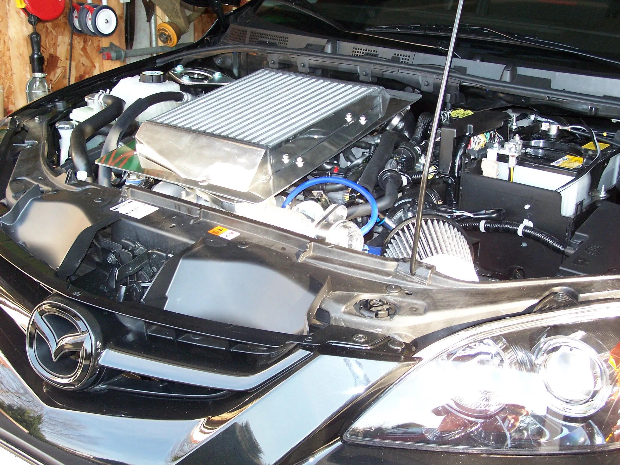

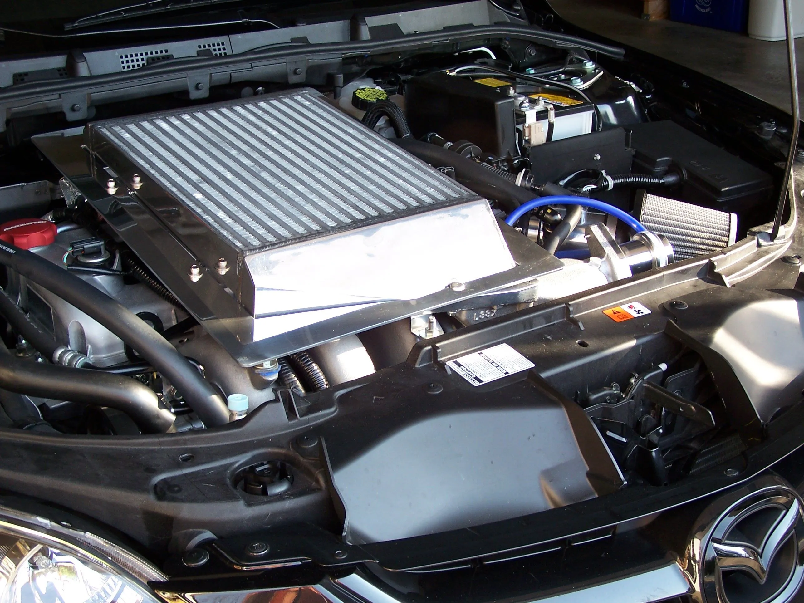

My neighbor and I installed my new SU TMIC today. It looks sharp, and is a sweet addition to my engine bay. Anyone looking for a top mount should consider the SU.

It looks good!
Did you noticed an improvement?

I think the engine bay looks are much improved
The engine bay looks very nice and clean. I have a hard time doing that here in the North East. Too much sand and salt on the roads and I only drive it once per week during the Winter Months.
Does the SU TMC come in that finish or is that an upgrade?

so all in all does it feel like your pulling harder at higher rpm's cause im looking into getting su tmic also soon . i have read dino's saying it adds 20 wheel horsepower and 20lbs of torque and people saying its always cold to the touch.. does it feel that way or no? if not i would rather spend my money on the cobb computer than this if it didnt perform as good as some say it does.
It seems to hold boost better, and shifting at speed seemed to be a lot smoother.
I think the engine bay looks are much improved. lol
So does the butt dyno feel like about 20 hp /20 tq??
I know it removes the restriction that is the stock ic. That should be good for some noticible improvement even without taking into effect the cooling factor.

Looks nice, I've been really please with mine... although the front right mount broke.
Looks like you re-used the stock boost tubes, if you decide to swap them you should consider the OBX tubes over the SU tubes, they are thicker and not as subject to the back one collapsing I found.

To me it feels like its pulling harder, especially in the higher gears. I honestly can't tell you if its 20hp or not, but it feels like more hp than stock.
I mostly wanted to add a little bling to the engine bay, and in my opinion, I accomplished that. I satisfied with the results, both looks and power.
If you are primarily interested in hp, you may want to save up a few more dollars and get the front mount.
"Looks like you re-used the stock boost tubes, if you decide to swap them you should consider the OBX tubes over the SU tubes, they are thicker and not as subject to the back one collapsing I found."
I did reuse the stock tubes, the back tube was a real bear, but with my neighbor's help, we got it in.
I'll look at the OBX, but I'm not in the mood to change the stockers after fighting that back one.
Yeah, the OBX tube is too long and requires a bit of test, remove, cut... test, remove, cut... on the bright side, I'm a pro at it now!!
