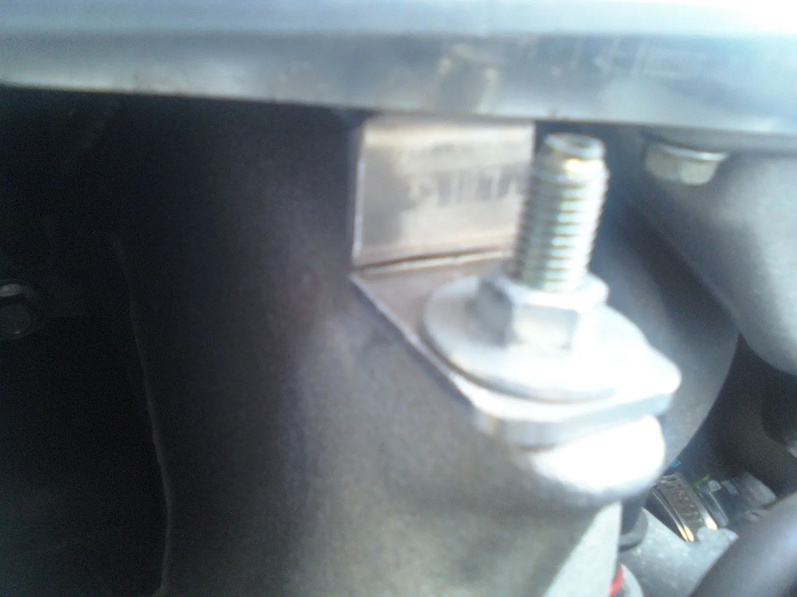

SU TMIC Installed.
here is a picture of the one broken tab on the front of the intercooler. the rear one has a hair line crack that i couldnt get a good pic of

The quality of the core / welds is great. The rear hot tube doesn't fit all that well but neither does the ETS. The only problem really is that the angles that the brackets are welded. They are slightly off which caused them all to break. The core was made by a reputable company. . . not SU.
well i spoke with mark today and he is sending me a new intercooler with reinforced tabs until this new prototype comes out so i dont have to go back to stock...i will have it friday which is nice so i can install it again over the weekend...

not sure if this has been stated before but if you take your rubber grommets and put them under the tabs, they are less likely to break. That is what i did before i returned it for a cobb fmic.
I went to home depot and got some rubber gromets because I knew metal to metal was a recipe for disaster. Had triple rubber washers on each bracket and they still broke . . .
