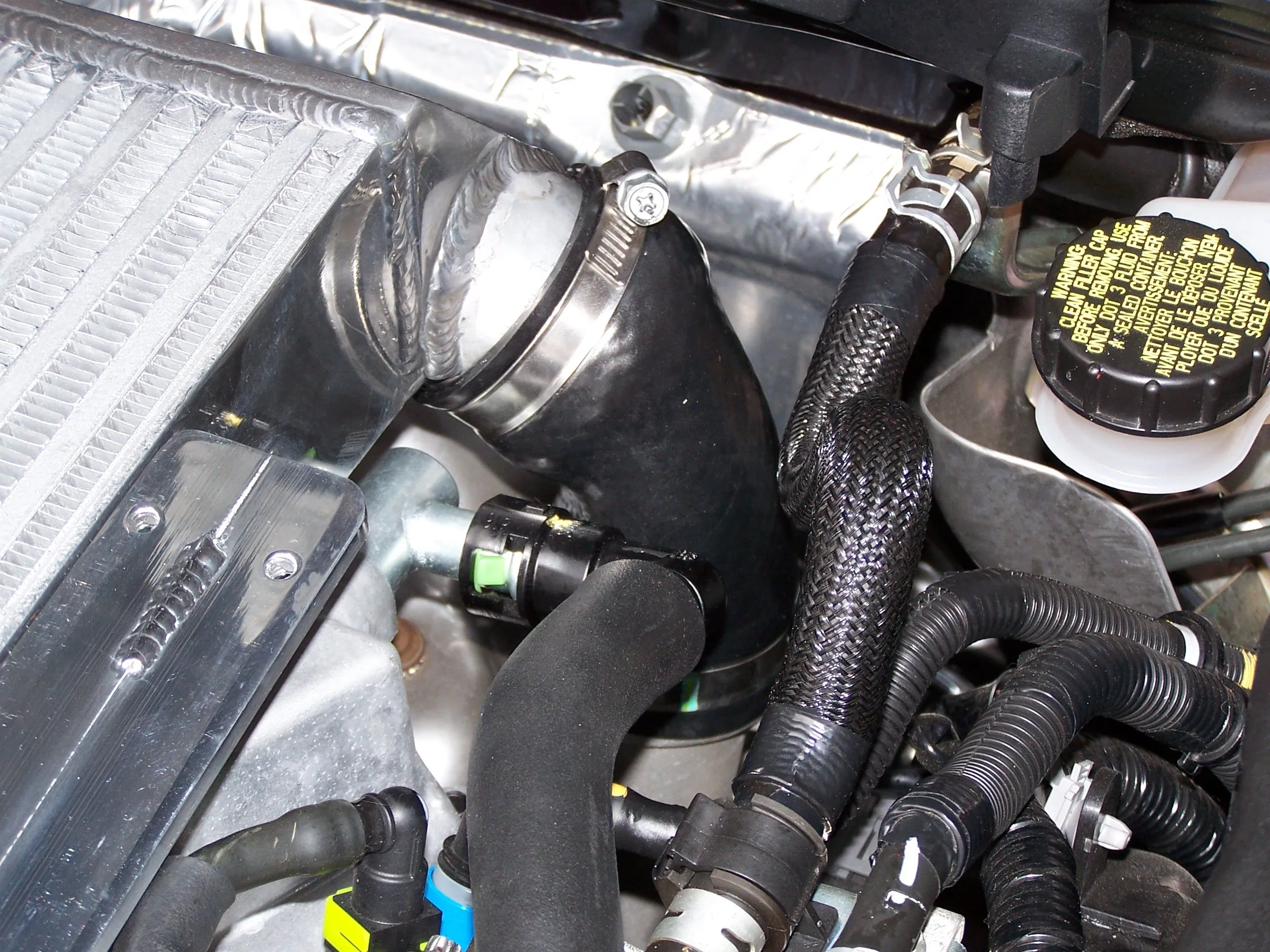

Here's a picture of the stock tube that I reused. I wish I had ordered the SU Boost Tubes along with the SU TMIC. The stocker seems a bit stretched, but so far it's working. I'll eventually get around to installing new tubes and maybe the polished cold pipe. That would make the engine bay look better.
It looks like only the hot pipe is getting kinked. I guess the tubes are longer so they don't kink? The cold pipe should not have to be changed because it is attached to the stock aluminum cold pipe in the same location.

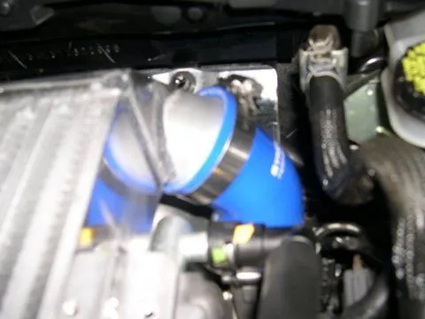

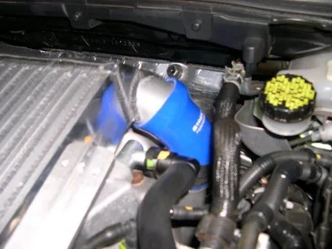

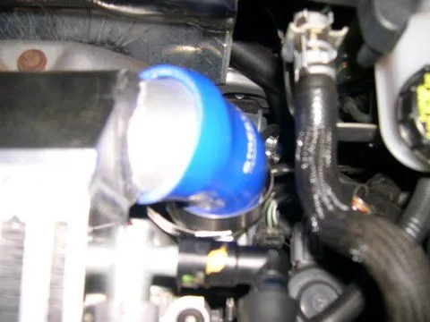

Here's the pictures you asked for Papa, as you can see, it appears that the boost tube is a little too short due to the angle of the aftermarket IC. I think the issue could be resovled simply by making the bottom half of the tube longer - I don't know if this makes sense to you guys. I don't have any kinking lower down, but as you can see, the top of the tube doesn't look very secure and the clamp is a tad bit precarious. I don't have any leaks, but I'd prefer a better fitting tube anyway.

Yeah, the SU tube looks like it fits similar to the stocker, which makes sense.
I think as long as you have that clamp past that ridge on the pipe, and its real darn tight, it will be ok. It's just the looks of it.
We just need a tube with better fitment.
