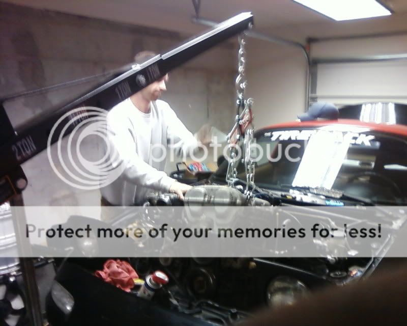

We swapped the engine out and the new one in within about 4 hours. We've run into a couple snags. We were getting a weird noise coming from the front / head area. Looks like SOMEONE forgot to tighten the timing belt tensioner pulleys 0.o (I'm an idiot), so I'm pulling the front covers and what not off to do that. Pics to come later
FINALLY! Out with the old and crusty:
And in with the new hotness:

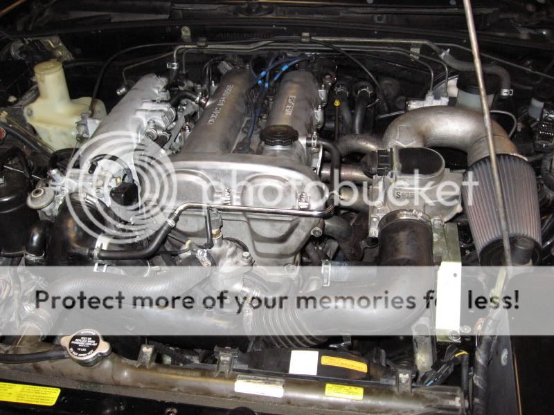

To borrow a quote from kevin: Simply insert part A into slot B:
And you're done! We ran into a couple snags like not tightening the idler pulleys and then the water pump pulley, forgetting to put on the lower radiator hose before filling it with fluid, and had trouble setting the timing, but we finally got everything set. We cranked it 'dry' (no fuel or spark) to build up oil pressure. Once it did we hooked plugged in the coil packs and the injector harness and it literally fired right up!! I was thrilled. It was actually kind of fun working the kinks out with the new engine. Hopefully I can get a good break in done tomorrow and go from there. I'm excited :D

Yeah, the noise went away then came right back b/c of the water pump LOL. Tightened both tensioners and checked to make sure the timing was right (Cyl #1 @ TDC, reference timing marks) and it was, then put the covers back on. Well, I put the water pump pulley on and hand tightened the bolts. The plan was put the belt on the Alt and get it tensioned, THEN tighten the WP bolts. Well, step #2 was sort of forgotten LOL.
As far as the timing, we figured out that for some reason the reference on the pulley's not in the right place. When #1 is @ TDC, the mark is out passed the "long" protrusion from the timing mark cover. We made a couple phone calls and, since it's all "relative", pulled the accessory pulley, put a mark we could see where it would line up with the T on the timing marks, and used that as a reference to do the timing. Runs fine, it's set to 10* (well, 11) for the time being.

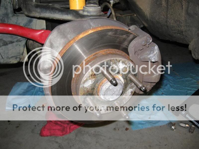

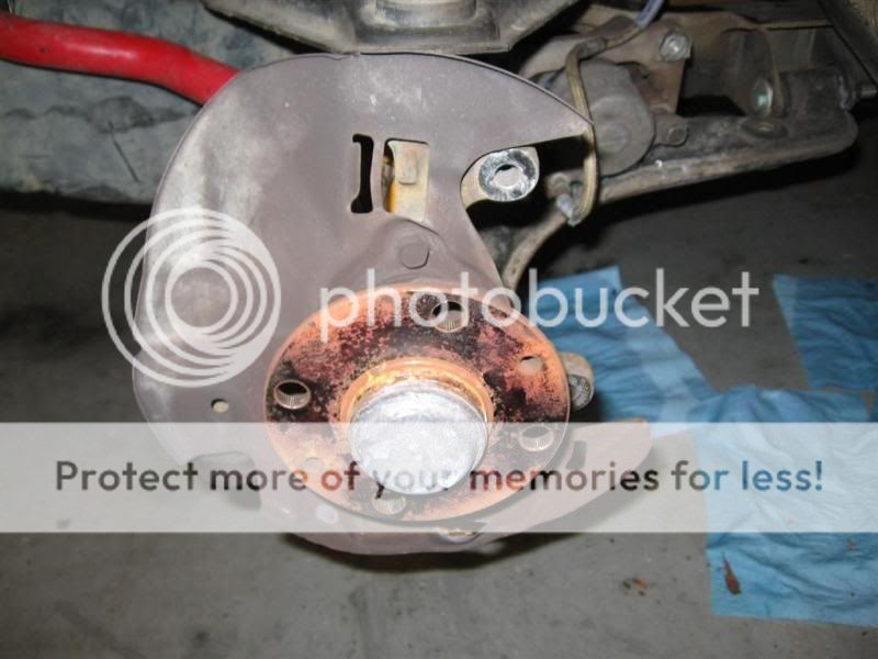

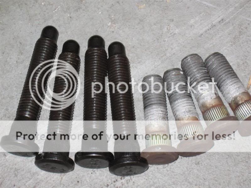

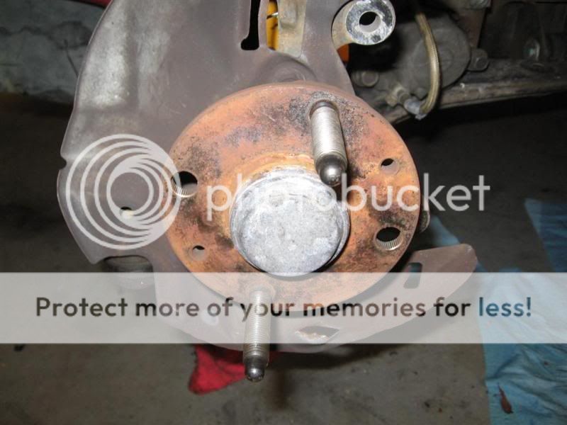

Anyway while it was up on jackstands I went ahead and started on another project I've been putting off for far too long and did the front wheel studs. The rears will be done... uh... eventually lol
Here's what we started with:
Knocked the old studs out:
New vs. Old

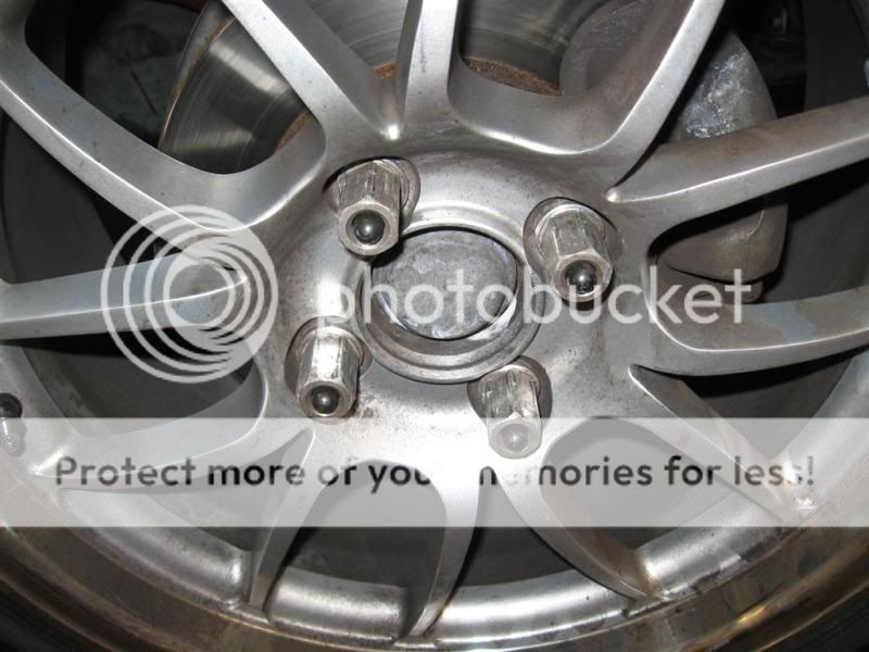

Starting to put them in:
1 corner done:
Wheel on:
It's a lot easier to work with the wheels now. And oh yeah: They're kinda pimp ;)

Also, I went to replace the rear wheel studs and there really isn't a way to do it without disassembling the hubs. Which sucks because that's another pain in the ass I didn't want to have to deal with. Bah.
