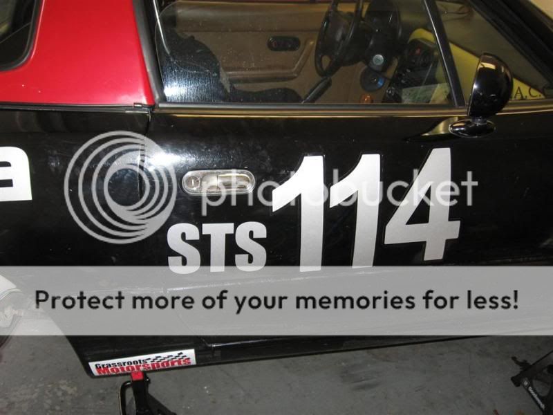

it's pretty naked right now. Mazdaspeed, Bridgestone and SCCA stickers will be going on for contingency at the National Tour this weekend:
