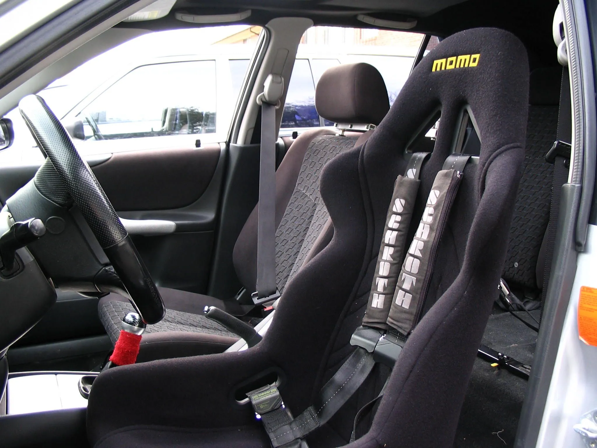

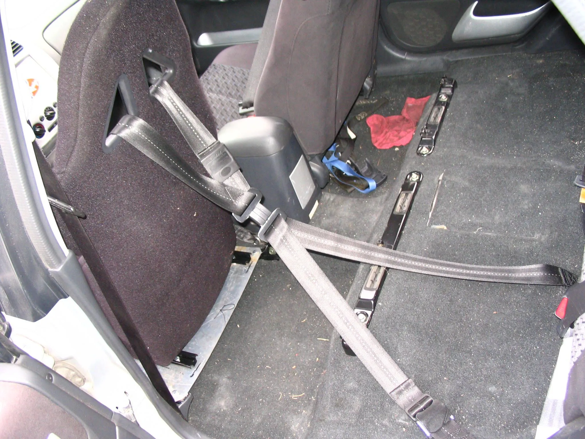

I finally snapped some shots of the Momo Start seat in the car. I'm not 100% happy with the way it is mounted so I'm going to be testing a new method when I mount the passenger seat and if it works better I'm going to redo the driver's side the same way. Right now the seat sits just a hair to straight. I need a little more slope to the back since I have long arms.

What's that white "pad" thing under the seat??
EDIT: Are u gonna put a harness on the passenger seat too? Where'd u get urs from?
Nice! How much lighter are those compared to stock? I'm interested to see what how the comfort compares to stock too (you daily drive it, don't you?). The harness is hot too... I need to order mine sometime.
It's a 1/4" sheet of aluminum. I took a look at the stock brackets and I think I've found a better way to mount it.
The Momo seat weighs 15lbs. I didn't weigh it with the mounting brackets, but I can tell you that it is at least half the weight of the stock seat. I'll be a little more exact with those #'s when I start to mount the passenger side since the design will change a little and i'll eventually do the same thing to both sides.
so you bolted the seat to the aluminum and the aluminum to the stock places where the original rails bolted up to? I dont think that is to safe if that is in fact what you did. I hope it's not what you did.
That's pretty much what I did, but it was a rush job just so I could get the seat in the car and get a feel for it. In autoX preperation sometimes lighter wins out over safer. I'll be modifying the design for the passenger side and then going back to fix the driver's side when I can get another set of stock sliders. It's pretty solid right now as far as side-side and front-back goes. Saftey in my car kind of went out the window when I broke the airbag in the steering wheel anyway.
looks great! those seats are a screamin' deal, and they fit oh-so-nice. light, too. did your car come w/ side airbags?
where's your rear seat, d00d?
I did have side airbag seats so the weight difference is huge. My redesign of the mounting will make them a little heavier, but they will be a lot more solid and better positioned as well. I took out the rear seat cushions since I can legally remove them per the owner's manual allowing it for gaining cargo area and since I carry my pitbox back there it keeps me from damaging them.

i'll bet the stock airbag seat is at least 40-45 lbs.
