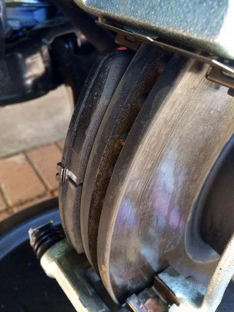

My front brake pads were replaced yesterday and wear seems to be wildly uneven. Three seem to have plenty of pad left while the fourth is worn almost to the metal. Kind of a pain that because of that one all had to be replaced. Any ideas what could cause such uneven wear?

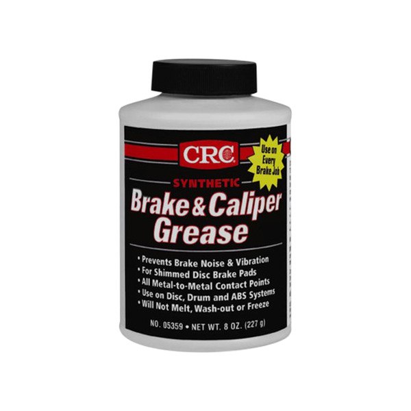

Which lube do you think is good?
Does Mazda sell oem lube?
I looked through the old threads but there are quite a few different opinions on diffferent lubes. There was ford one (which supposedly mazda used back in the days), crc silaramic one and another from autozone I think.
On the topic of lubrication of the pins.

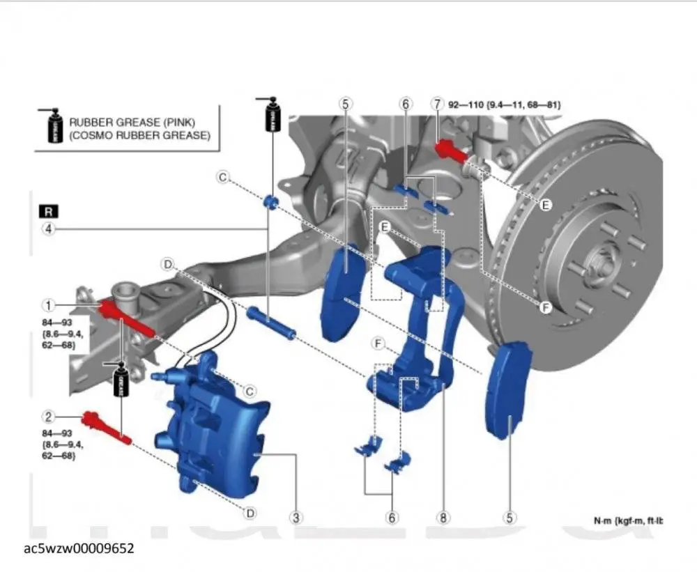

Don’t believe Mazda sells any OEM “rubber grease” for caliper pins mentioned in the factory workshop manual. I’ve been using AGS Sil-Glyde Silicone Lubricating Compound for caliper slider pins. It has been recommended by many:

And this one said the best:
DO NOT use any black or red "caliper" grease... they are petroleum based and are for the pad shims
use ONLY silicone grease for the slider pins... dielectric (is silicone) grease works great too

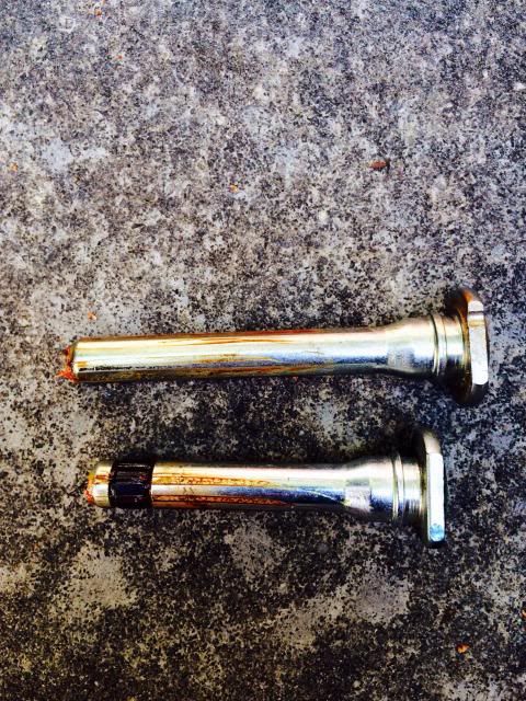

When I painted my front calipers I removed the pins to separate the caliper from the bracket. I was astonished to see very little grease in the holes and on the calipers pins themselves(less than 1000 miles). I've inspected brakes on new cars before (pre 2010) and remember seeing more grease from other manufacturers. Is Mazda being stingy with their lube?? Do they have a bad brake system factory worker?! I'd suggest lubing all metal-to-metal contacts with Sylglide on all these brake systems and making sure the braking system has no unwanted stiction. That being said, newer cars these days DO have more rear brake bias than older cars due to TCS/ABS control systems. But 15,000 is way too premature to be considered normal.

That wear shows a stuck caliper slide pin (probably underlubed) and is usually covered under warranty.
Thank you. I hope they fixed it when they saw the pad wear.

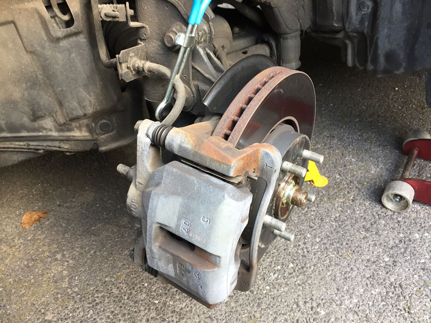

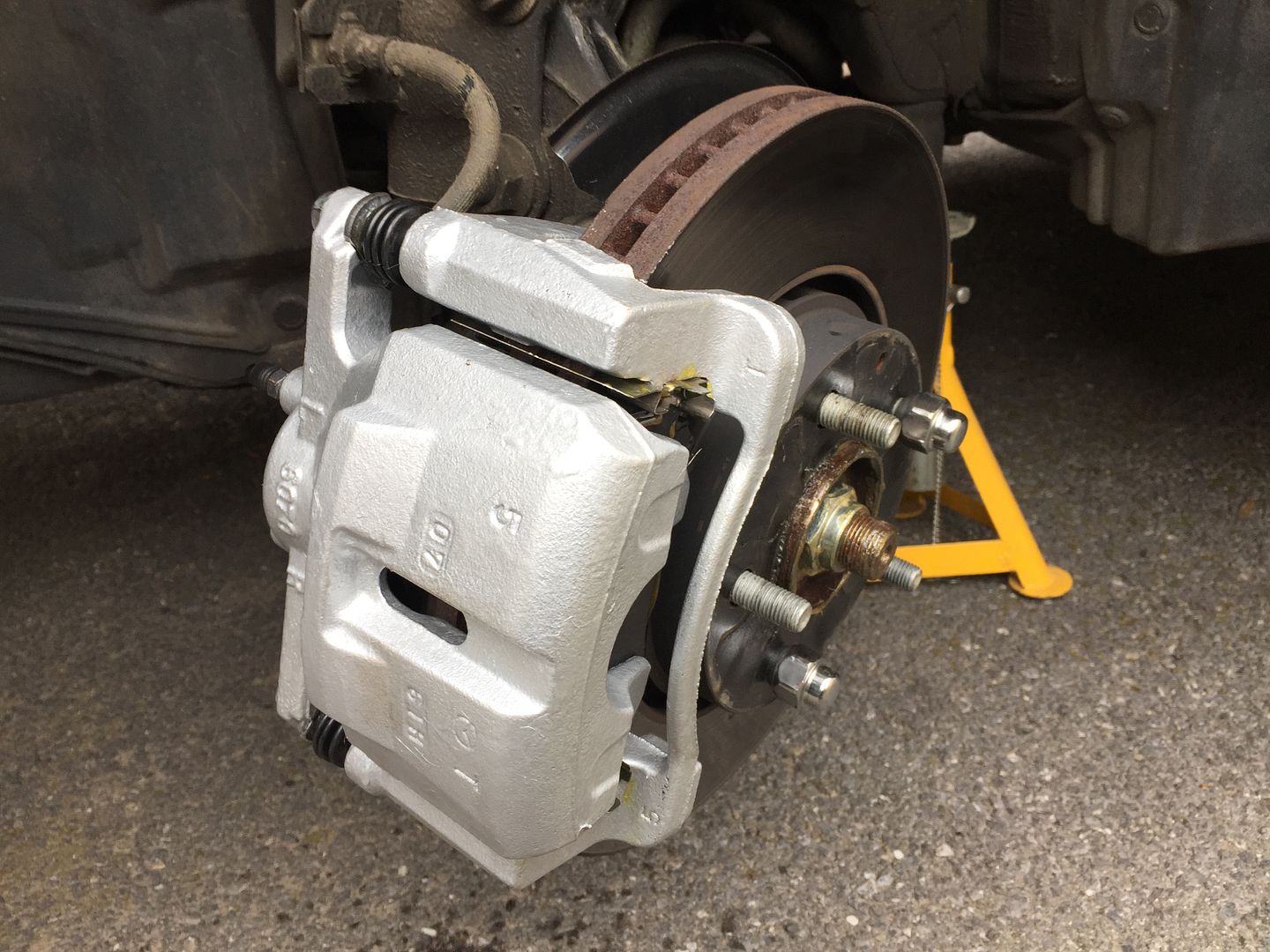

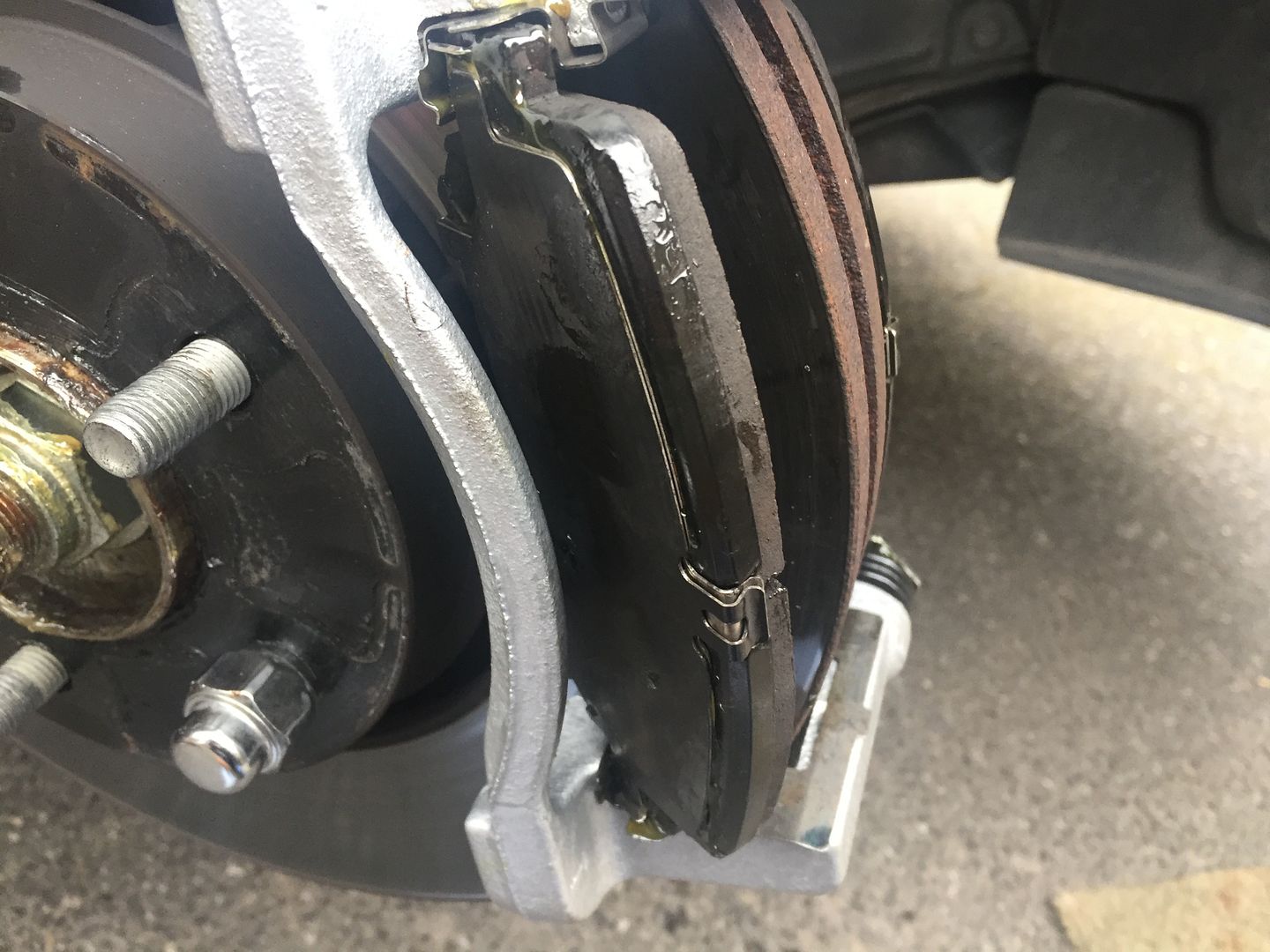

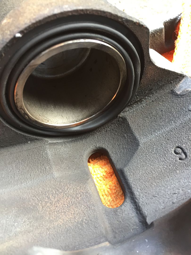

I changed the wheels back to the original 19 inch summers and used the opportunity to clean up the calipers which after 12 months and 12000 miles were looking quite poor.

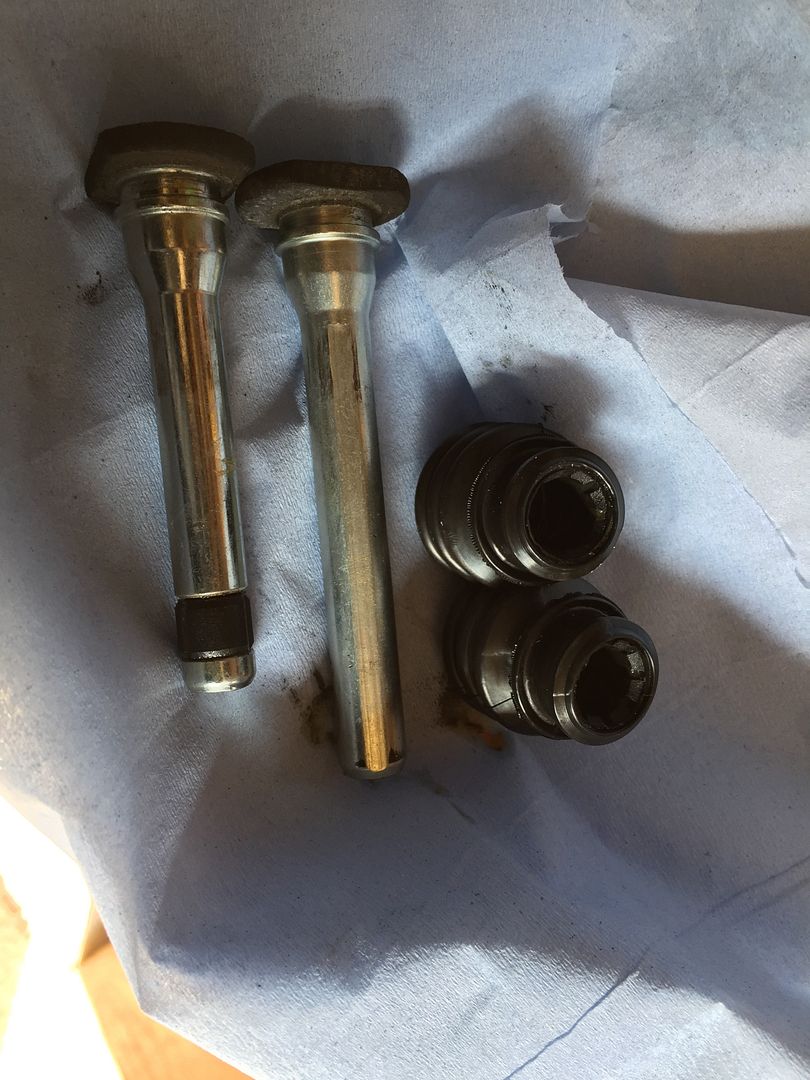

Brake pipe clamped, caliper off and then the carrier, all the parts including pads, shims and carrier clips all cleaned. Following reports on here that the guide pins were not properly lubricated, they were stripped out too. Well mine were well greased and like new pins!
I had new pads on stand by but mine were 6mm and the new ones 9.5mm. They were made by Ferodo in my home town and have made their way to Hiroshima for building on to my CX-5! I checked all the edges for lift, cleaned out the groove and assembled the shims with clean ceratec grease.
A word of caution. When you push the pistons back in, if the boot inflates like this, make sure you get the air out or it will get trapped by the pad and end up split. Certain doom will follow.
I used a small pick to carefully let the air out.
After much cleaning and wire brushing, the parts were dried in the obvious place,
Build it all up, pop the pads in at the back and twist them in,
Put the caliper back, guide pins and bleed the brake. When done it looks like this.
Eventually with the wheel fitted, it looks a treat,

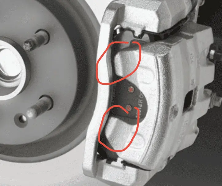

Thanks for reply but I am refering to the two contact points
You don't want to see any "grease squished out" when viewing brakes. The 2 contact points don't get greased (as there is no sliding motion occurring there) unless something is specified to be applied there to minimize brake squealing. It varies.
I do however apply a thin coating of grease where the caliper slides on the caliper bracket. Sometimes a layer of caked on dirt needs to be scraped off first. I use the end of a file and then file down smooth any high spots that could cause a hang-up. Sometimes the new pads have burrs that need filing off so they slide better into the stainless steel pad guides. It's nice to have brake parts that are clean, slide freely and are lubed at the right spots. Prevents hang-ups and abnormal wear.

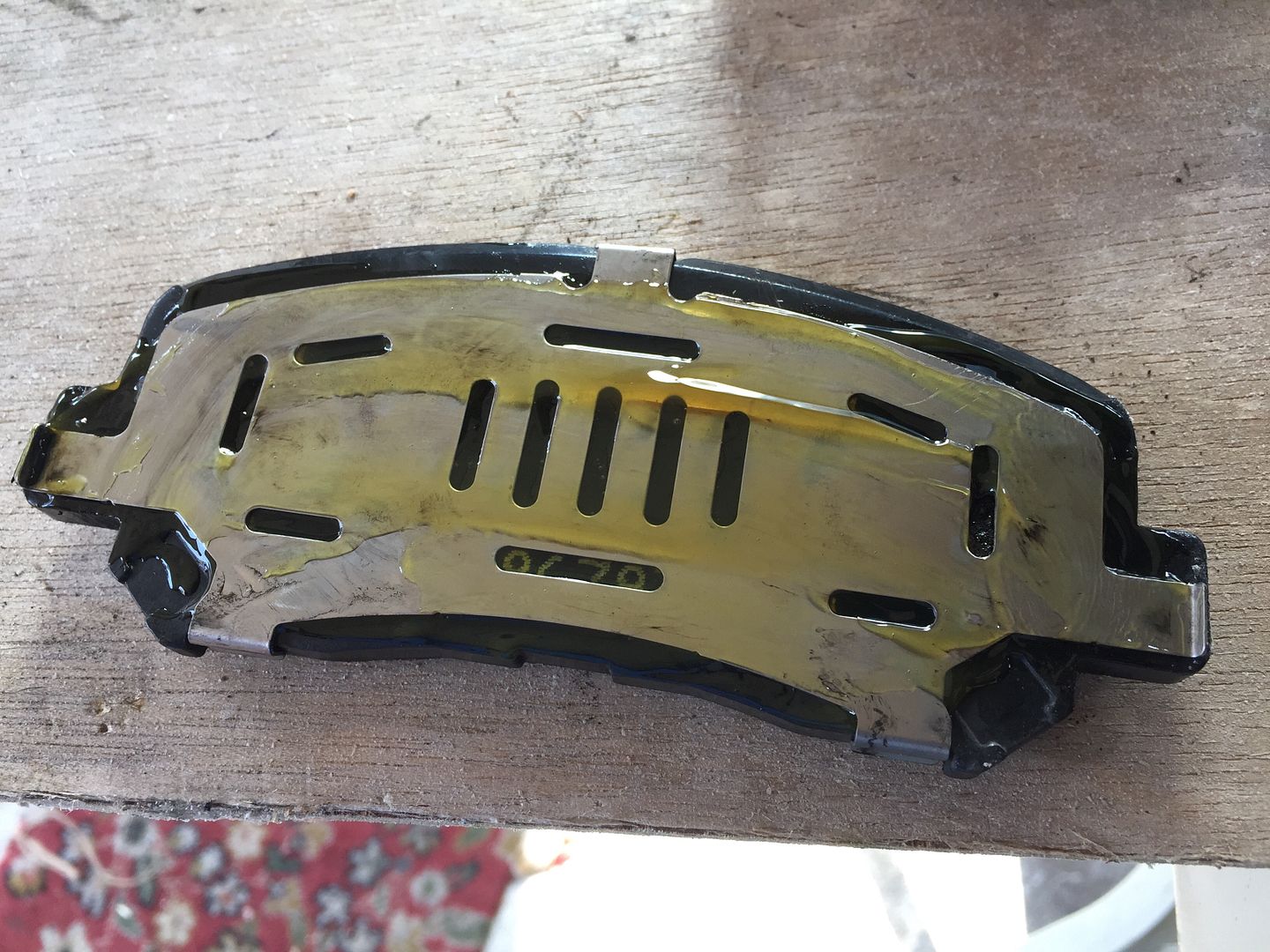

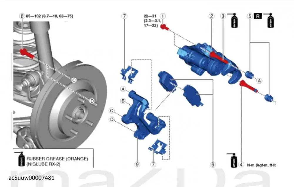

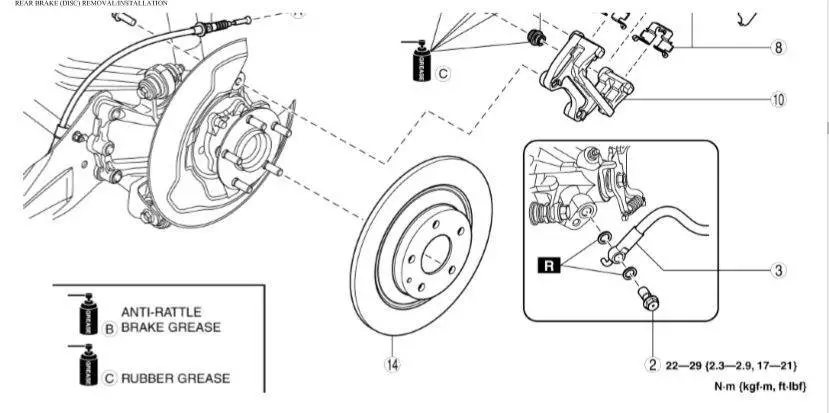

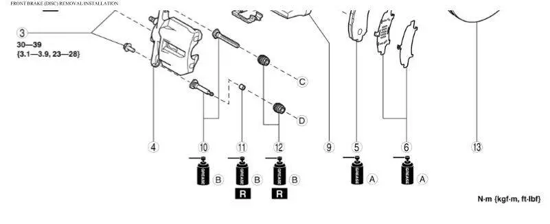

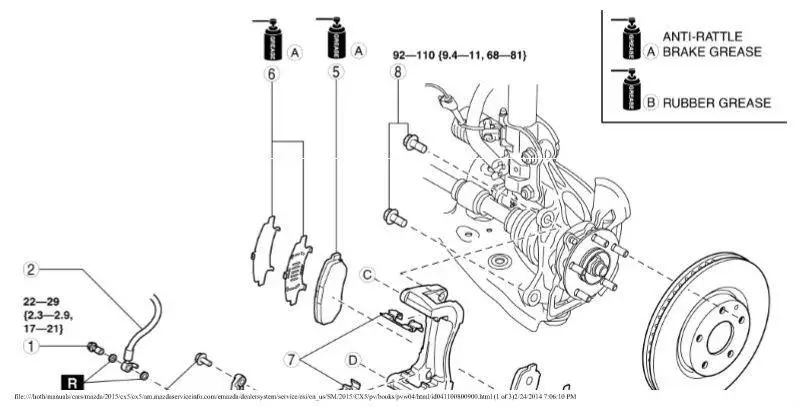

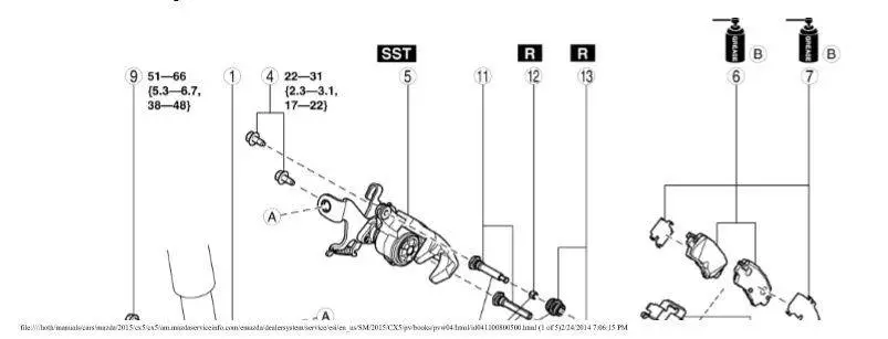

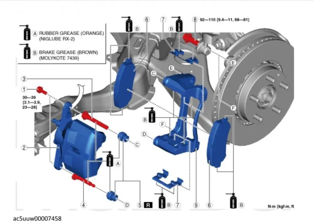

According to Factory Workshop Manual, Mazda doesn’t use any brown “anti-rattle brake grease” (Molykote 7439) on the back side of brake pads with dual-piston caliper front disk brakes on all CX-5’s with 2.5T. Only those CX-5’s (gen-1 and gen-2) with 2.5L NA use such grease on their standard front disk brakes.
Strangely, although they’re the same brakes other than EPB starting from gen-1 2016 MY, the rear disk brakes on gen-1 CX-5’s do use “anti-rattle brake grease” on pads, but not on gen-2 CX-5. :unsure:
So you won’t see any brown anti-rattle brake grease at the areas you pointed out on your 2021 CX-5 GT-R.
Gen-2 CX-5 Front Brake with Single-Piston Caliper (2.5L):
Gen-2 CX-5 Front Brake with Dual-Piston Caliper (2.5T):
Gen-2 CX-5 Rear Brake with EPB:
Gen-1 CX-5 Front Brake:
Gen-1 CX-5 Rear Brake (without EPB):
Wow those are some nice images, where did you get them? Is it from a Mazda repair manual? Please share, thanks.
