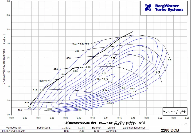

Found the comp map on another forum yesterday but I can tell you that basically the standard turbo at factory Mazda settings is running pretty close to the choke line so once you guys start modding then it pushes the turbo speeds beyond its optimum compressor efficiency.

Here you go...

Silo has been so kind as to upload the compressor map and perhaps be able to assist you guys with more information about alternative comp stages.

Ok from reading over the PG article it seems that they have polished / plated the comp cover which would give slightly better aerodynamic performance anyway due to relative aerodynamic drag factors.
Additionally, they are using a slightly larger compressor wheel which is billet aluminum so not only is it able to flow slightly more air, it can do so operating with slightly higher tip speeds. Although the original compressor wheel was not exactly moving at snail pace with a maximum tip speed ca. 520 m/sec (169,000 rpm) the billet wheel can operate ca. 560 m/sec however they would not usually be running near their maximum at standard factory settings.
So long as the comp cover is re profiled correctly to take the larger wheel then there should be no problems in achieving more airflow at the same factory boost pressure setting, therefore a "safer" higher HP and TQ output.
