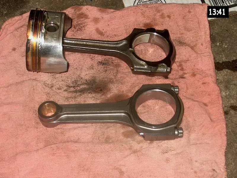

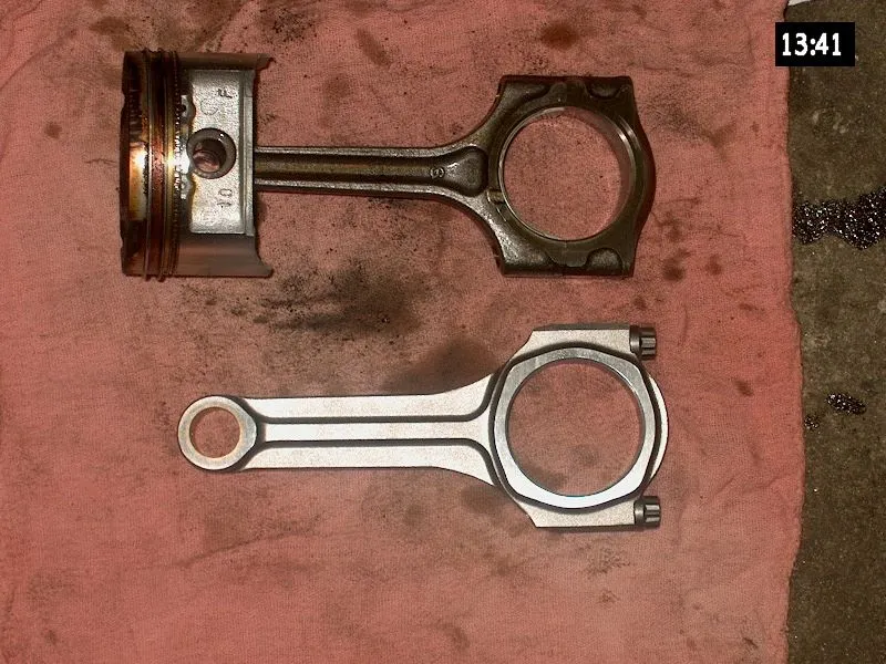

If you plan on going with forced induction this is an upgrade you will NEED to undertake.
This is for those who havent seen this pic from my photo thread

JE Pistons and Pauter Rods here too. 9.1:1 here. Stock compression. Did you all notice how well machined the Pauters are? Notice that you can see the lines on the big end of the stock rod where it comes appart to install on the crankshaft. Can you find any such line ont the Pauters?
