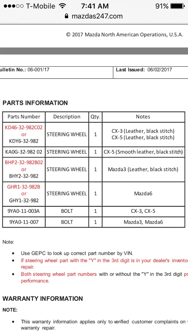

Yes, in the TSB, it says that they went to a more tactile and durable material. If only I could find it!
Dammit...just noticed mine starting to peel this evening - feels like a small nick right at 12 o'clock on the wheel that is similar to the pic jhui8 posted. It was too dark to snap a good photo, but I can clearly see a surface blemish using the flashlight on my phone. I applied a bit of leather conditioner (not cheap stuff) for the time being and will ask the dealer about it when I get an oil change next month.

Although your 2016 CX-5 is a CPO it should be still covered under 3-year/36-month new-car warranty. You should demand your Mazda dealer replacing your leather-peeling steering wheel under TSB 06-001/17 - LEATHER STEERING WHEEL SURFACE WEAR / PEEL. The only problem is according to TSB there're 3 part numbers for CX-5 black-leather steering wheel: KD46-32-982C02 or KDY6-32-982 (Leather, black stitch) and KA0G-32-982 02 (Smooth leather, black stitch), and it's hard to tell which one would last longer. Since your dealer most likely is going to special order it, ask them to order KD46-32-982C02 if I were you as it seems to be the latest revision and the leather should come with more textured feeling and "rough" like the one jhu8 got.⋯ I guess I will be asking about the steering wheel material/peeling on Friday, when it goes in for the 20k mile service.

The TSB says:They’re using a more durable leather.
Ref. No. R102/16D said:CAUSE
This concern is caused by an insufficient wear resistance of the steering wheel surface.
MASS PRODUCTION CHANGE
For Mazda6 (GJ), Mazda3 (BM), and CX-5 (KE), the mass-productions have been discontinued. For, Mazda6 (GL), Mazda2 (DJ) and CX-3 (DK), the wear-resistance of the steering wheel has been improved.
The TSB says:
So for those who are out of new-car warranty are out of luck ⋯
Interestingly there's smooth leather steering wheel with RED stitches, K066-32-982, for CX-5 in other regions.
