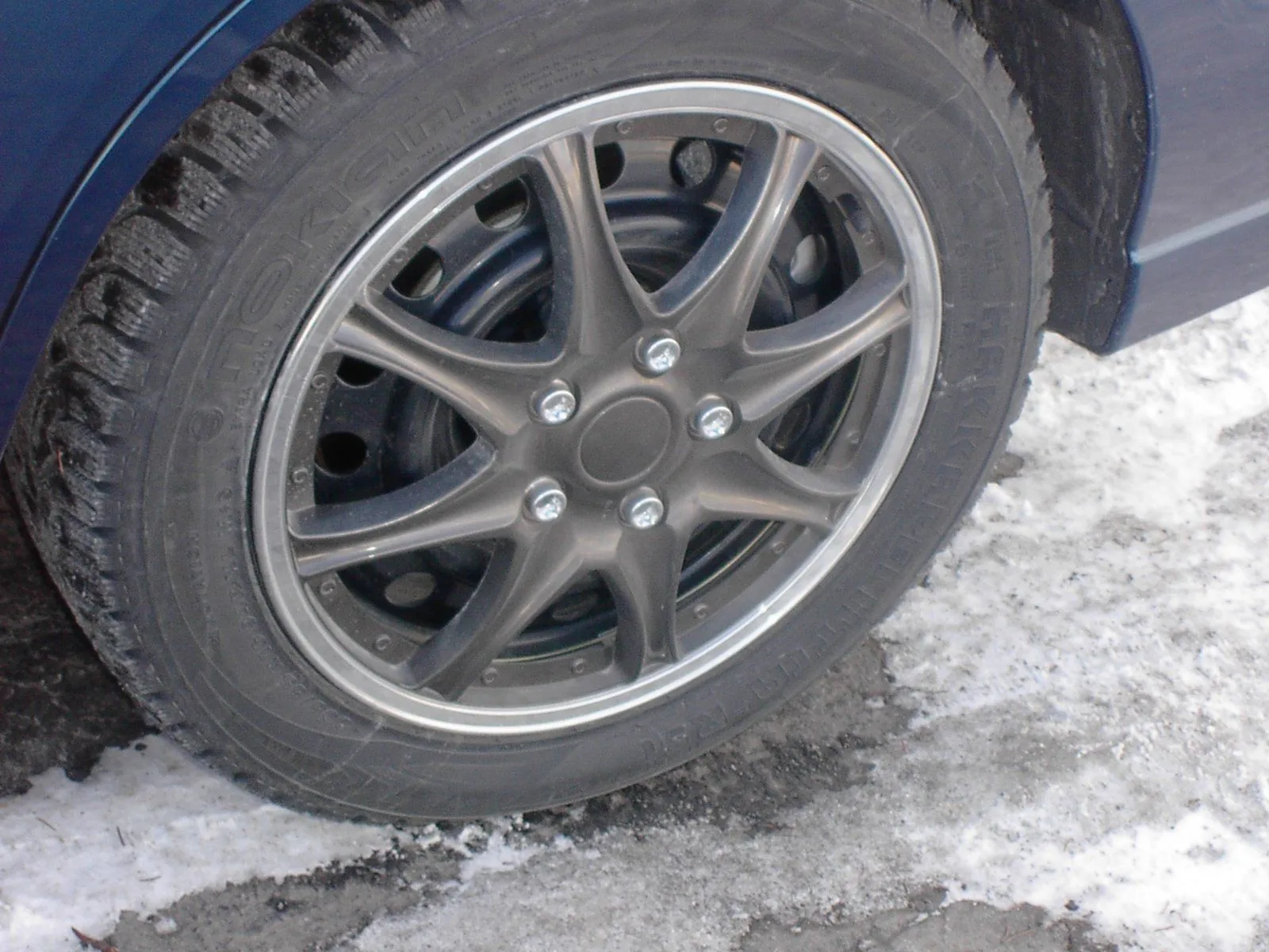

POLARBEAR
Here is shot with steelies and hubcaps got to love it....

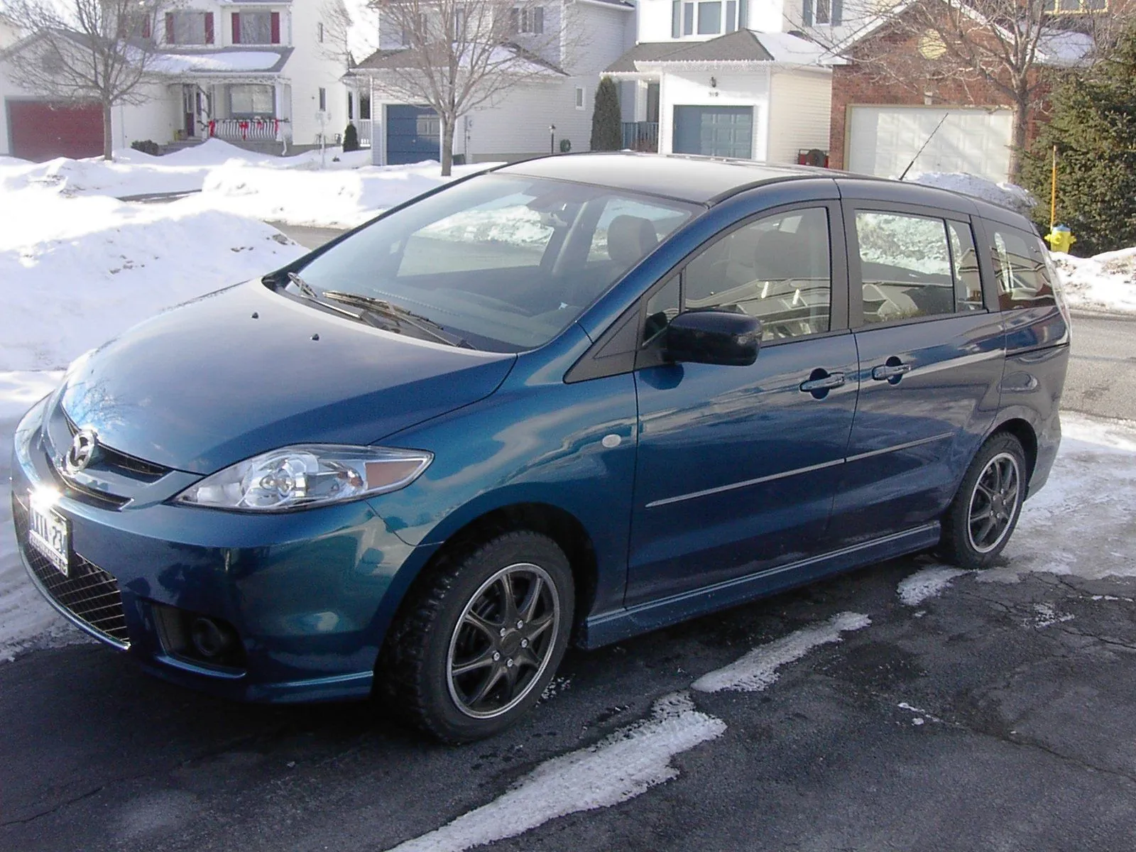

Installed, balenced just over a grand.... best tires I have ever owned. I bet they will out last life of my 5
