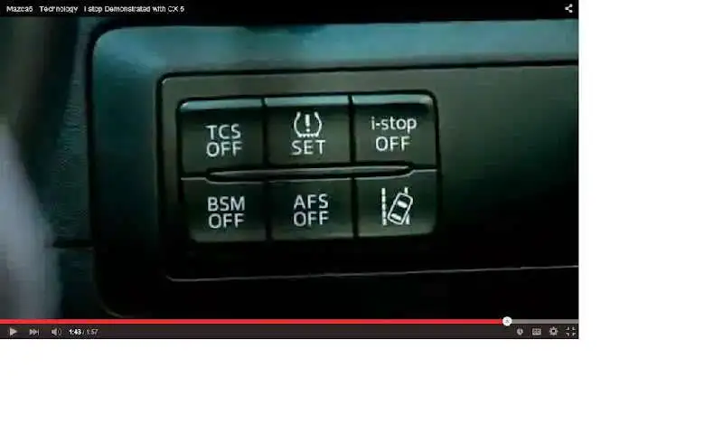

Yeh the official sales brochure for 2023 US CX-5 seems not to be available from MNAO yet. The easiest way to find out if the US 2023 CX-5 features i-stop start / stop system is to check out a 2023 CX-5 in person and look for the “i-stop OFF” button on the switch panel.I was reading the online manual last nite ahead of picking up the car.( I never entered the car on the lot). Will call Dealership today, but hopefully I read a global manual & this feature won't be on the car..Fingers crossed! I revised my orig. commrents.

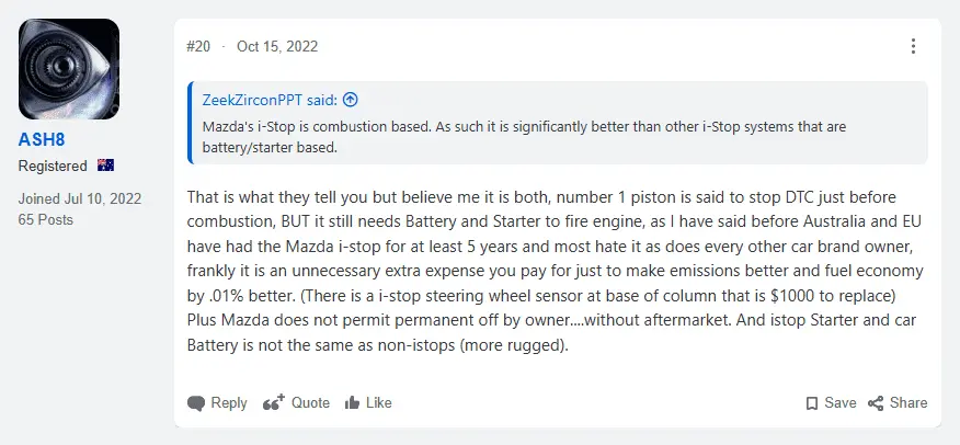

For my CX-50 it does indeed use the starter (and has the beefed up battery). I could hear the starter turn momentarily every time it restarted. Admittedly, the engine did start virtually instantaneously, but I 'felt' that additional wear every timeThis also makes me believe Mazda’s i-stop start / stop system still uses starter in addition to utilize the compression cycle to re-start the engine. The schematic diagram of the i-stop is also showed the starter is a part of Mazda’s i-stop system.
Thanks for the clarification as some believe Mazda’s i-stop doesn’t use starter to re-start the engine.For my CX-50 it does indeed use the starter (and has the beefed up battery). I could hear the starter turn momentarily every time it restarted. Admittedly, the engine did start virtually instantaneously, but I 'felt' that additional wear every time![]()
Mazda doesn't use the starter to restart the engine. It uses compression to get it going.
It's faster, and it doesn't shorten the life of the starter. Better system.

Yes when you replace the Q-85 battery it requires reprogramming or registering the battery (ID?) by the Mazda dealer.The re-programming thing I've not heard about. Do you know why/what? I was hoping that in a few years when I have to change the battery, I could use a simple one since I've disabled the iStop.
As far as I know, if you own a Mazda with i-Stop or i-Eloop, you need to use Q85 battery, which costs 3x more and needs to reprogram it. Some owners were brave enough to DIY. Some went thru without drama, but others saw ERRORs on the dash.
BTW, dealers near me wanted $500 for a Q85 battery replacement of my '16 Mazda6 GT with i-Eloop. I negotiated it down to $0 (with dealer's special cash fund) since I own 3 Mazdas (and sold one before them). My service advisor called his big boss to get approval. I gave him a satisfaction rating of 10 afterwards. Why not.
