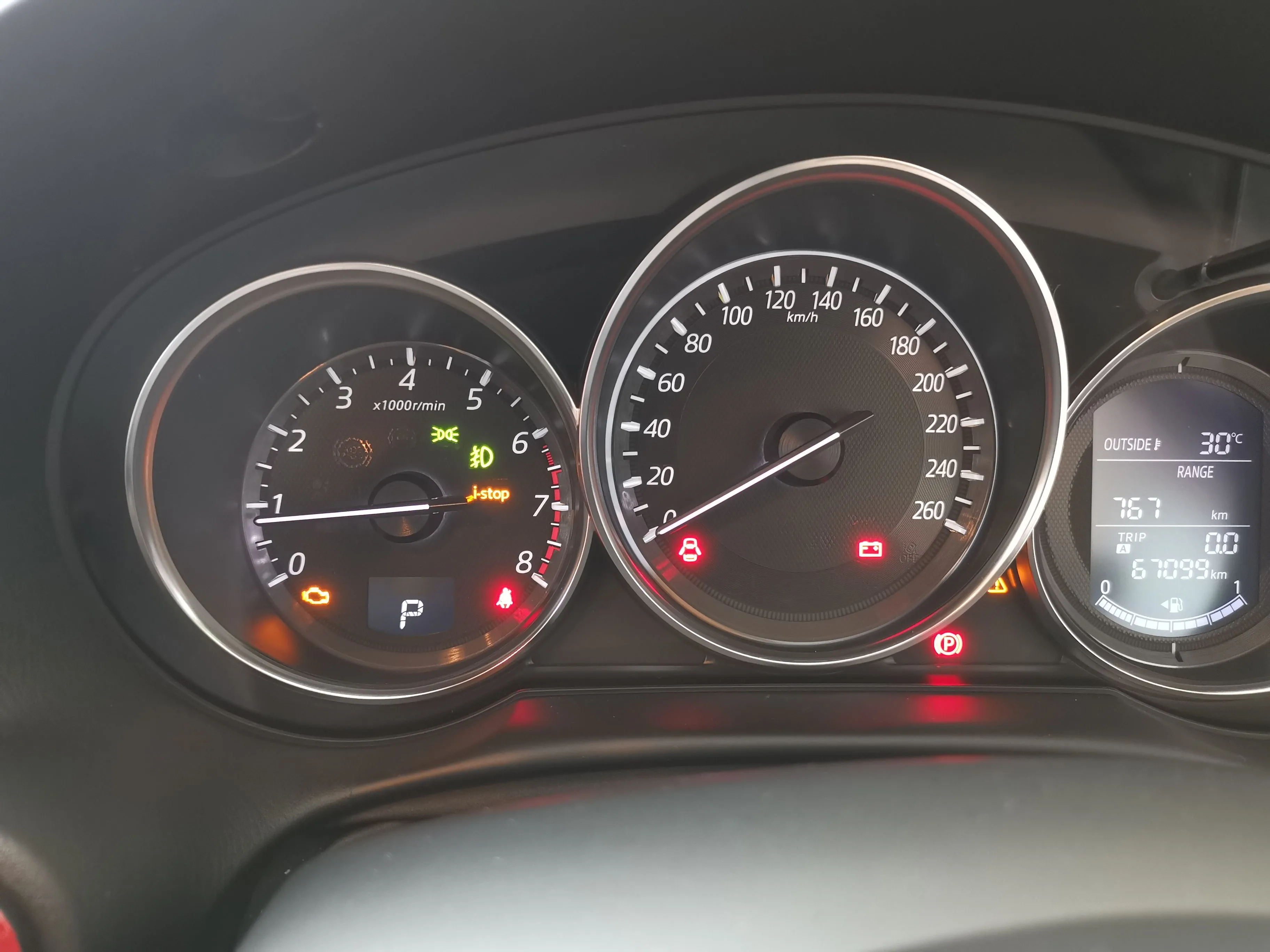

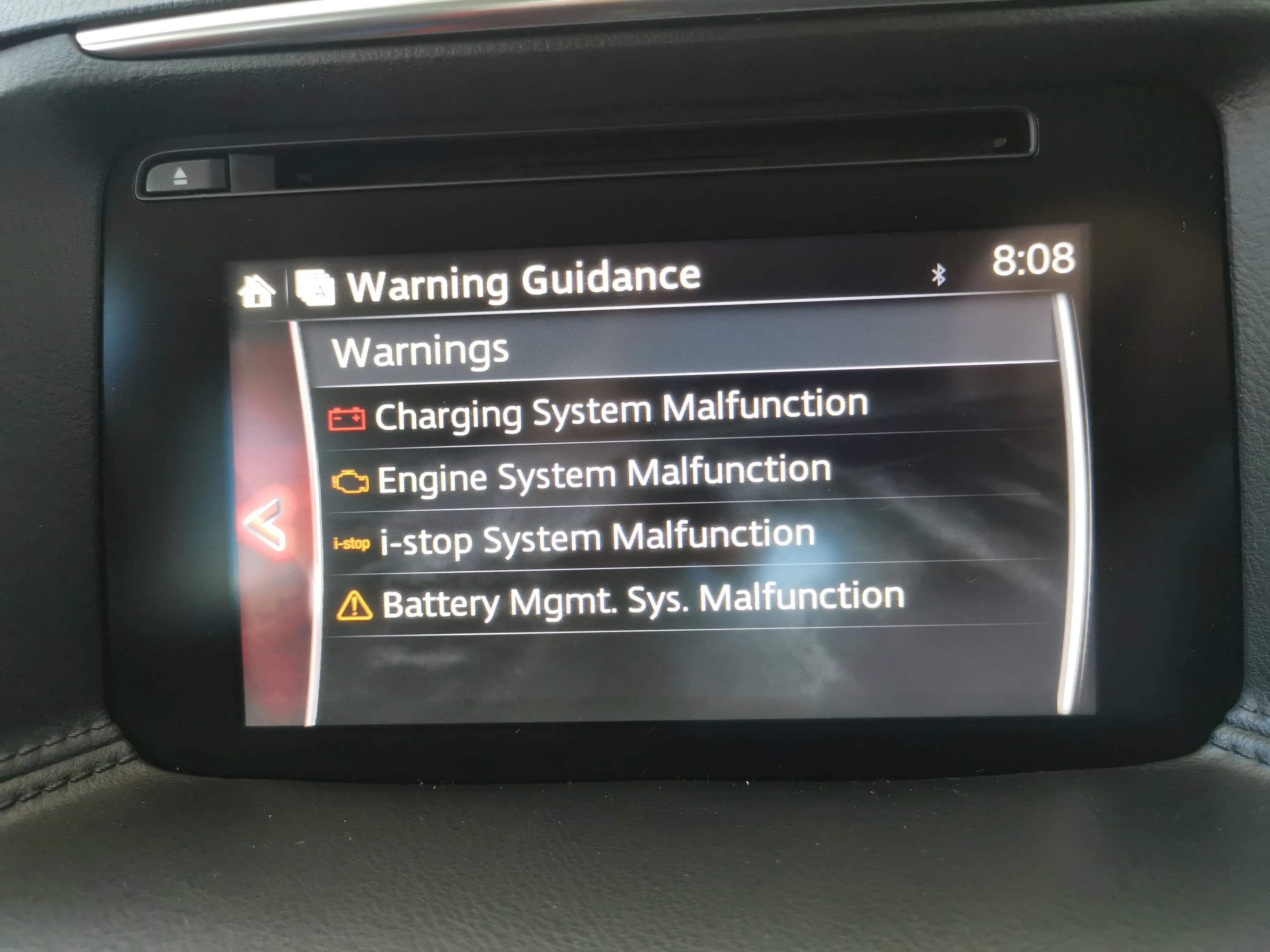

Greetings Mazda247! I own a 2016 CX-5 CBU unit and I've just got my battery replaced. After replacing the battery, the following warning guidance is shown. I took it for a short drive which i think it may reset by itself but all the warning still shown. Everything runs normally and everytime I manage to start up in 1 kick. So I'm seeking help from you guys if there's anyway to solve this issues? Thanks in advance!
PS: The nearest dealer is about 3hrs drive from my area, so that will be my last option.
Very strange. I think you might have to go thru some kind of elaborate reset procedure by pulling various fuses.
It sounds similar to another recent problem.
You might want to read this recent thread. I don’t recall the resolution but it might eliminate some issues if nothing else.
I will take a look on the following thread, thanks!
What kind of battery did you put?
I'm using NS60. I'm aware that for i-stop model I'm suppose to use Q85 battery. I'm previously using NS60 as well after my factory battery dead. I've installed a i-stop disabled module and also contacted my service centre about using NS60 instead of Q85 which they said no problem for that.
Thank you all so much for the replies! I've been told by someone to take a drive about 30km-50km and let the car rest for 30mins(By rest means stop engine, key away from car at least 5meters), to see if the system will reset itself. Because sometime those code appear is just a false alarm after replacing battery. Just wanted to know opinions from you guys if this method is plausible, thanks!
View attachment 223763View attachment 223764PS: The nearest dealer is about 3hrs drive from my area, so that will be my last option.
What is a CBU unit?
As far as I know, if you own a Mazda with i-Stop or i-Eloop, you need to use Q85 battery, which costs 3x more and needs to reprogram it. Some owners were brave enough to DIY. Some went thru without drama, but others saw ERRORs on the dash.
