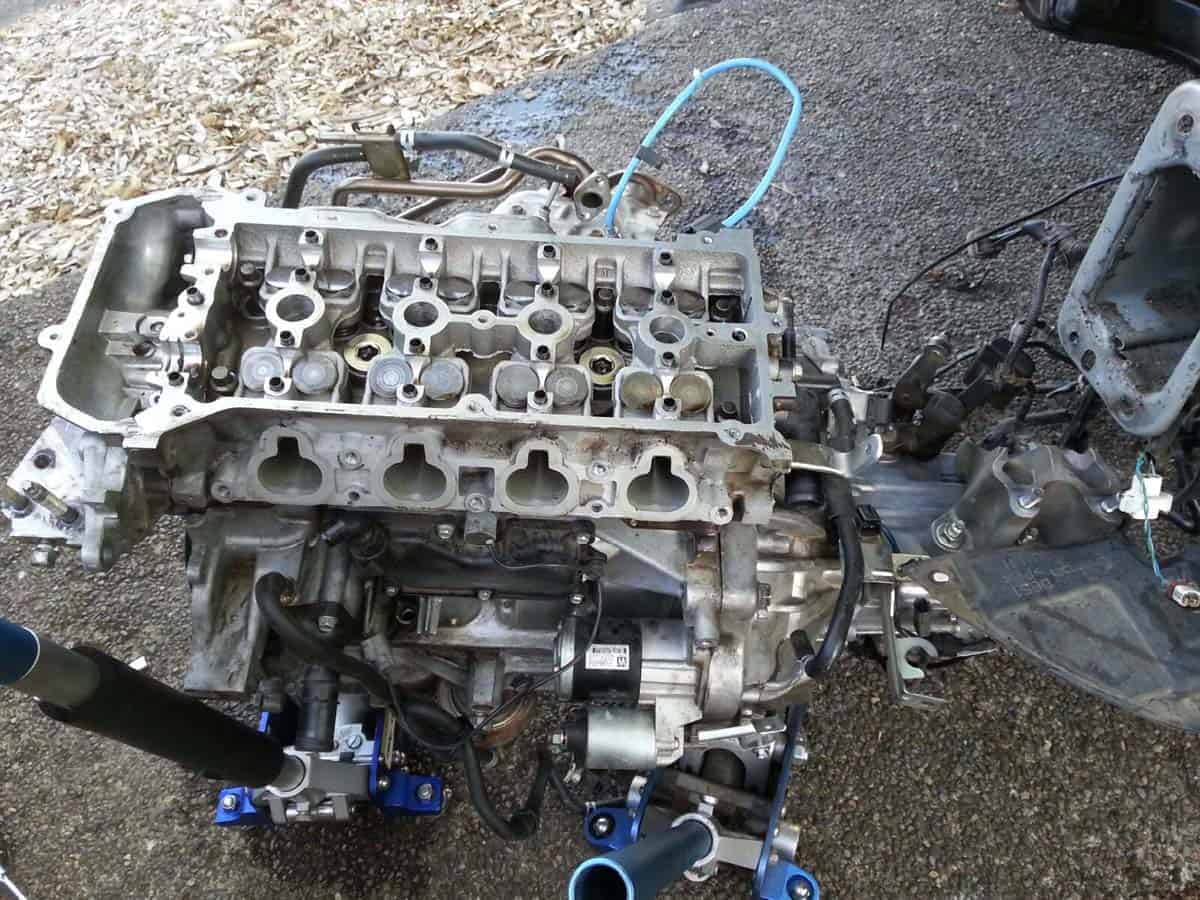

I got to pull the engine out of the 2 last night as I am down 14% between cylinder #1 and #3 and #4. #2 is somewhere in the middle.
Not too bad for ~18000 miles which over half were at the track. The cylinder walls look pretty worn and I will pull the #1 piston this weekend to see what the rings look like.
-Derrick
