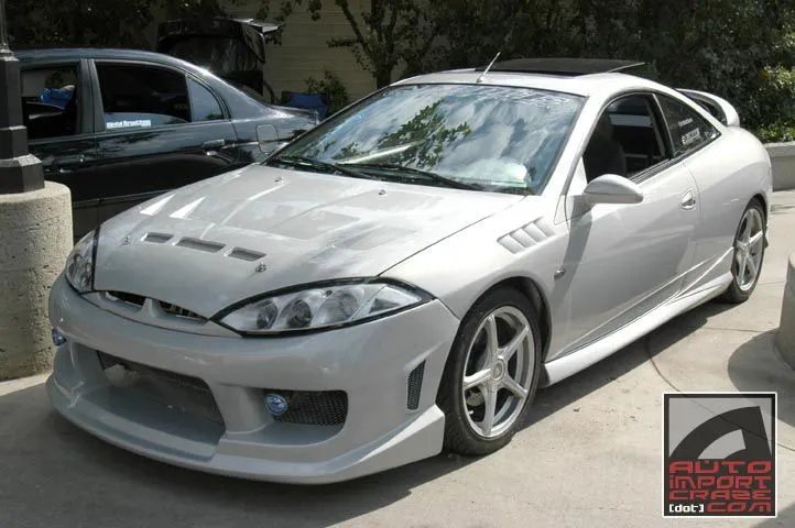

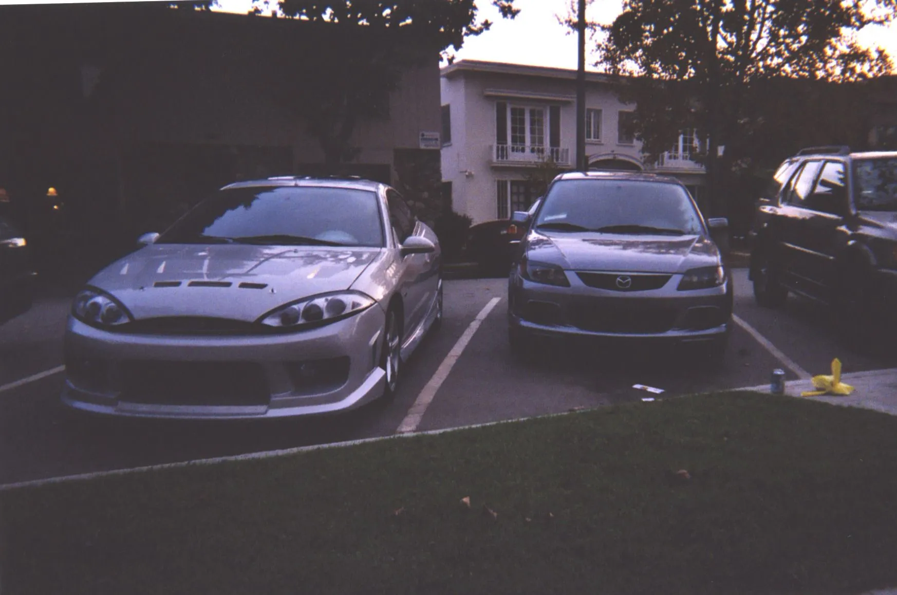

Haha, unfortunately...for me at least, I am a perfectionist. I would like to have a perfectly balanced car. However, since the word perfect really is in the eye of the beholder, I would just like the ride to at least be equal to or close to what it is now (stock). I would like to eliminate the fender gap most of all, the car seems to sit just a bit too high in the front. Especially when I park it next to my Cougar. That car has a perfect fender gap IMHO. I also like to corner hard and fast, and take twisties (PCH baby! best highway in the world for scenery/twisties). So I would also like it to be able to handle me tossing it in to corners much faster than any 4-door family/compact size car should be able to handle. Again, I am used to my 2 door/wide/low excellent handling European-spec Cougar. Is it possible to get all of this with any of the available suspension setups? I am eventually planning on the Corksport suspension upgrades, most specifically the trunk reinforcements/rear strut tower bar. Thanks!

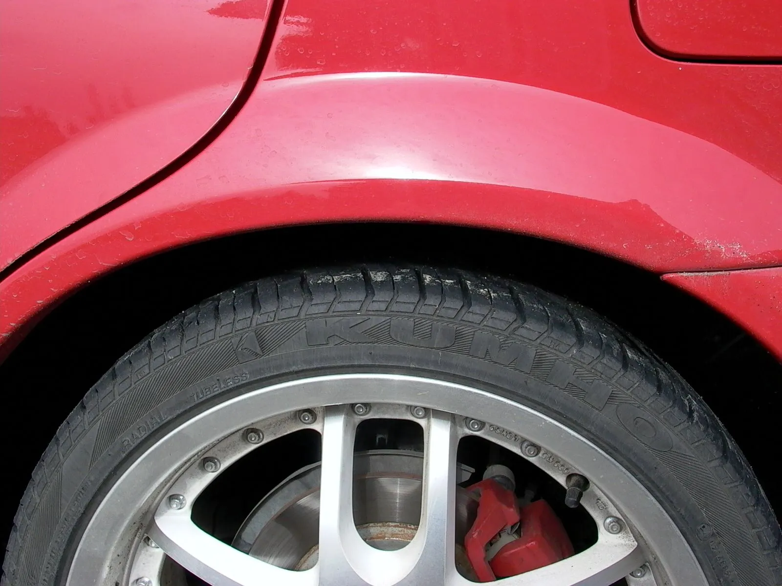

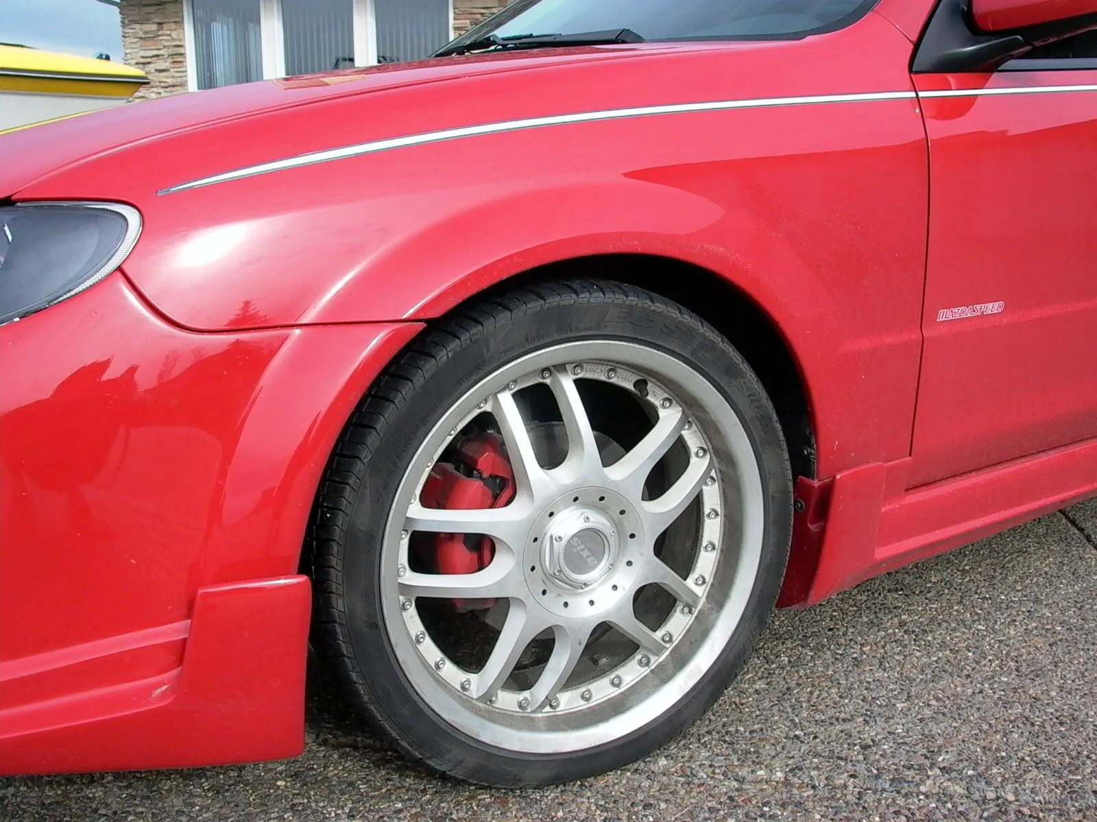

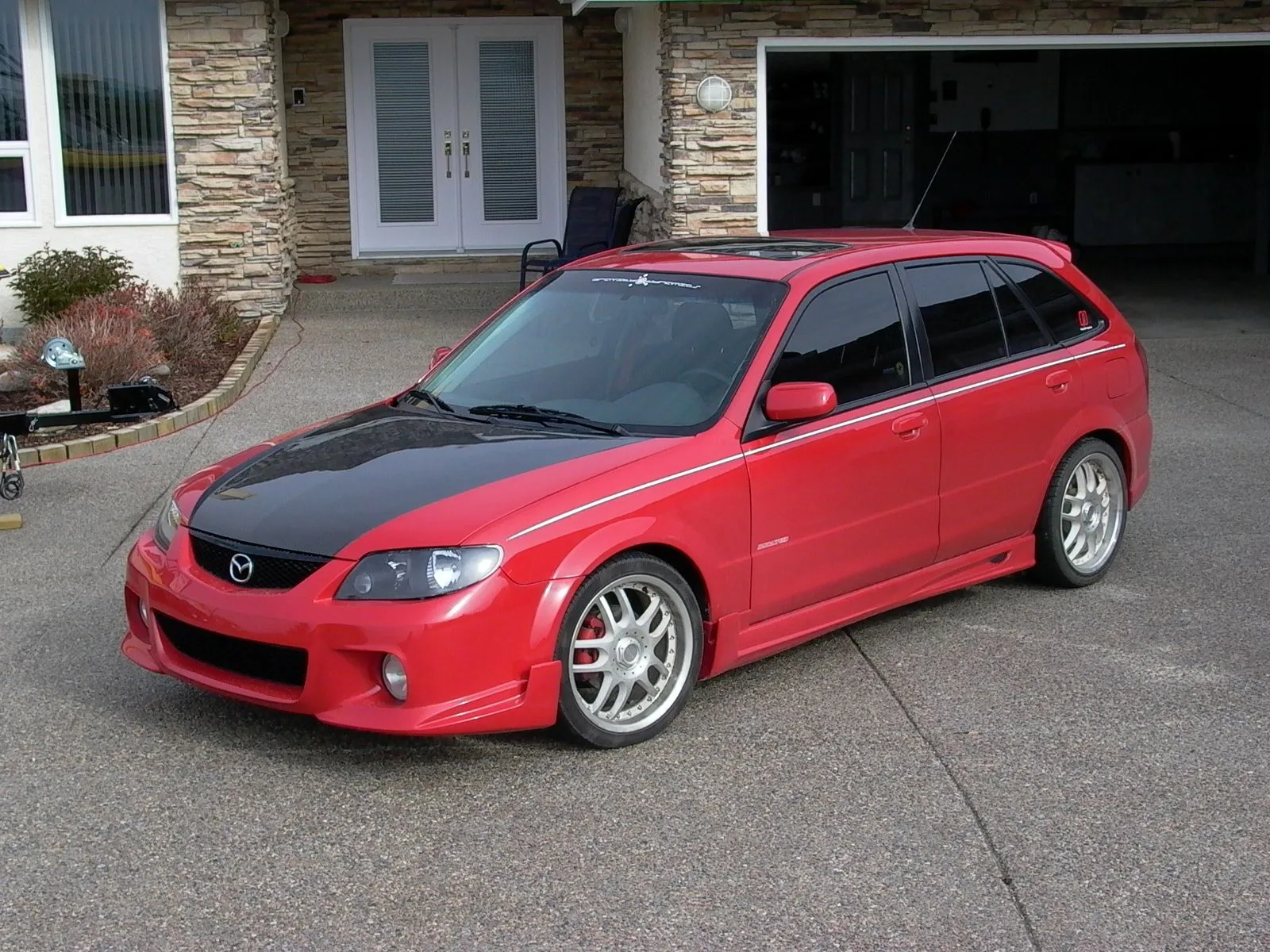

I'd definitly reccomend the iON springs. I just put mine in myself yesterday and I do alot of driving on some not so smooth roads, and while they do stiffen up the ride a bit (sporty, not harsh) they are stil lvery streetable. The 1.18" drop is fairly mild too, so you won't run into problems with clearance (mostly) but it still looks good. Pics attached.
Edit: Excuse the dirty car but it's been raining non stop for the past 3 days.
