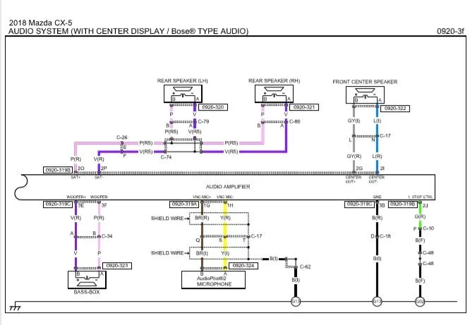

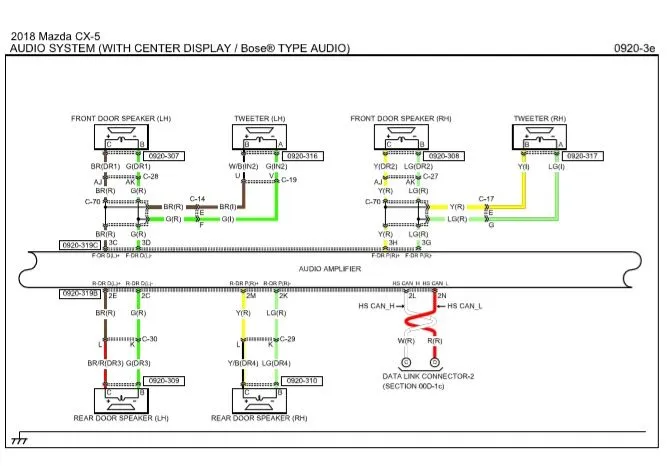

Here're 2 speaker schematics for 2018 CX-5 Bose as I couldn't find one for non-Bose. It shows green / light-green wires are for negative. So I believe the original connection was correct and you now switched the polarization on tweeters.
Interestingly on 2018 Bose the schematic doesn't show any crossover capacitors for OEM tweeters. And these silk dome 25mm / 1" Bose tweeters are connected directly from wires of front-door 165mm / 6" full-range speakers. The rear left / right speakers are actually single-channel fill-in speakers connected from a single output of the audio amplifier.

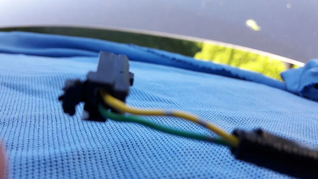

I have checked with volt meter and the reading has suggested that in each of my speakers (all six of them) that the green wire is the positive wire. Funnily enough in the door 6.5 inch speaker contact pin, there is a small round yellow dot indicator pointing to that green wire side in all 4 door speakers. So I have followed the same scheme after checking with voltmeter each time. There may be a difference between Bose and non Bose. It sounds so much better too." I'll try to post a picture of that yellow dot on the connector.
The capacitor is built by Elna/Elma therefore good quality, I am sure but can not read any microfarady number on it.

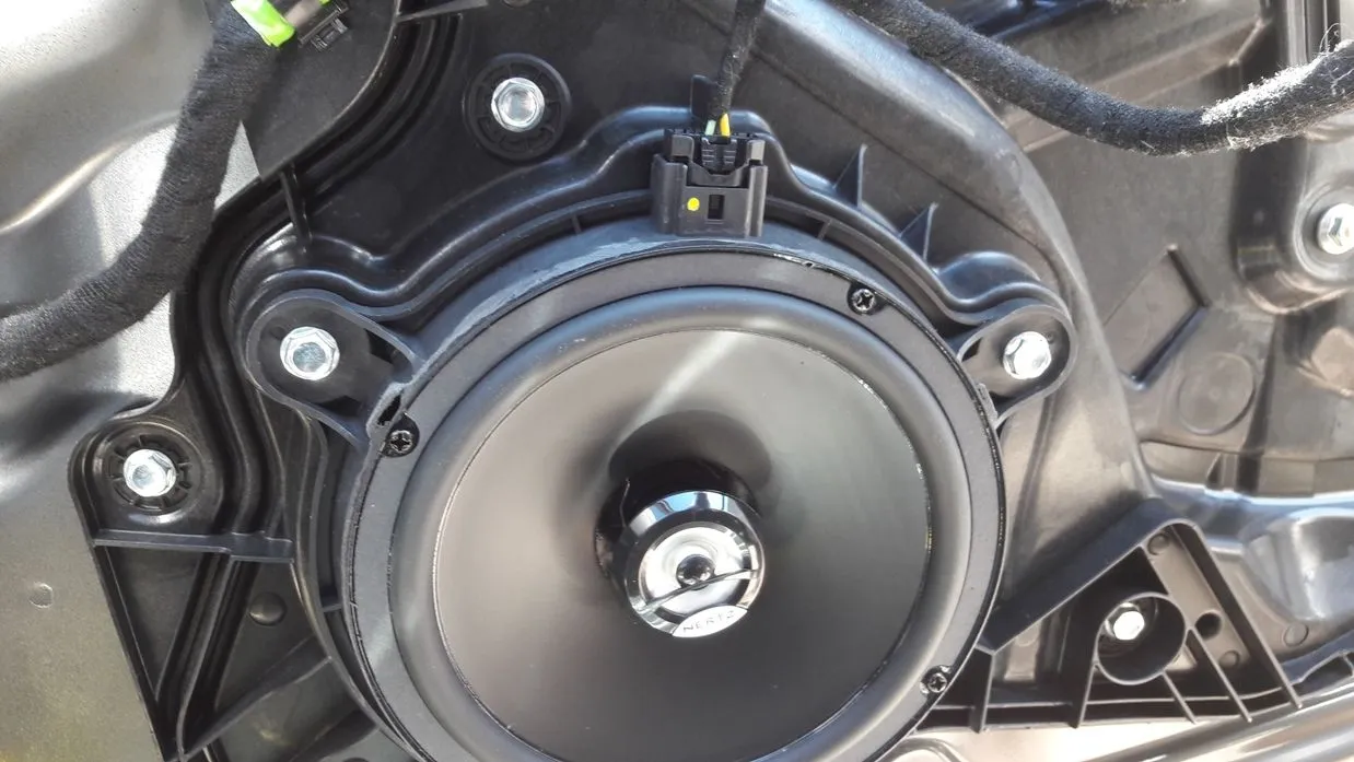

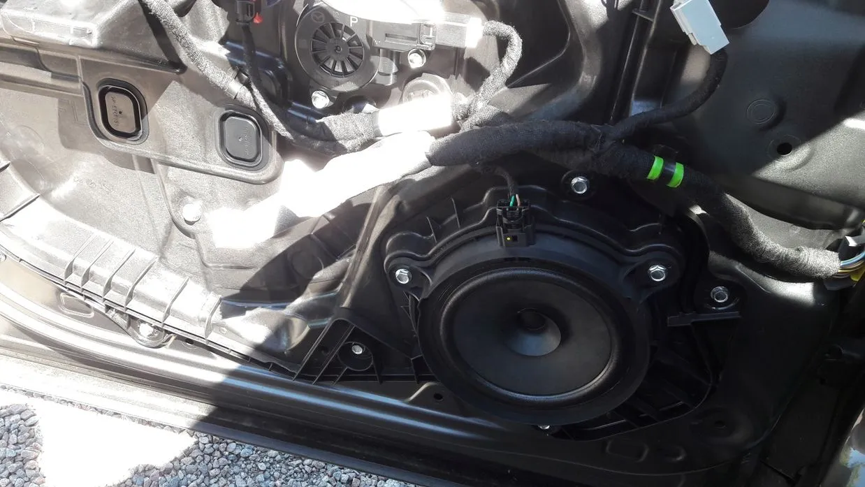

Here are thedoor speaker photos with the yellow dot on the green wire side (pointing possibly to the live side) and the tweeter wire that has the same colour as door speaker.
This's really weird! I can't imagine Mazda would make this kind of mistake on all speaker's polarities during design and assembly. All wires are color-coded I really can't believe they screwed up this easily. I hope I could find gen-2 CX-5 non-Bose schematic but I also think Mazda would use the same color-coding scheme on either Bose or non-Bose speakers. May be we can PM Anchorman and see if he can locate one.
On the other hand, since you switched all speaker's polarities form factory you at least don't have out of phase issue among all speakers. :)
Check out the post above for photos. Just added them. Look carefully at the dot, it must mean something and it was on the same side of all speakers, pointing to the green wire. No I do not have phase problem.
