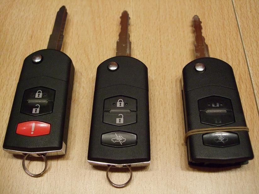

First of all: I was not able to program it for my car :-(
As I needed it as replacement for a broken key (which still worked), I just used the housing and put my electronics into it.
All keys together:
left the new uncut key, in the middle my original spare key and my broken key to the right.

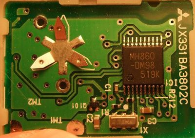

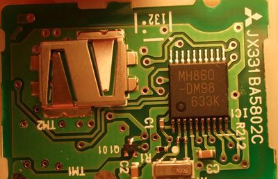

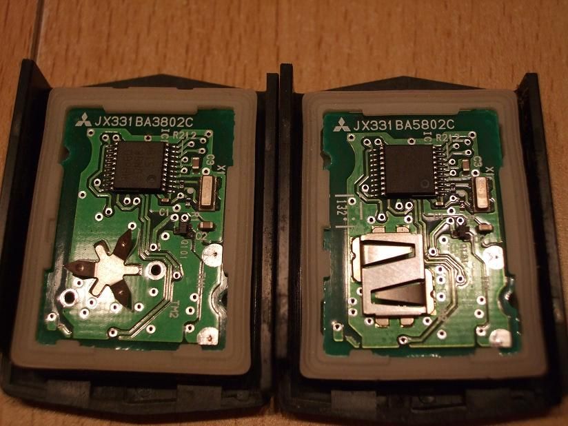

I suppose it's due to the different circuits in the keys. As you can see one has the number JX331BA3802C, the other ends with 5802C
Basically they look identically, despite the battery contact and the IC:
One Chip is labelled MH860-DM98519K the other one MH860-DM98663K.

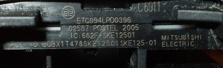

For completeness I took a picture of the numbers printed onto the key:
All keys together:
