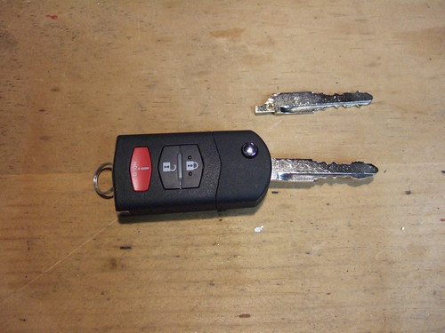

I just want to add some additional information about the switchblade remotes that was not obvious to me but may help others.
I had broken the small tab inside the remote when taking apart the remote to change the battery. I had obtained a replacement fob and moved the key (removed the roll pin) to the new fob head
. Since I don't drive the Mazda5 I didn't readily notice that I couldn't start the car, I was only able to lock and unlock the doors.
I read on this forum that the key portion had the RFID chip in it. I was thinking that it was the key blank.
On another forum I found out that the RFID chip is actually in the key head, not the key blank.
http://forum.miata.net/vb/showthread.php?t=498083. I disassembled the old and new key heads and swapped the part of the housing that contains the RFID chip (it looked to be epoxied in). I suggest removing the key (remove roll pin) in order to get the switchblade spring set properly.

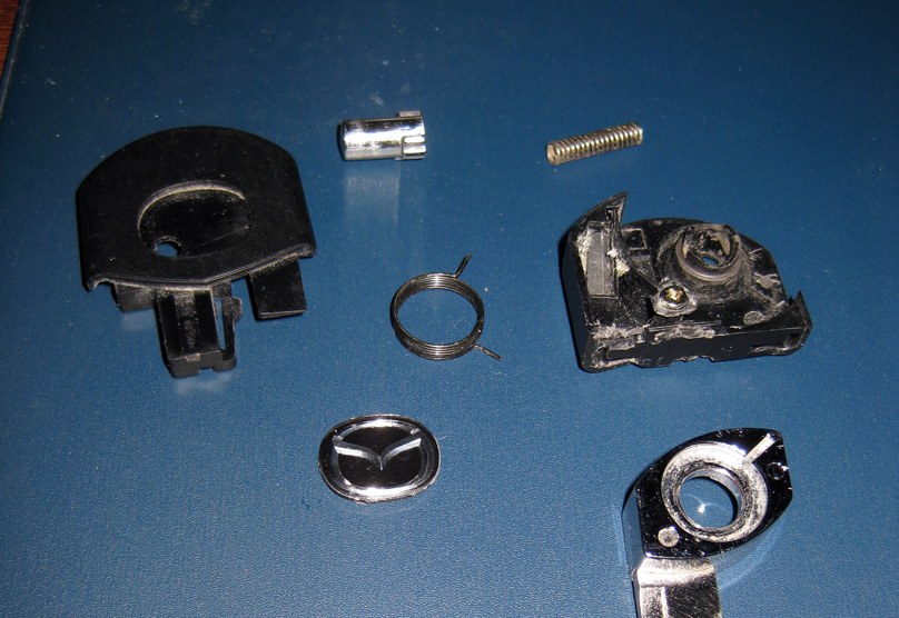

Following are some pictures to illustrate things. These may not be for Mazda5 fobs.
Here is the a key head (or key as Mazda refers to it). It shows the intact retaining clip.

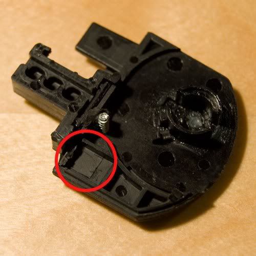

This gives a view of a broken clip. The circle is the area where the RFID chip is.
This picture gives an idea of what is inside the key head.

I ordered a fob (which I successfully programmed) and a switchblade key together for $36 from Amazon. After the locksmith cut the key we couldn't program it. I opened it and there's nothing in the small square cavity. Is there a way to JUST order the RFID chip to insert into this area? Does anyone have info on whose chips / model #'s they use?
Edit: I think the chip is actually the large rectangular thing that's glued into the cavity on the other side. I guess mine is bad?
Yes, that, circled in red, is the chip. It's a little piece of silicon brick that is just wedged in the plastic. I broke the plastic housing and got a replacement and moved over he key and that chip to the new housing and no programming needed.
