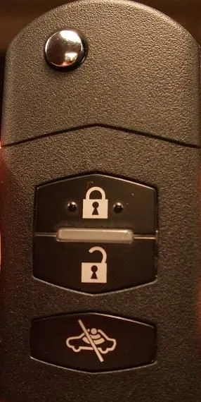

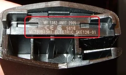

In all the auctions that are on Ebay most sellers ask to compare the following numbers with the ones you have on your keys:
FCC ID: KPU41788
IC : 4238A-41525
Visteon No. 41525
What I have on my key is completely different.
MR 1382 ANRT 2005
CE C 5616
Mitsubishi Electric SKE126-01
Also none of the sellers offers a key that has the same buttons like mine. Instead of a panic button, I have a button to disable the car alarm.
Maybe I should add that I live in Germany and have a "European" Mazda 5.
Do the numbers of the keys you purchased on Ebay match what's inside the original keys?
