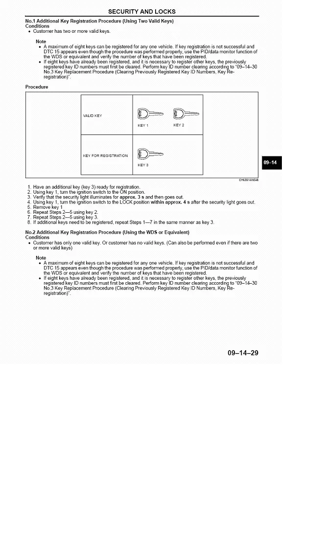

I made a 3rd key for my 2007 mazda 5...
I bought a transmitter fob off ebay (~$30). I programmed it using instructions in the PDF file. You can program up to 3 fobs for your car.
-Note that although the PDF specifies it is only for 2006 vehicles below a certain VIN, it worked fine on my 2007.
I bought the RFID key blank from the dealer (~$10?) and had it cut at the local locksmith ($5). You or locksmith will need to tap in the small roll pin to attach key to the fob if it's not already attached. I then programmed the key using instructions in the GIF file. You can program up to 8 blanks this way.
Good luck!

Does anyone have the remaining instructions from that GIF posted before? I bought my Mazda5 used and only have one key. I want to program two more keys and the PDF instructions don't seem to work.
I think you need to go to the dealer to get them to program at least one other of your keys.
The dealer told me and all the instructions I have seen all require two remotes. I think the intent of this is to be a security feature to prevent someone from cloning a key with just one copy.
But hey, please correct me if I'm wrong.
^^ That is correct, 2 same programmed remotes are needed to create a 3rd one. I agree, this measure is for security reasons (i.e. when dropping your car at the valet parking)

And the beauty about the way the system works, is that if you have three keys, and if you do lose a key, upon discovering you've lost it, you can program out the lost key with the two remaining keys. So yes, someone who finds your key can get into your car, but they won't be able to start it.

I've got a 2008 Mazda5 and just bought the regluar (non-switchblade) key (with chip) from the Mazda dealer (part number F1Y1-76-2GX). I paid MSRP for the key (~$28), but they cut it for me too. Programming was easy per the directions above.
