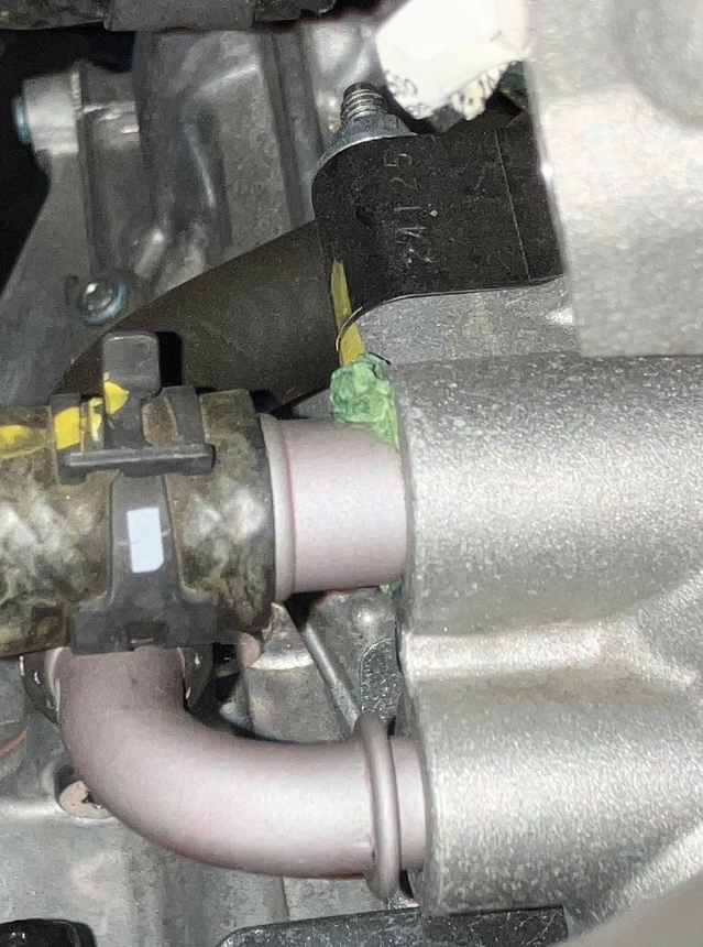

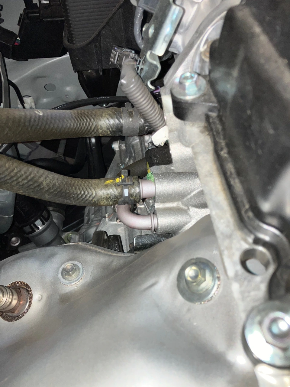

Also, there is a greenish material seeped out from a pipe junction into the back of the engine. Is this simply excess junction sealant or is this something of concern? I supplied a zoomed out image and a zoomed in image for location reference.

The green stuff is likely dried coolant. I would show it to dealer service department and see what they say, get it on record. It's certainly not normal to see any kind of a leak there, where flange for coolant hose enters the enging block.
I'm going to assume that the coolant level was a full when the vehicle was constructed. We recently discovered that the level at the LOW line of the res. I topped it off and it literally only took a splash to do that.

It seems that a great many CX-5's are shipped with the coolant level on the low side, mine was. Along with the rear differential, but that's another story.
What coolant did you use to top off the coolant reservoir? I certainly hope that you used Mazda FL22? If you did not, in my opinion, you made a mistake.
As for the green stuff in your pics. Is it hard, as in some sort of sealant, or can it be wiped off, as in leaked coolant? It looks like sealant in the pic, to me at least.

It's definitely dried coolant. Crusty. I removed a piece and crumbled it between my fingers. We will take it in to Mazda for a look see.
