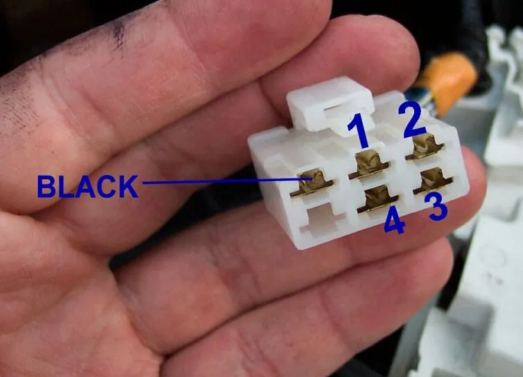

Thanks for the INTEL. I have to turn to 4 and then slowly turn to 3 and then wiggle/turn for 2. Only 1 and 4 are trouble-free.
Edit: I Just Added A Pic With The Pinout Showing Which Wire Controls Which Speed... This May Help You Isolate The Problem Wire...

cool let me know if it works. sh!t i took a look at mine and it looks melted..... boo. hopefully theres something tha can be done cuz its fricken hot.
I may look into doing this. Where does the resister pack go just in case I have to go that route?

Also, I was lazy haha. I just pulled the face plate out as far as i could and unplugged the center switch and did it from there. I didn't remove the front face plate completely.
After I put it all back together, I asked myself...did i have to remove the 2 metal cables that control the vent opening and hot/cold ratio?
not necessarily, but removing them helps to give u more access to the harness...
i was having trouble popping each metal contact out of the harness so i ended up just taking a q-tip with rubbing alcohol on it and cleaning the tips as much as possible...then i would use the pliers to squeeze the contacts as much as possible...works fine that way too
