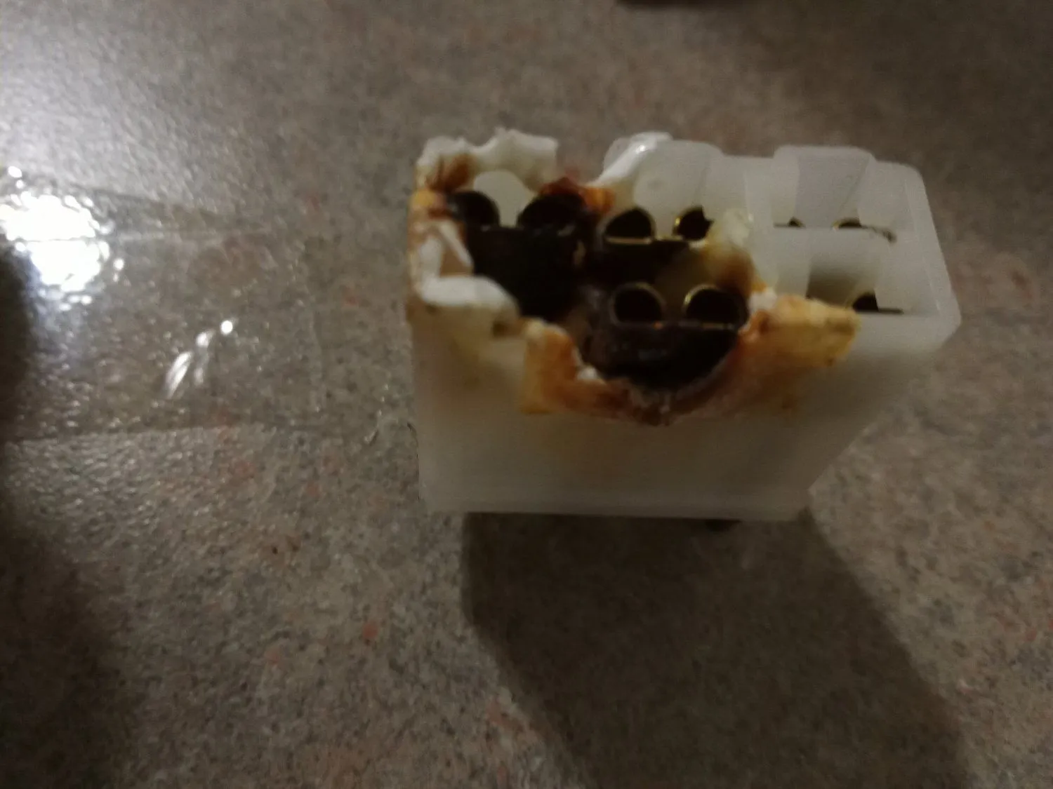

I bought my 02 Protege5 last year and have had this exact problem (AC works only on 1, fan still blows on 2,3 &4 but no AC or AC light) ever since. Almost bought a new switch then found this forum thread. I used a precision screwdriver (tiny kind to fix eyeglasses etc.) to pop the tabs for wires 1-4, crimped them down and plugged them back in. BOOM ice-cold AC on #4 !!!
I created this account just to thank all of you for the help!! If the problem reappears I will try a more permanent electrical solution like soldering.
Update: I found this old thing in the glove compartment so it's already been replaced before.
