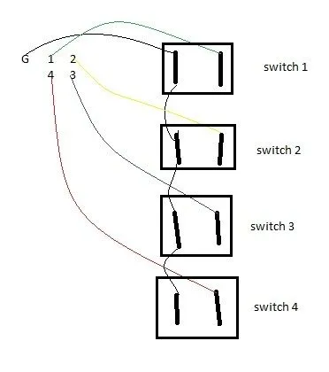

I finally fixed my blinking A/C problem for good. It's ghetto looking, but it works on all 4 fan speeds. I wired four normal house light switches into the fan control harness.
______
|G|1|2|
|*|4|3|
I attached a wire to connector G (about a foot long) and ran it to 1 post on each light switch in series (the wire runs from switch 1 to 2 to 3 to 4 where it then doesn't run to anything else) . Next i ran a wire(about 6 inches each) from connectors 1-4 to each light switch 1-4 one wire for each switch(attached to the second post on each light switch).
When i flip the switch attached to G and 1, i get A/C and fan speed 1.
When i flip the switch attached to G and 2, i only get fan speed 2, with no A/C... However, i when i flip G to 1 and G to 2 on i get fan speed 2 with A/C.
When i flip switches g1 and g3 i get fan speed 3 with A/C.
when i flip swiches g1 and g4 i get fan speed 4 with A/C.

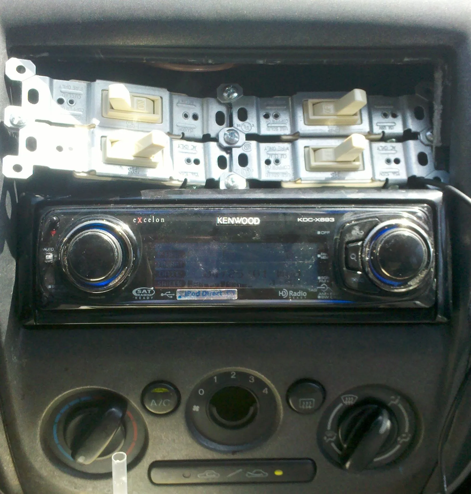

Here's the picture of my ghetto rig. I'll probably put something better looking in at some point, but this has sovled the A/C problems i've had for almost 4 years. (blinking light, compressor not staying on, etc.)
Props for the creativity, but that picture belongs on "there I fixed it"
I have already submitted it to them. However, 100+ degree heat(with A/C only working on fan speed 1) makes me do crazy things.
Maybe i can get an award for cheapest fix? $.79 for each light switch plus the cost a yard of wire. i think i came in under $5. My wife was yelling at me as i assembled everying at the dining room table. ("you're gonna kill yourself and set your car on fire!!!!")

Well, you are correct sir. I just installed a manual switch on each fan speed that can be turned on and off. If the swich for fan speed 1 is on, all other fan speeds work with AC.
Uh, "1 post"? That light switch has two connectors, and the ground one is almost certainly electrically connected to the exposed metal parts of the switch visible in the picture. Wire those switches blower side to ground post and it would still switch the same, but it might get pretty exciting if a ground ever got near that metal. I don't think you did that because it would probably have already arced if it was wired that way. Just to be clear, if this is wired backwards there would be an exposed contact at 12V that could easily source 10A if shorted to ground.
Each light switch has two "posts" that are attached to a plastic box behind what you can see in the picture. they screw down into a plastic housing. When you put a switch into the ON position it just connects the first "post" to the second "post". I ran an insulated wire to the first "post" on each switch from G on the fan swich wiring. (post #1 on each switch can connect the wire that is connected to post #2 to G, in the same way the fan speed selector switch can) The wire is cut in such a way that the only exposed wiring is secured under the screw down "post". The metal you see in my picture does not actually touch any of the wiring, it's simply there to secure the light switches to the wall if they were to be used as intened.
EDIT: i re-read your post, the metal surrounding the switches is not connected to either "post" on the back of the switch, i tested with a multi-meter first.
Right, what I said wasn't quite right either. Current wiring codes have the exposed metal grounded. That grounding might be indirect - if the switch is wired into a metal box and that box is grounded, then the metal switch surfaces will also be grounded. The neutral and ground go back to the same point, so when measured at the switch plate/pole they appear to be shorted. This is a safety measure in case the switch fails and shorts one pole to the exposed metal (which comes out of the light switch plate on the two exposed screws). If the neutral shorts you probably couldn't tell. However, if the hot wire shorts and the switch is properly grounded it will blow the fuse, which is the desired failure mode. Much better than touching the mounting screw and the sink handle and dropping dead!
The same safety consideration applies here. Perhaps more so, since who knows what kind of shape those switches are going to be in after an accident or a spilled coke. If the hot side shorted to the metal and from there to ground the fan would start blowing. (It will not open the blower fuse as that is rated for a dead short from one side of the blower to ground == fan speed 4.) If that short happened and that metal was not grounded then it would be a shock hazard. Measure the resistance between the exposed metal on the switches and some bare metal on the chassis. If it is very low then you have effectively grounded these plates through the mounting screws. (We can't tell what it is screwed into, could be plastic, in which case those surfaces are not grounded.) If there is a large resistance then run a ground wire.
Which wire did you use? Gauge and temperature rating. The goal is to have the voltage drop through the wire <3%, preferably much less than 3%. The ground and fan speed 4 wires need to able to handle 10A continuously. The other fan speed wires handle less current because of the blower resistor.
I re-used a 16 gauge 13 amp outdoor extension cord, cut to the legnths i needed. I'm not sure what the temp rating is, but i figured if it was made for outdoor weather, bit would be better.
If you run fan speed 4 for a while does that wire or the ground wire become warm to the touch? If it does you might want to go to 14 gauge. (Unless it starts to fray the wire you used should theoretically have enough capacity.)
Wire rated for car use will withstand much higher temperatures than outdoor extension cord wire. Insulator ratings of 80C or 105C are common.
