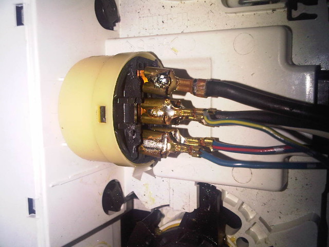

i did this today!
i did this today!
There was a reason the stock connector has nonconducting plastic between those spades. If the big black wire on top is not shorted to blue/yellow now (hard to tell in the picture) it certainly will be once some dust or other crud builds up in the tiny space between them. Or it might arc. There really should be some insulation (other than air!) around those connectors.
Also, while it may just be the picture, that looks like a cold solder joint on the top big black wire.
i'm not finished. the op used hot glue, which i plan on doing but i didnt have any at the time
That will work.
After looking at that top thick black wire more I think you definitely want to redo that one. Not only does it look like it has cold solder joint, but the clamp is on the spade at an angle. At least it looks that way in the picture.
