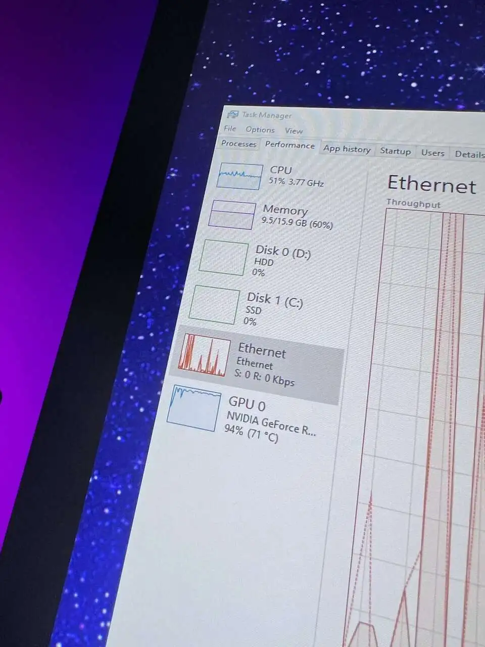

Update.....his 2060 is running 94%, 76 degrees (where it maxed) at idle on Valorant on lowest settings. He checked his fan curve and said it looked good. I told him to remove the side of the case to see if that has any effect.

Here is a pic he sent me. These are the numbers he is seeing while on the main screen. He said the idle temp of the PC is around 50 and jumps right to 60 when he opens the game. He then watches it rise to between 75 and 80.

How long have you owned and continually used a single card before upgrading? Repasting a card is usually the very first thing one should do as maintenance if the card is nearing 5 years old of use and basic things have been verified like the fans still working, dust cleaned out, etc. 76 at idle probably means that there is bad contact between the die and the cooler.
EDIT: Though see my post below, I don't think this needs to be repasted now as that pic definitely does not show the card at idle. It's at 94% utilization/load. 76C is totally normal for that.

Hmm...so that 94% means the card is at 94% utilization/load. That's not idle. That's basically nearly the complete opposite of idle.
Go to desktop, make sure no apps are running and then tell me what the temp is. 71C or 76C under an almost 100% load is normal. Just because a menu in the game is open, that's not the same as "idle". Idle really means desktop with no apps running. Might want to cancel that appt. 76C under load for the 2060 is completely normal. If you hit 88C+ while gaming, then that's definitely too hot and you'll thermal throttle. 76C? Its fine and to be expected depending on if this is the dual fan or triple fan cooler.

As you said prior to this, 74 degrees at 90%+ utilization is actually not that bad. One could even say it's pretty damn cool. I mean?!?!? Paste... this is not the problem. We are chasing an issue that... isn't an issue.

Right. I thought it was 76C with no load which is why I thought the cooler/die had a mount issue. But that's clearly not the case. There is no issue here, and definitely does not need to be repasted. In this case, I am totally agreeing with you that it is not needed now that I saw that screenshot of the card at 94% load, definitely not idle.

@7eregrine @ColoradoDriver Points duly noted. I will reach out to my son tonight to get more info. From what he told me that screen shot was taken with all other apps closed and only the main menu for the game running? I will ask him to double check and send me a screen shot with everything closed to see what those same numbers are.
