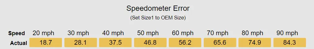

This has nothing to do with safety, but your speedometer error at 50mph will be 3.2mph.

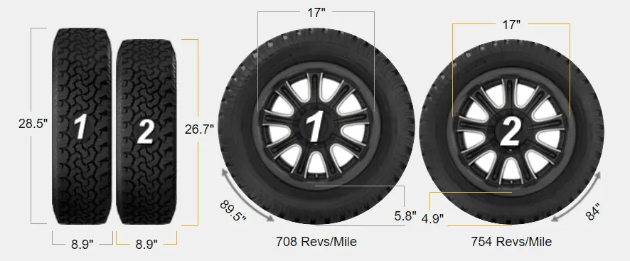

A general rule is the diameter should be within 3% of the OEM tires. Going from a 225x65 (OEM) to 225x55 on the same size of rim would be 6.6%. See the calculator here Tire Size Calculator: What Size Tires Should You Get?. IMO I wouldn’t do what you are planning.
From Les Schwab: "Our tire size calculator is for general comparison purposes only. We don’t recommend that you base sizing or purchase decisions on the calculator alone. A tire’s true physical size can vary from the dimensions provided by the tire manufacturer, and this tool does not take into account other important application factors like load index and speed rating. These calculations (and those provided by all online tire dimension calculators) don’t account for these variations." I'm good.
