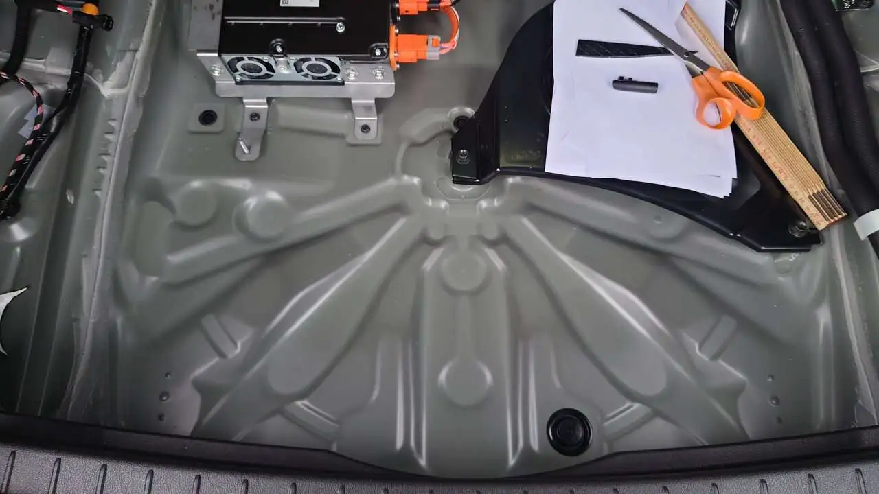

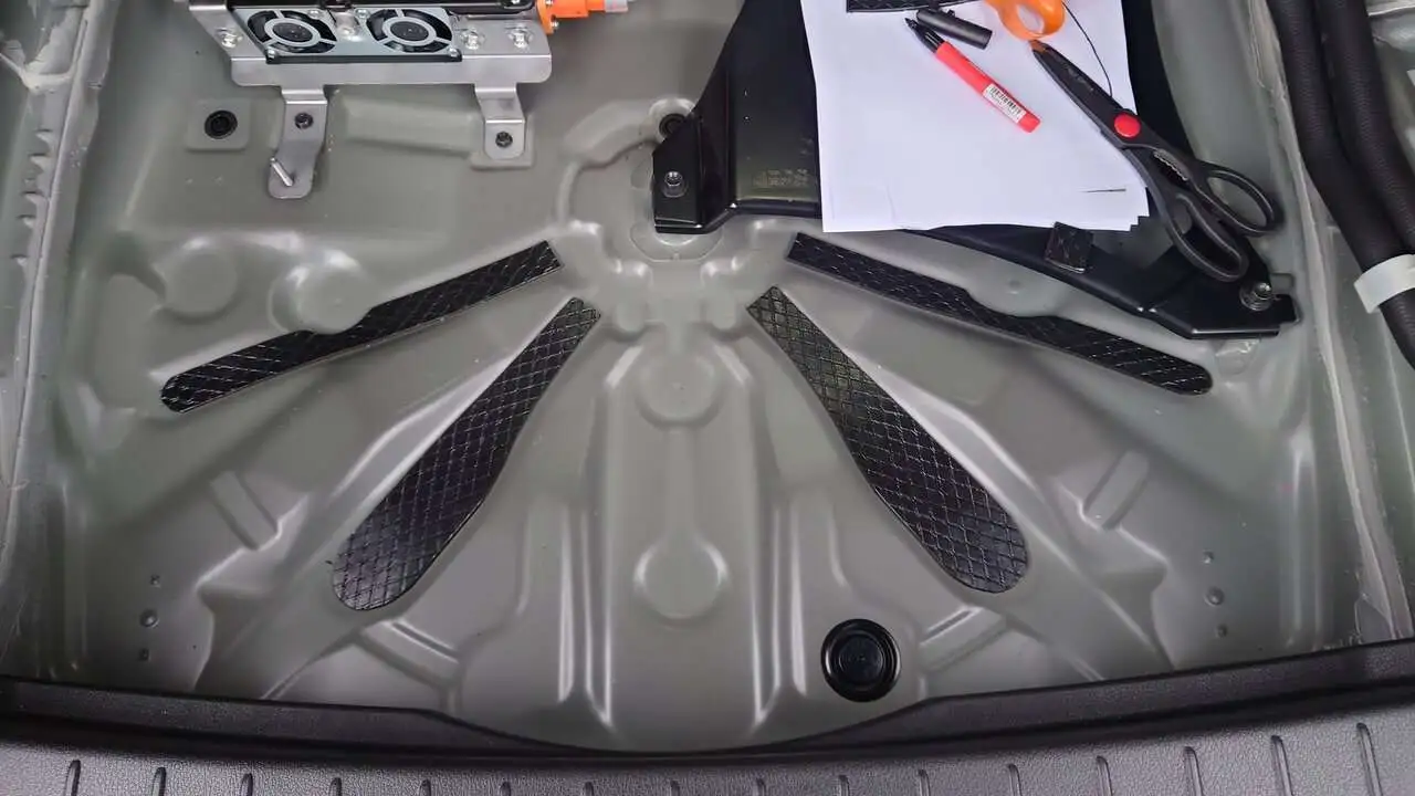

Small tip to remove resonance (barrel sound) from the trunk, remove the foam and subwoofer, and hit the bottom of the car with your knuckles, it sounds like an empty oil drum, the solution is self-adhesive bitumen, the sound from the sub becomes much better, and other noise from wheels etc disappears.
View attachment 314783View attachment 314784
Was there a specific reason for just doing those small parts or did you do more after the photo?
This is something i'll definitely do so thanks for the heads up! but I would was thinking of using a full sound insulation membrane?
After searching a bit, I found the undamped base plate, it played together with subwoofer at deep bass tones, according to the picture, I only put dampers in the 4 round points in the middle and left of the picture, muffled wheel noise is an added bonus, I didn't do it all the way through the bottom as the foam board comes up too high as it sits on the high areas, mine dampers do the job perfectly so i have no need for more.
Ah gotchya, thanks.
I'm definitely all for reducing some of that wheel roar, the sub increase will be a welcome addition, thanks for the advice!

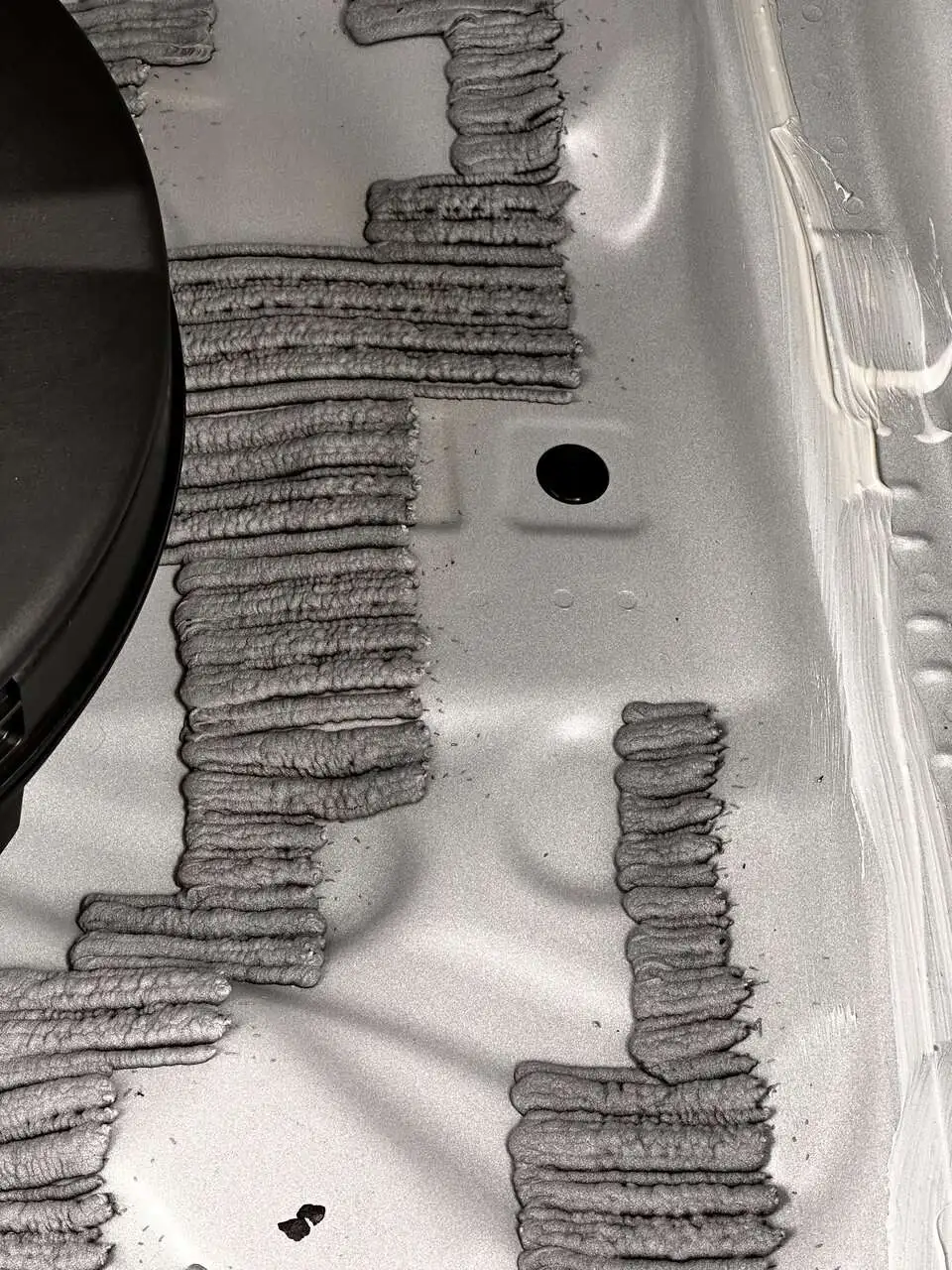

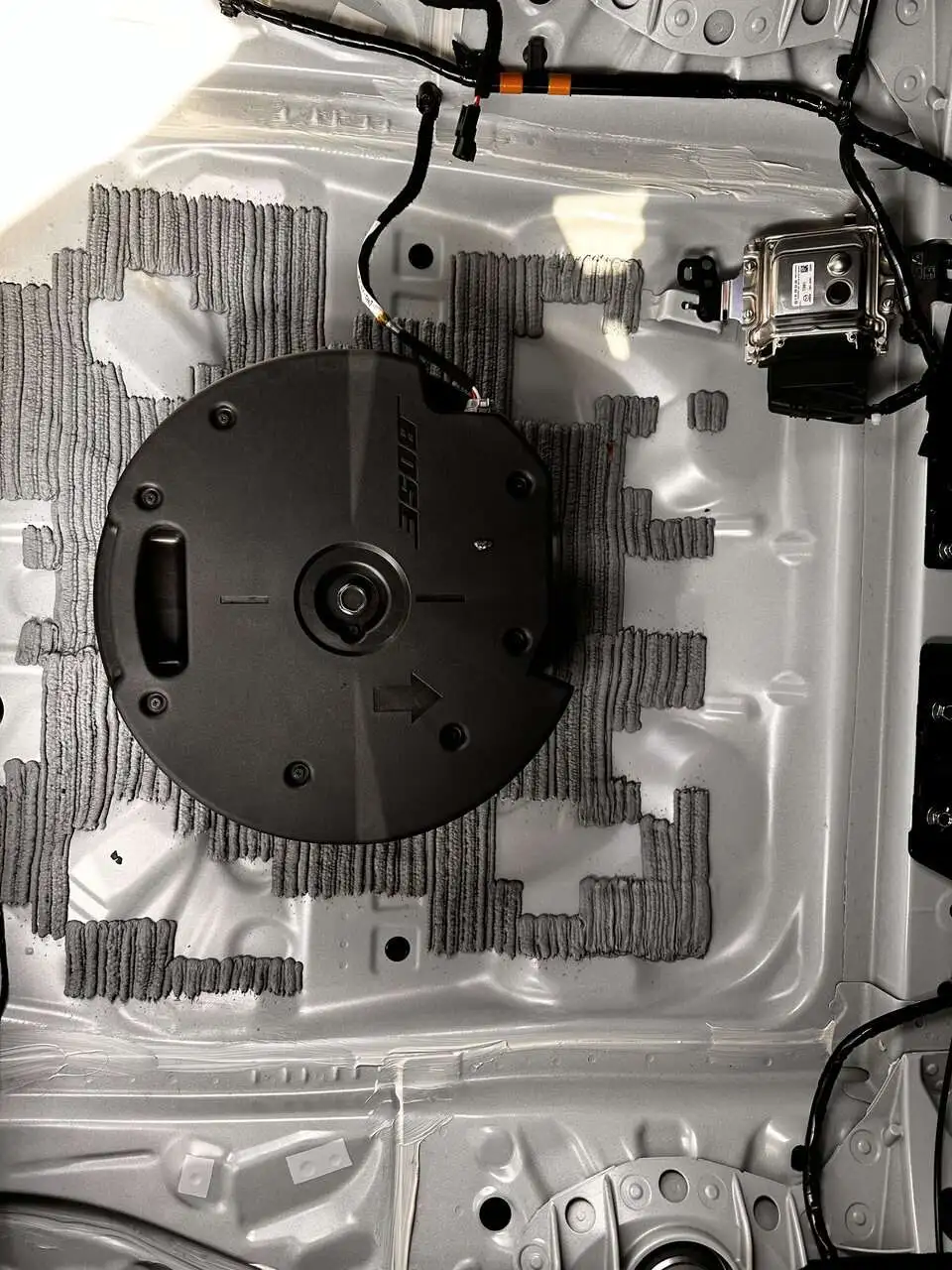

Bonjour de France !
Propriétaire d'un CX-60 depuis fin mars, je regarde ce forum depuis la commande du véhicule.
A ma grande surprise aujourd'hui, j'ai ouvert le coffre et découvert ceci en image :
( cx-60 D254cv commandé en septembre 2022 et livré fin mars 2023 )
Hello from France !
Owner of a CX-60 since the end of March, I have been watching this forum since ordering the vehicle.
To my great surprise today, I opened the trunk and discovered this image:
(cx-60 D254cv ordered in September 2022 and delivered at the end of March 2023)
