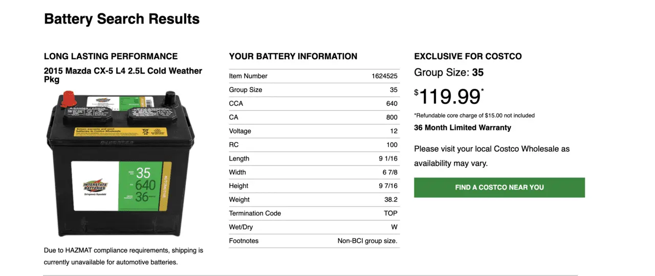

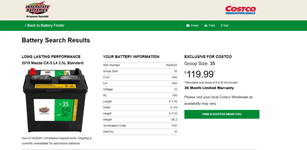

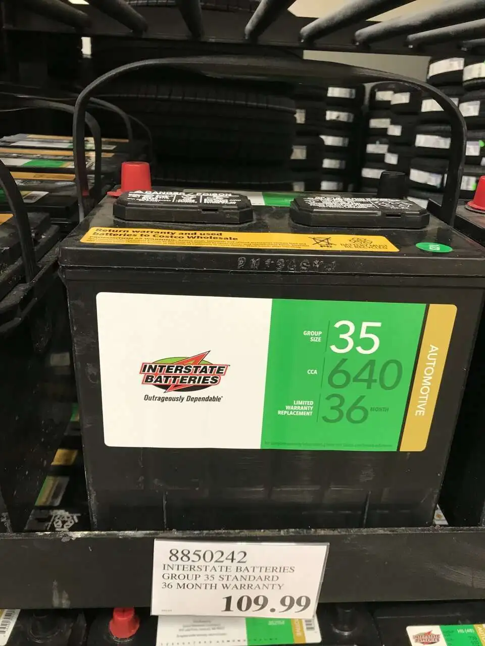

So the price for this Interstate Group 35 battery at Costo went up again now is selling for $109.99? :rolleyes::oops:🤪🤣🤬 It had been selling for $78.99 with 36-month free replacement / 60-month rotated warranty for many years until a couple of years ago.
It then went up to $109.99 with only 36-month free replacement warranty.
Now it’s $119.99 with 36-month prorated warranty.
Not sure it’s a good buy anymore! 👎

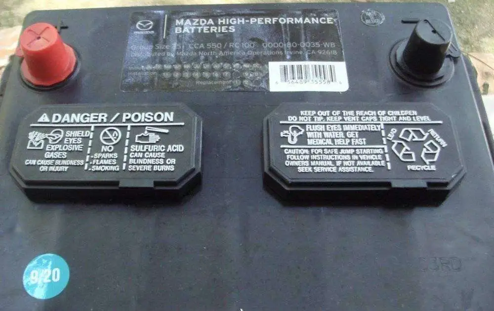

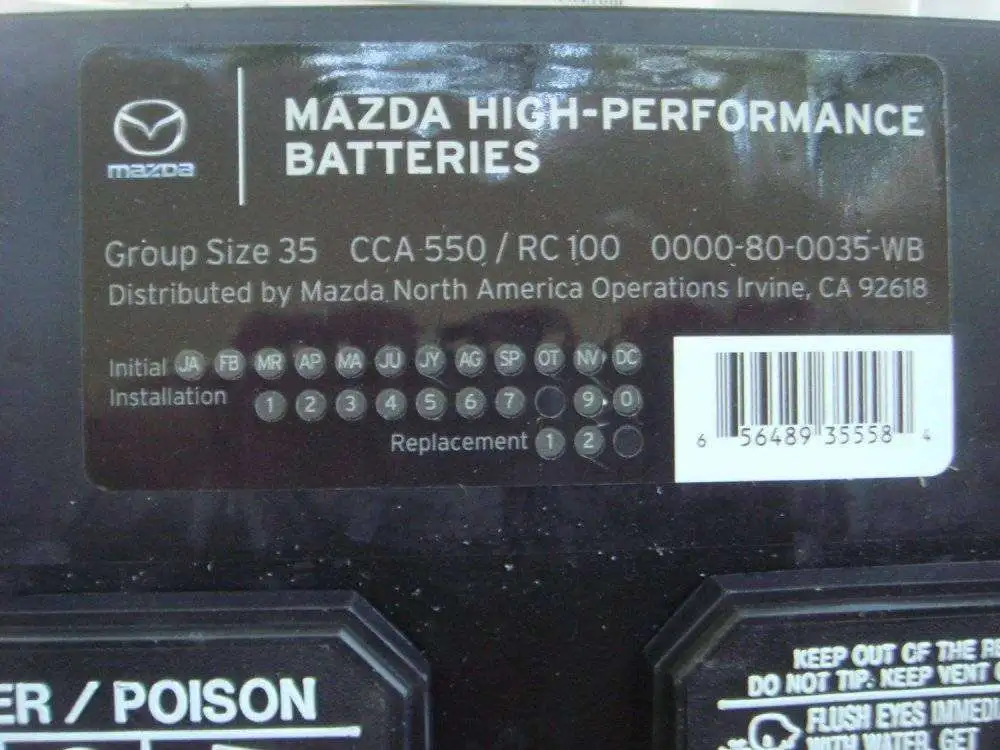

Wow, I installed a Mazda OEM
“High Performance” battery back in Oct. 2020, and it was only $120! And the warranty is 36-month replacement / 60-month prorated which is the same as Costco’s Interstate battery at the time.
I also just changed my battery as my factory Panasonic battery seemed to be weak whenever the morning temperature is getting lower and it can’t drive the EPB release properly with EPB warnings. I installed an OEM Mazda “High Performance” battery which is made by Interstate. It looks exactly the same as the Interstate battery sold at Costco which is much cheaper. The only difference is OEM battery uses black plastic case but Interstate uses white. I didn’t use any memory saver, and the only thing lost is 2 trip odometers been reset to “0”. All Favorites are there. And I reset the driver side one-touch open / close power window according to the owner’s manual. It’s a US model 2016 CX-5 GT AWD with Tech, so no i-stop and i-Eloop which require special deep-cycle AGM battery.

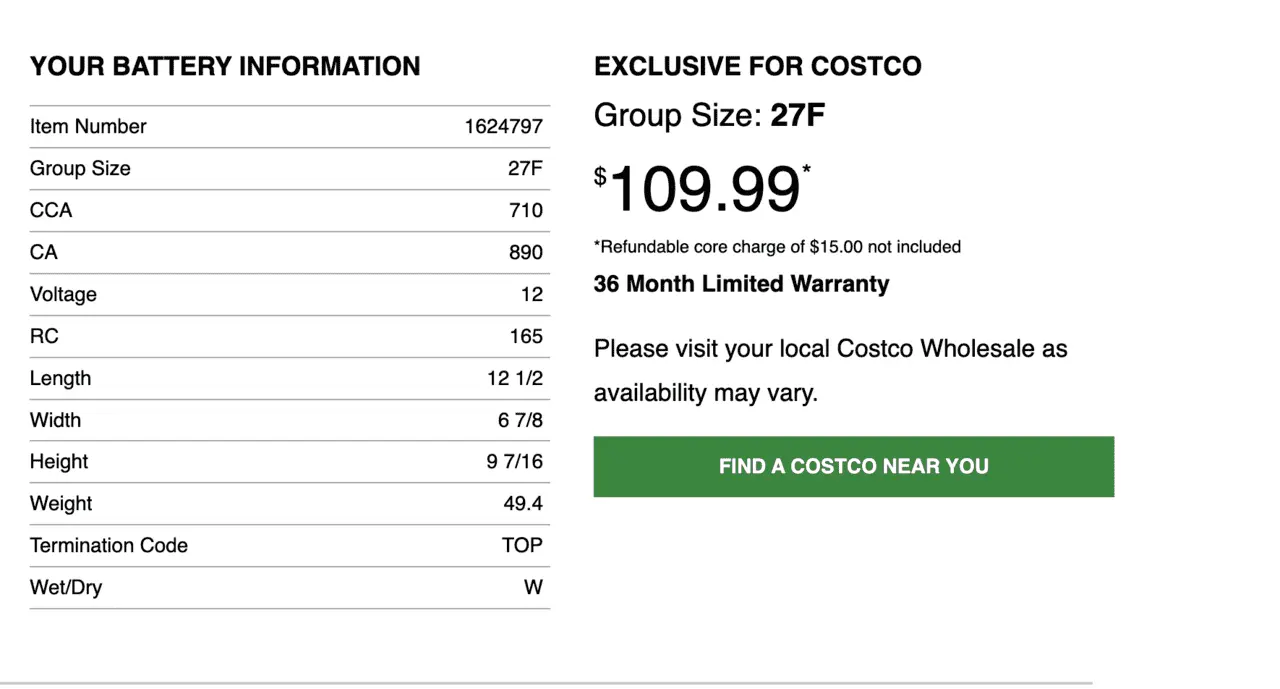

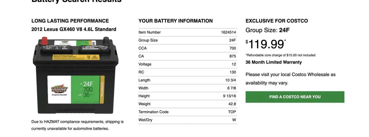

I think this was discussed before...sorry if repost... was thinking about alternate use of a 24F or 27F instead of the group 35... I use a 27F in my GX 460 but it came stock with a 24F. Guess I need to measure the battery tray.

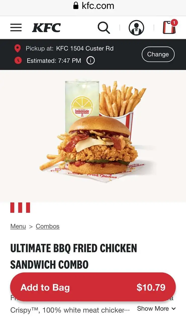

Have you visited any restaurants lately in the US? Here a KFC chicken sandwich、French fries、a soft drink are already $10.79, added a chicken tender、an ice cream, it’ll cost at least another $5, then 8.25% sales tax the total will be $16.20! This’s 3 times more expensive than the same food at KFC in Spain!

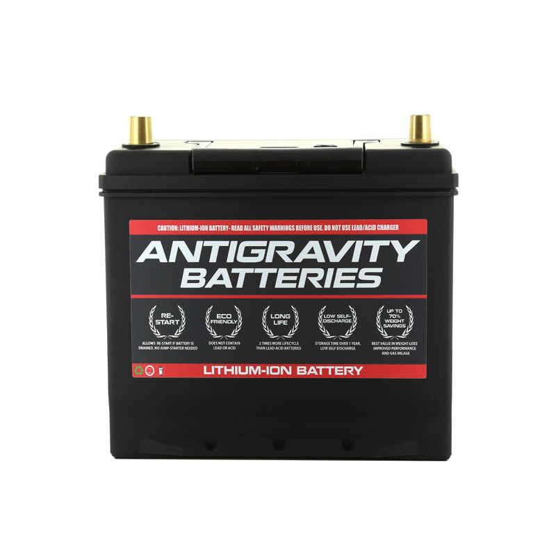

Dwight the BEST battery now is Lithium antigravity group 35 with re-start.
With a new battery at close to $200 , and the Anti gravity at $835, but lasting 3 times as long, weighing about 10 pounds and not ever being stranded with the re-start feature its my next upgrade. Just weight savings alone is mind blowing. Its why highest end Porsche and Merc trims use lithium for their ICE as to save weight.
So with the cost of 200ish every 2-3 years (short trips, loaded options) I’ll change this once instead of 3 times and have more
Consistent voltage without being stranded because of their re-start feature and its only 16 pounds and warrantied for 5 years.
Cost effective, I would go to Costco, but when mine and my wife’s runs out, Anti gravity it is.
This Lithium antigravity Group 35 / Q-85 battery could be a good alternative for those whose Mazda has I-ELOOP or i-stop and requires a special Q-85 battery. Q-85 is only available at the Mazda dealer and someone had mentioned it would cost about $400+ USD (now $600? $800?) with required re-programming.

The Anti Gravity is Group 35…..AND Q-85 battery, so its likely what most everyone Mazda will run if the make the switch for longer life lithium, better warranty, and lead acid is going up faster while lithium batteries (at least for internal combustion engines) generally are becoming more common, and coming down in price.
OK, after searching for G35 vs Q-85, performance is the only difference, so I think they are interchangeable if i-stop is not in play. Interestingly, I see a number of Lithium 35/Q-85 batteries (Dohon, PowerTex, etc)available online for half the price of that Antigravity battery.
