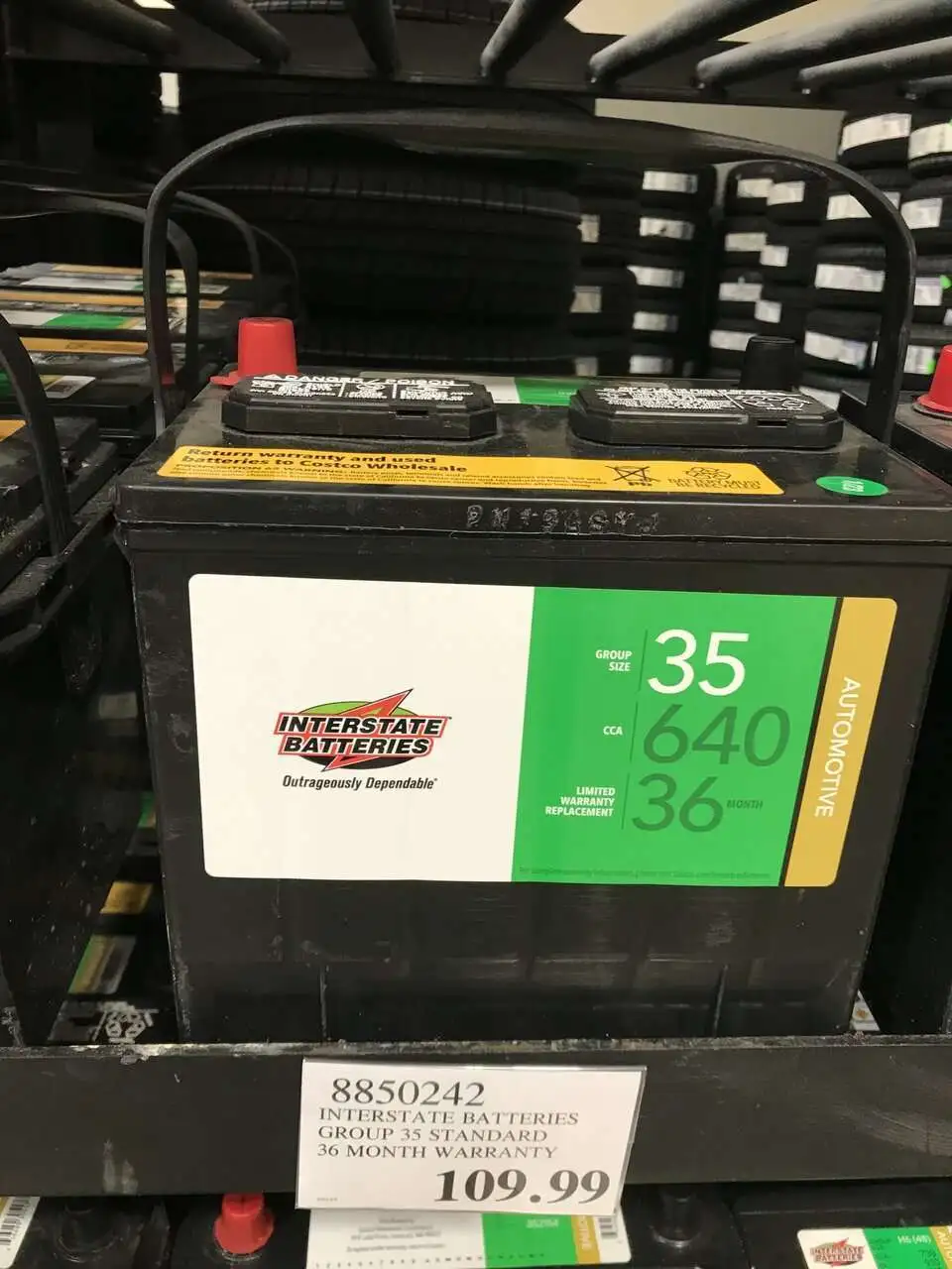

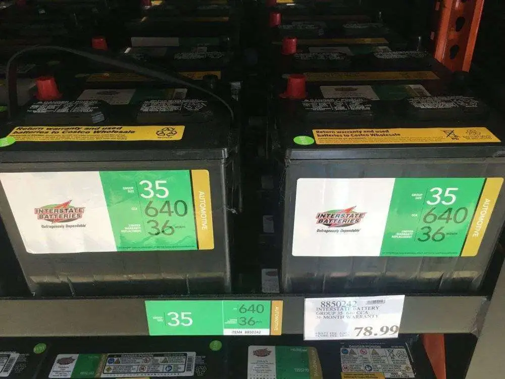

So the price for this Interstate Group 35 battery at Costo went up again now is selling for $119.99? :rolleyes::oops:🤪🤣🤬 It had been selling for $78.99 with 36-month free replacement / 60-month rotated warranty for many years until a couple of years ago.
It then went up to $109.99 with only 36-month free replacement warranty.
Now it’s $119.99 with 36-month prorated warranty.
Not sure it’s a good buy anymore! 👎
Went to my local Costco checking out the car service department on Sunday. Yes they still only do tire installation business nothing else. No oil change or battery installation. And confirmed the price for Interstate Group 35 battery went up again to $119.99. It was $109.99 in June, and $78.89 a couple of years ago! And the warranty has also downgraded to 36-month “prorated” warranty with the price increase, instead of 36-month “replacement” warranty! 👎

There’s nothing special on the battery used in your 2021 Mazda CX5 2.5L NA. Like @meow_man said above, just buy the Interstate group 35 640 CCA battery at Costco, install it by yourself, and take the old battery back waiting in the long return line to get your core charge back.
Or better yet, go to Walmart to get the EverStart Maxx group 35N 640 CCA battery for $139.84 which has better 36-month free replacement warranty and free installation. Costco’s Interstate group 35 battery now is $119.99 and it has inferior 36-month “prorated” warranty. And Costco doesn’t do battery installation for you.
