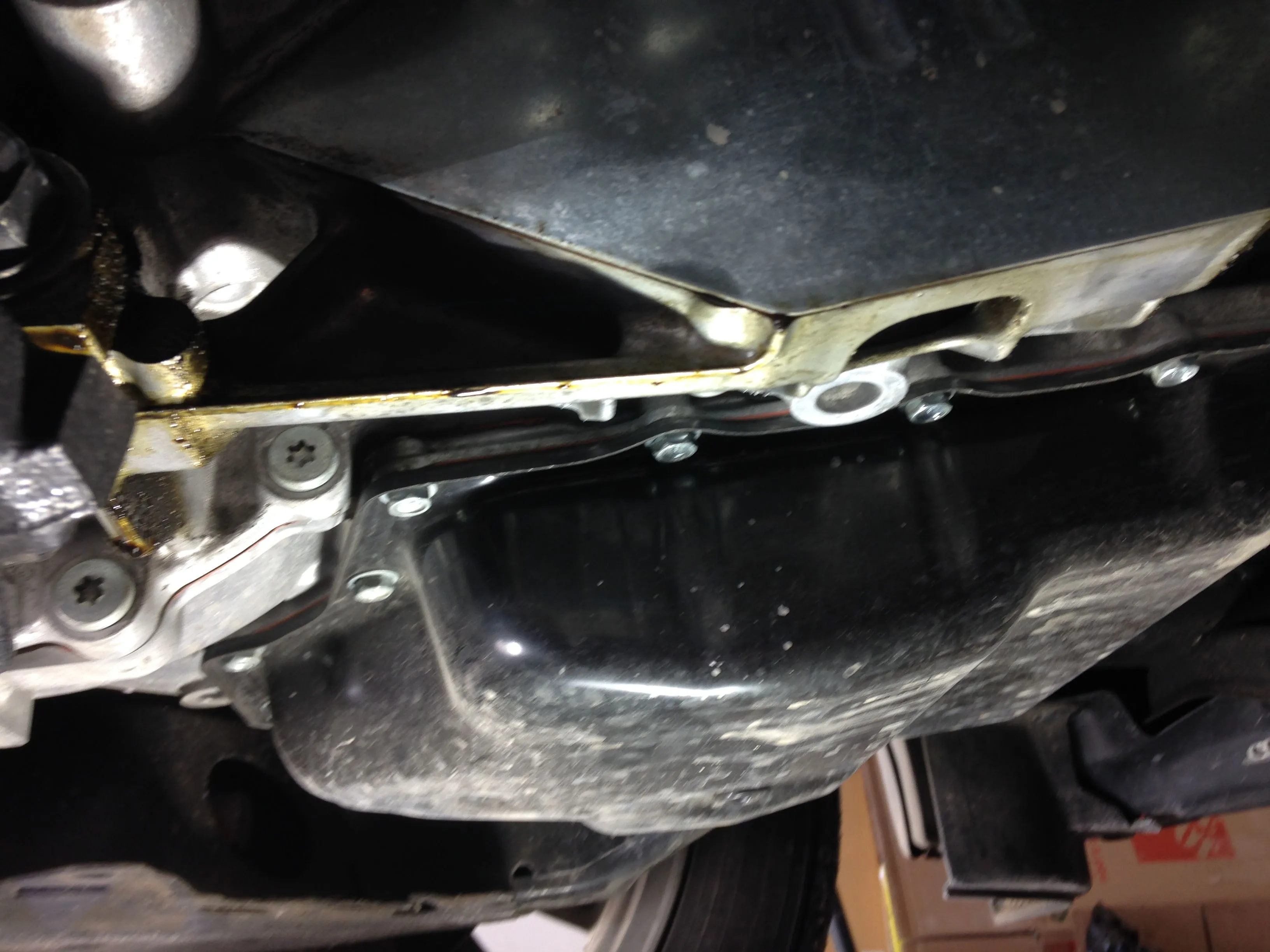

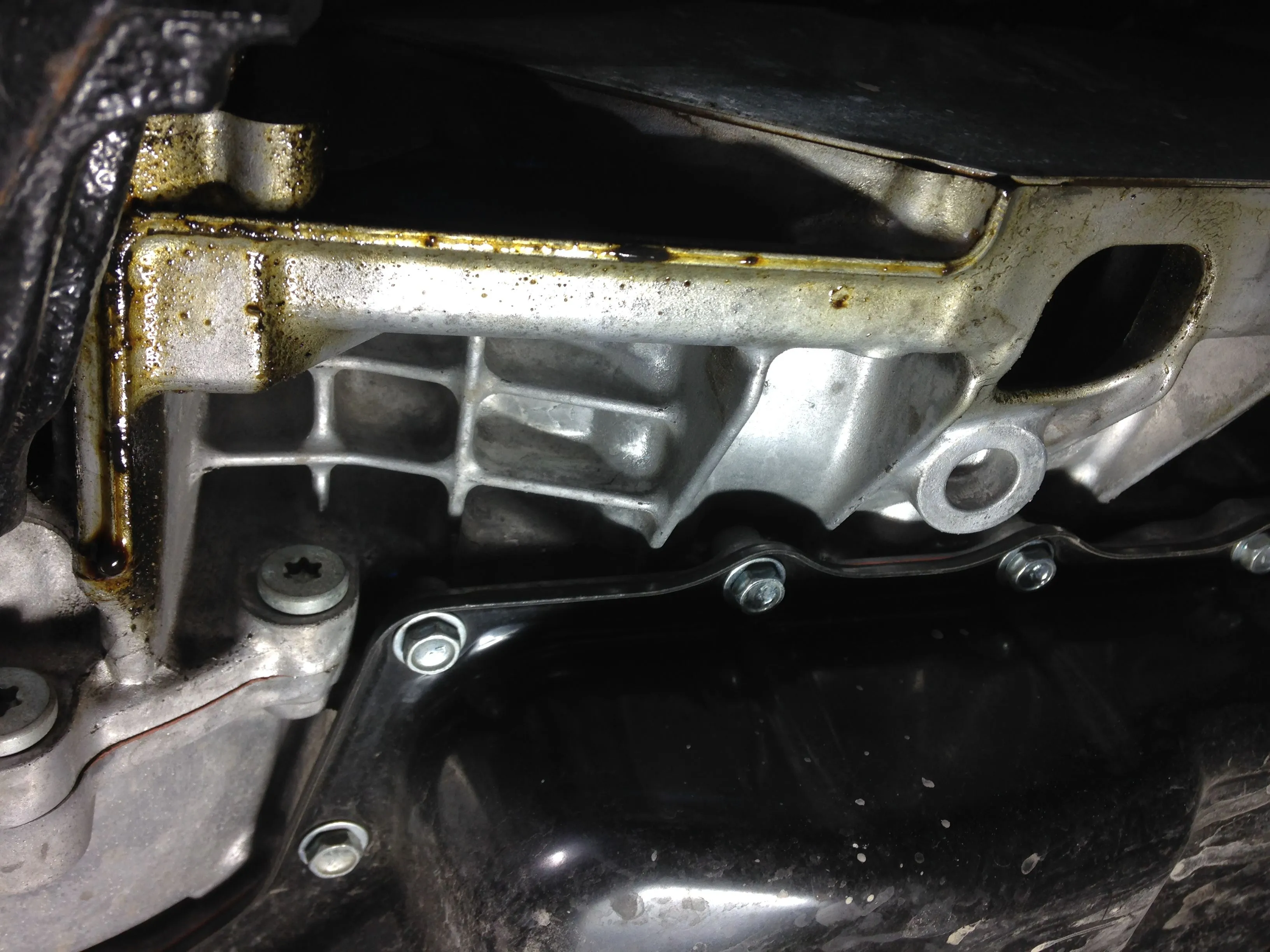

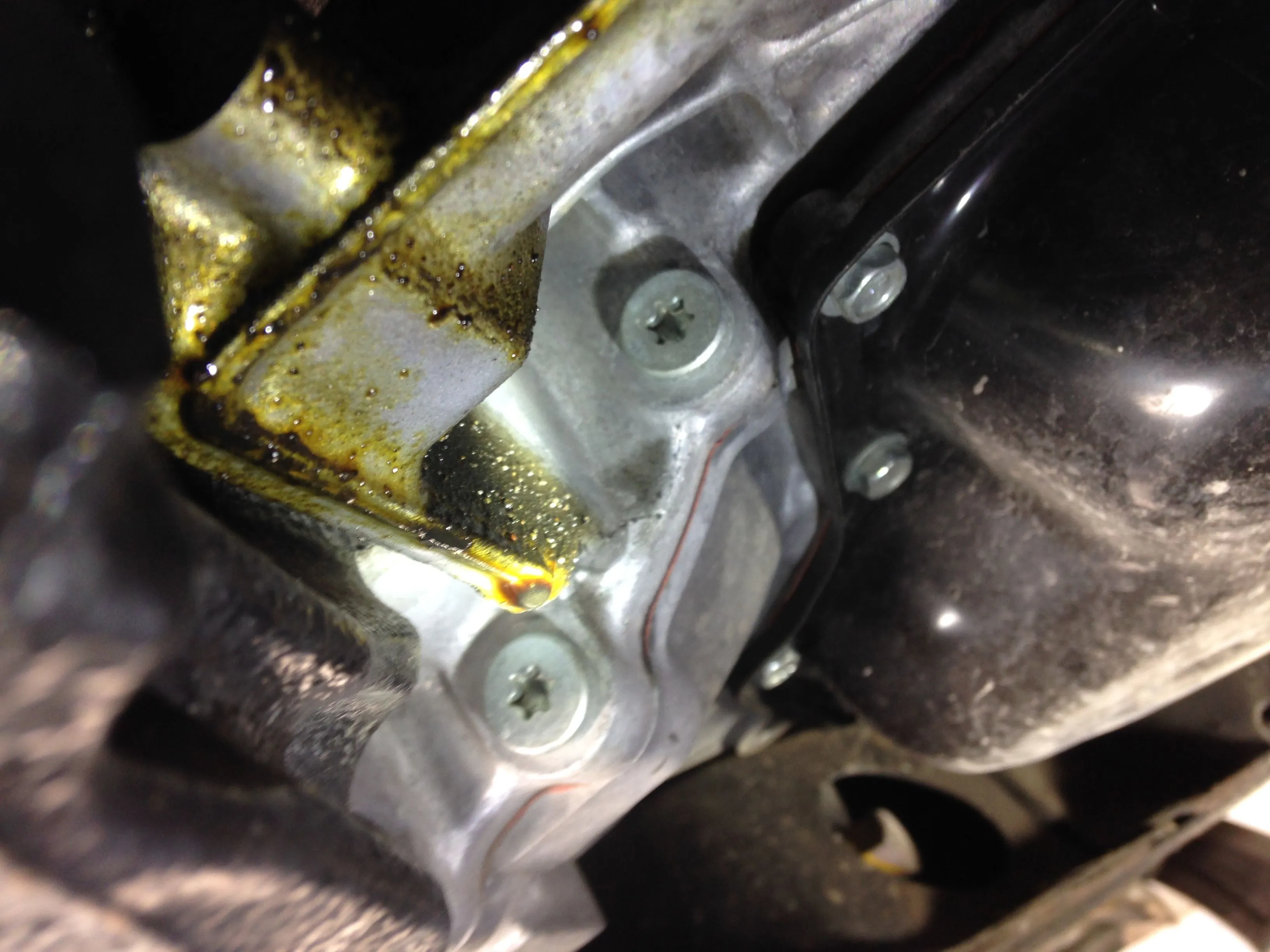

I have same oil leak issue since last year. Had it monitor for quite some time. Leak didnt get worse, but its there. After several complain,
Dealer finally decide to fix the rear main seal before my warranty runs out.
Will get the car back tomorrow they are also going to replace two of my door lock actuator since they constantly making weird noise especially when its cold out.

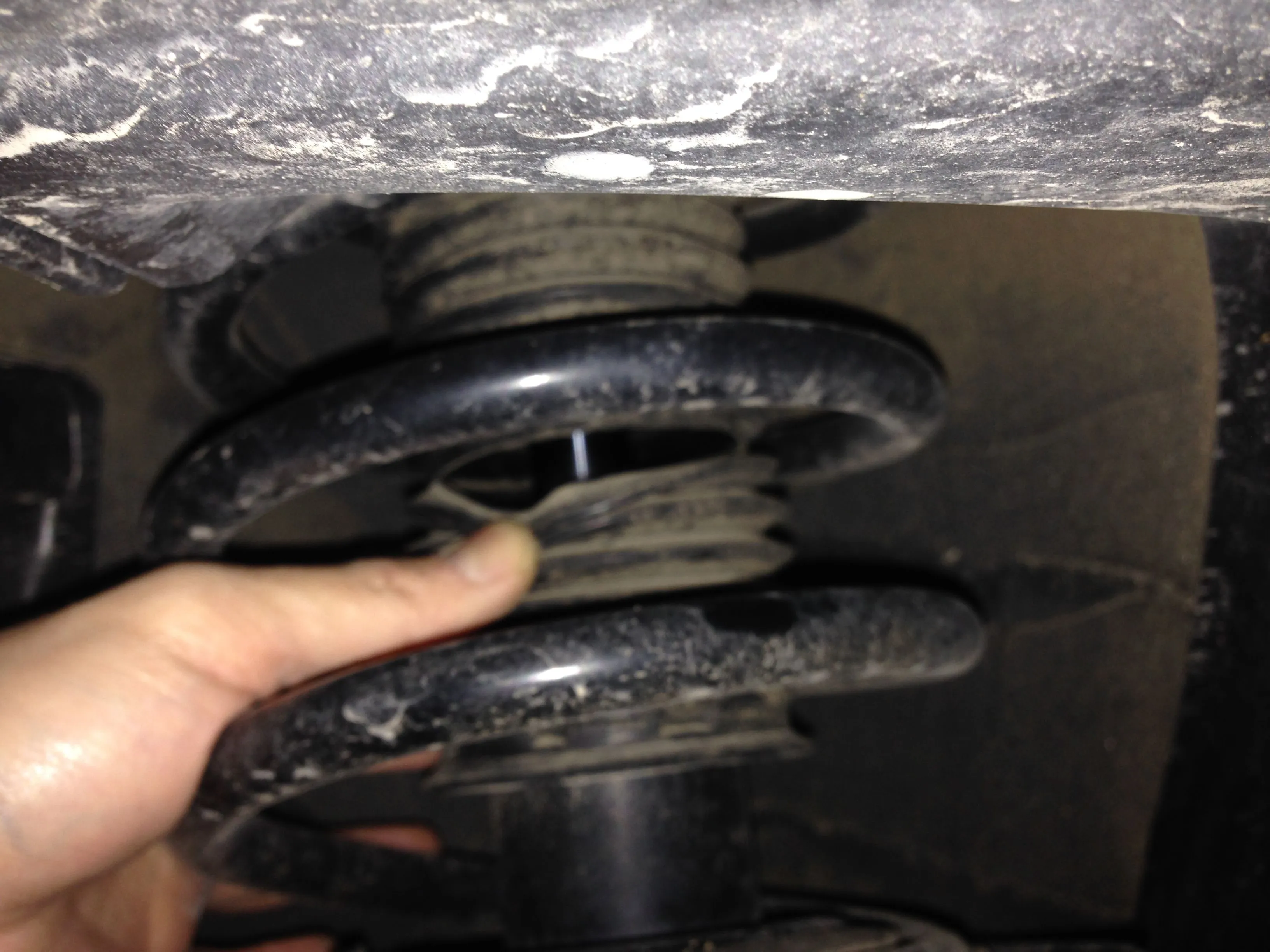

Side note, my front shock boots kept getting torn apart, I don't take the car off roading and it happen twice already. luckily its also cover under warranty. Anyone experience same issue?
I haven't look at my original seepage issue in a while. I'm gonna be changing oil again soon so will check then.
No torn shock boots on mine.

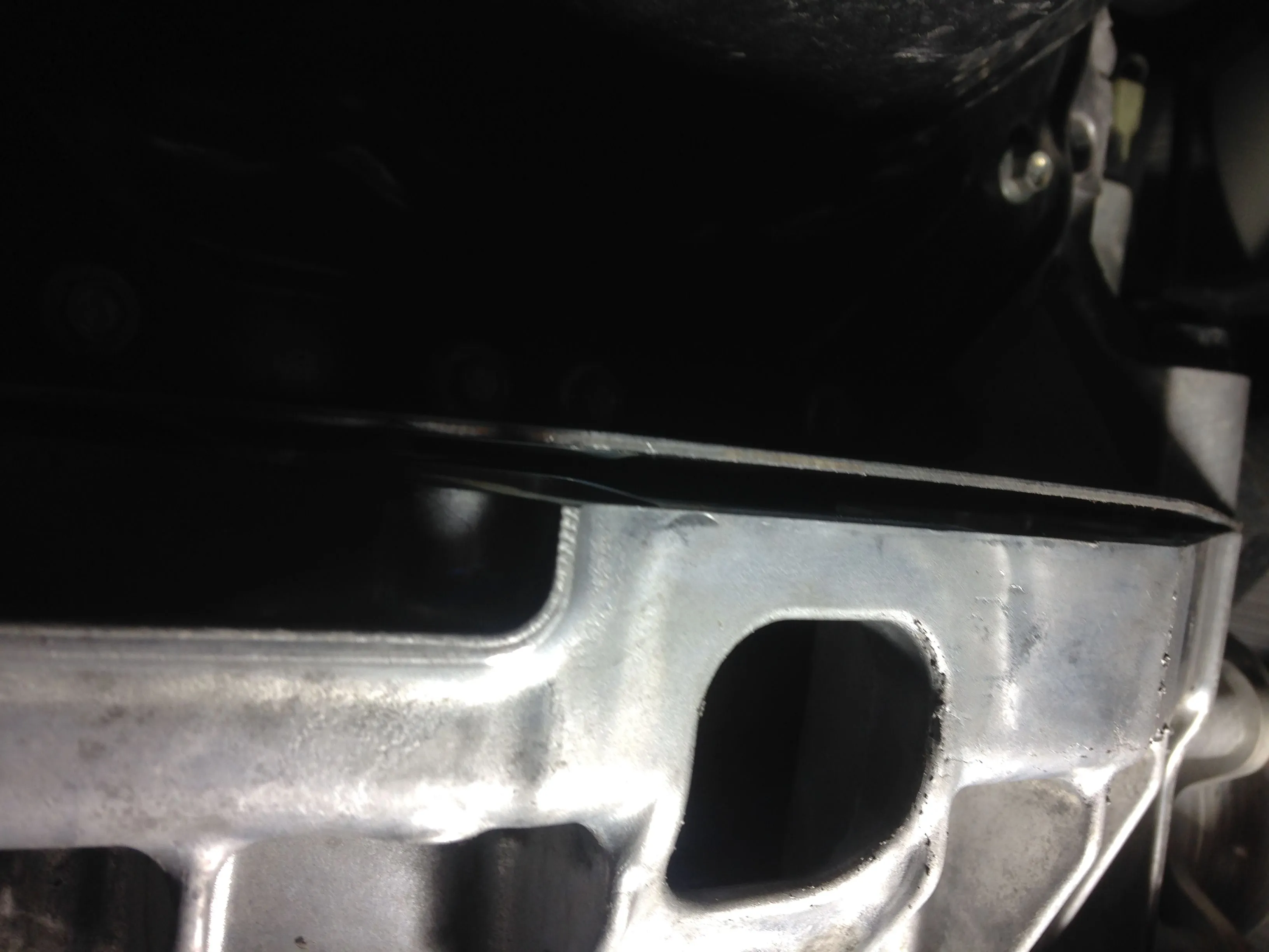

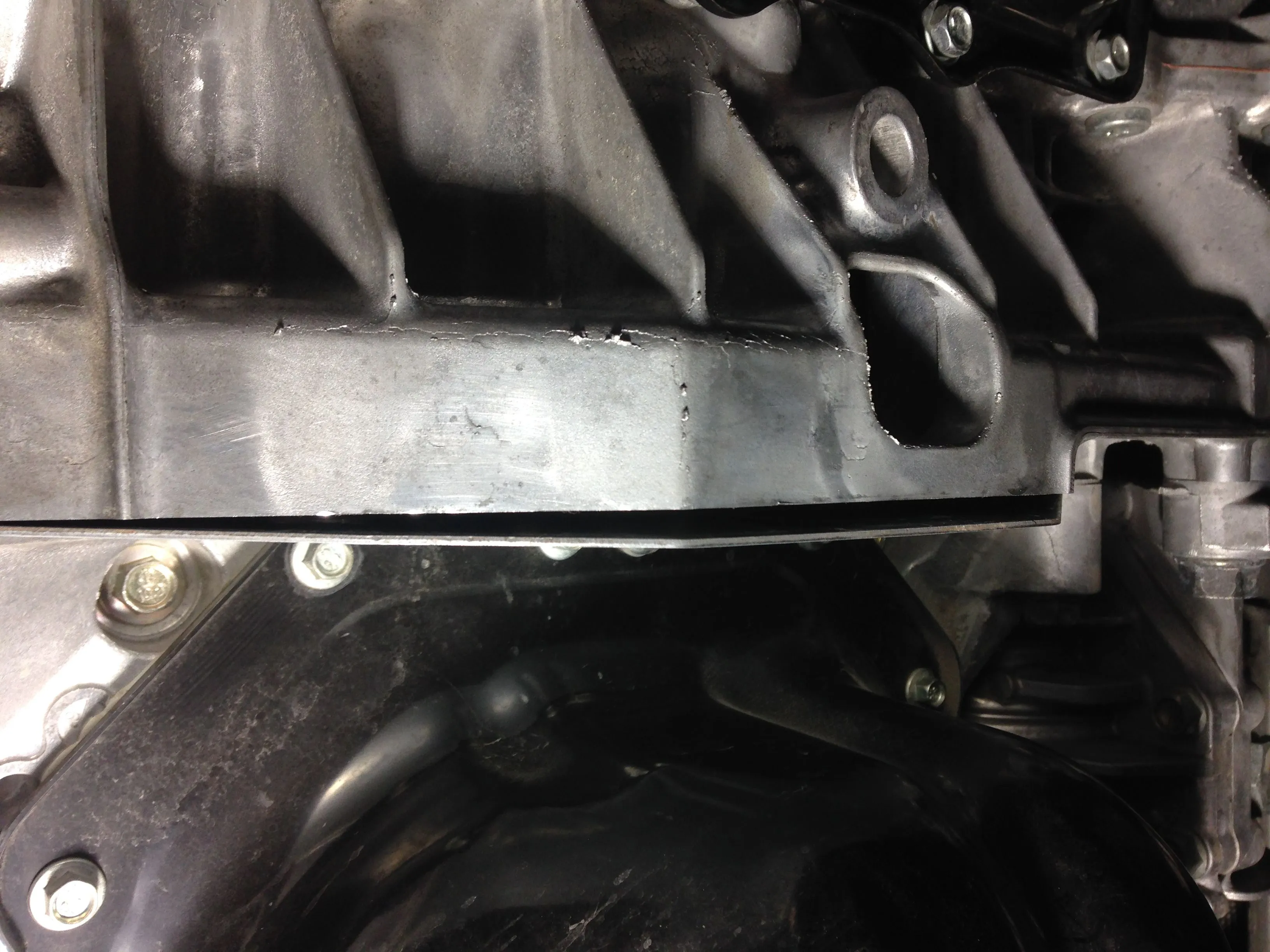

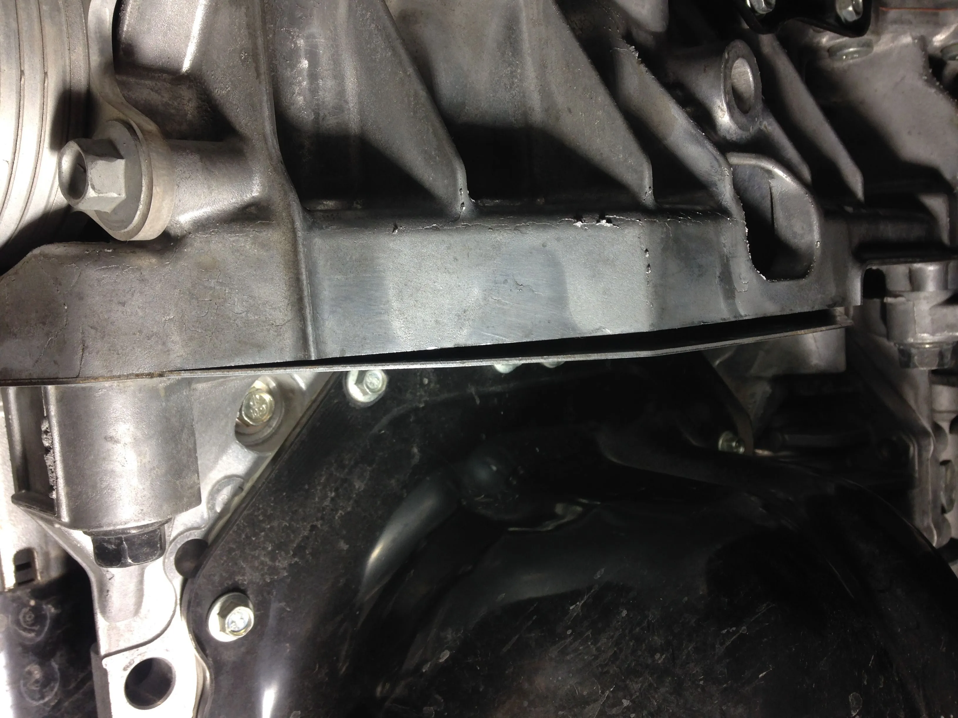

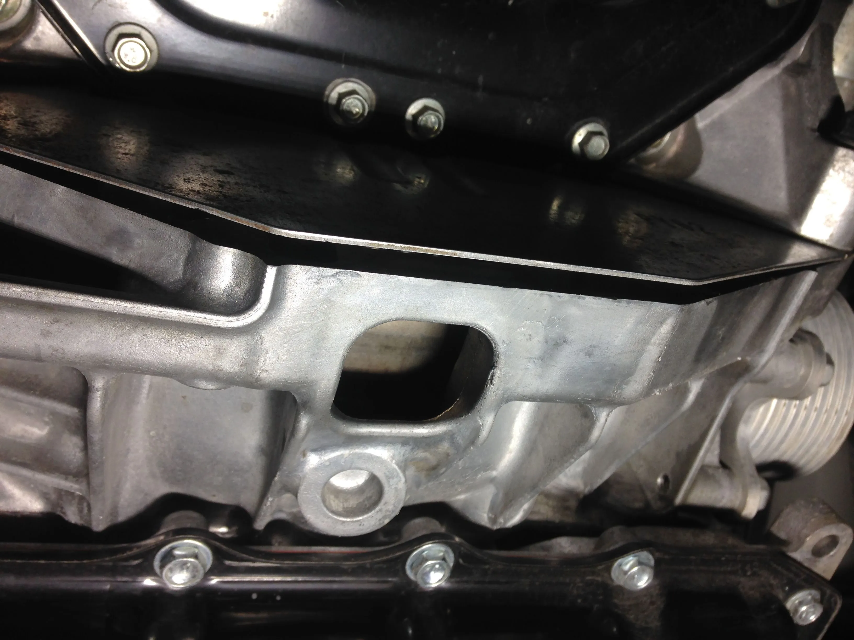

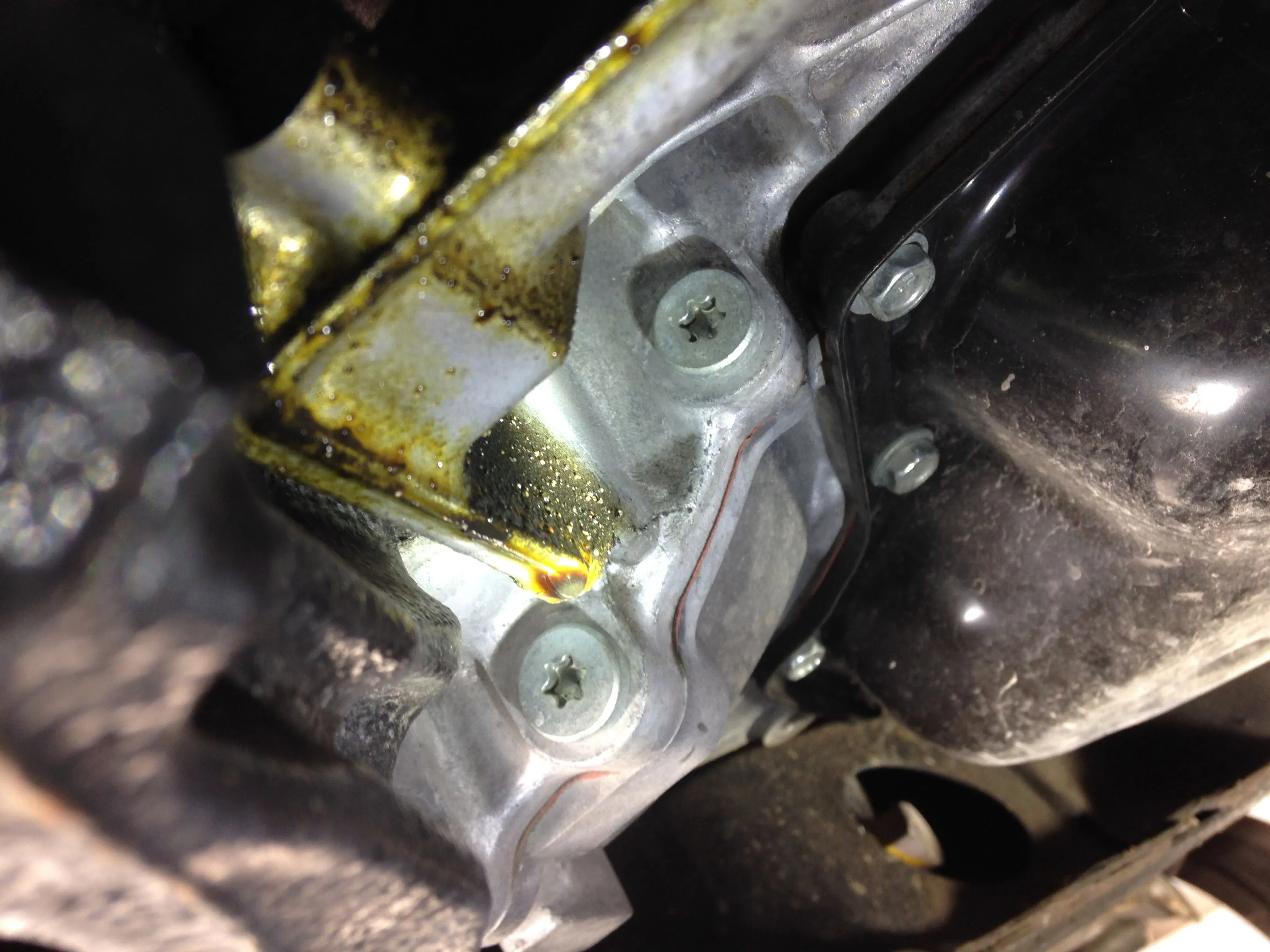

So i came back today with the car. They did not replace my rear main seal. They removed the starter and inspect the rear main seal and bell housing including engine oil pan rear sealing. Found all dry with no evidence of any leak, other than at bottom of transmission bell housing.They still couldn't give me an answer where the leak is coming from. Im getting frustrated. Was told on monday rear main seal needs to replace and today was told it's not necessary.
I started to think my dealer simply don't want to deal with this issue. The leak started last year, and I had it cleaned first time by myself, second time from the dealer. This is the 3rd time. Im getting sick of hearing "keep monitor the situation". What should i do now guys? Go different dealer? or call mazda customer relations? or wait till it get really worse?
Definitely call Customer Experience Center at Mazda North American Operations and set up a case. Tell them you're not happy about the experience of your Mazda dealer and they're enable to fix your oil leak problem. Email them all the pictures you have and make them commit fixing your oil leak problem even if your warranty expires.
By looking at your pictures your oil leak problem is worse than Kedis82ZE8's and Mazda should really do something on it!
I guess I will contact customer relation tomorrow and see what happen next. I did speak to the service manager today, but they felt like they did necessary inspection and can't not find the problem. Was told all fluid level is normal. If further inspection such as taking the tranny out would cost me thousand if no fault is discover.
I know this is an early sign of leaking but I feel like i need an answer where the leak is coming from. Maybe my dealer isn't competent enough to do the work.
The fact of matter is you have an oil leak and Mazda should fix it under warranty. Your dealer is definitely incompetent to fix the problem after 3 tries! Now they gives you all kind of excuses and even threatens you paying thousand if they can't find the leak! It's their responsibility to find leak and fix it, you should pay nothing even if taking out the transmission for inspection is necessary. Tell the rep at Mazda's Customer Experience Center about this and ask them to give you other alternatives such as going to another Mazda dealer or sending a field engineer to your dealer helping the dealer to resolve the issue!
I think my last resort is to take it to another dealership. Yes, it's still under warranty. But with all this extra work is really bothering me. Will keep you guys posted.
Today, i had a chance to speak to one of their service guy. They suspect the leak is rust proofing residue. To me its an odd spot for oil coming out between oil pan and transmission.
I had the rust proofing done back in 2014 with the dealer. It's doesn't make any sense with the oil start appearing in 2016. At this point, they had the whole area cleaned. I had a chance to revisit the worked they've done yesterday, and i was not impressed. The casing is widely open, i'm not sure if that will affect the performance. I've attached some photos before and after, let me know what you guys think.
Rustproofing??????????? You really need to go somewhere else...
