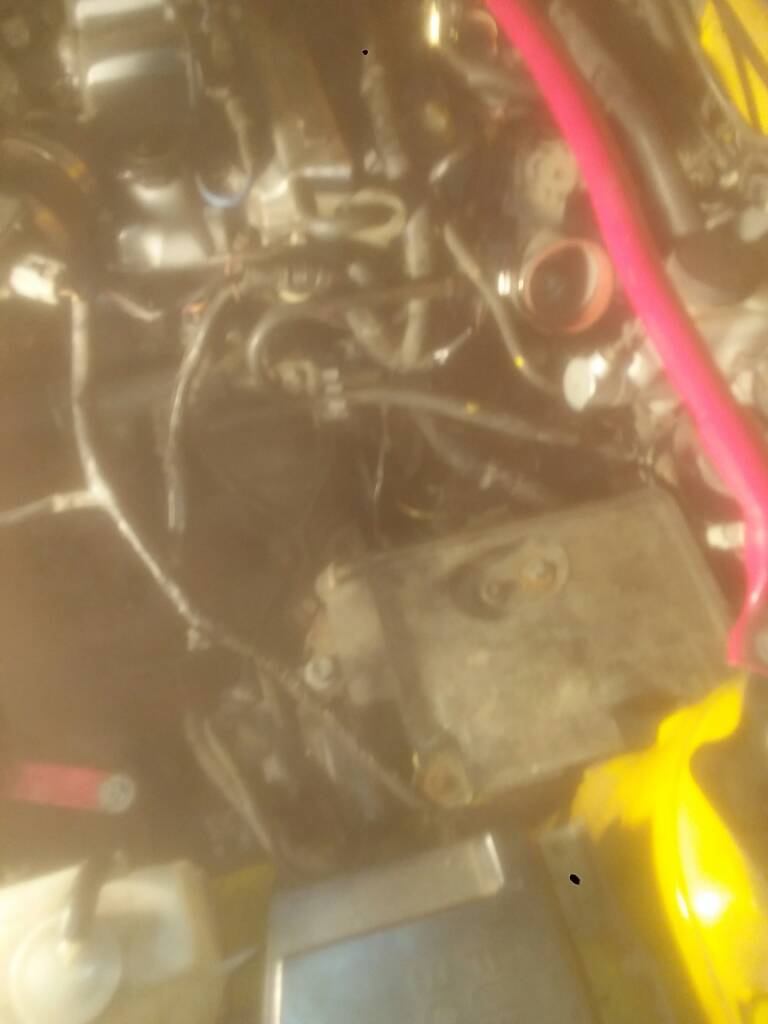

Why did I not think about this? That is a great idea man, there's no emissions in washington as of next January so none of this matters anyways whoohoo. I'm thinking about maybe deleting the egr and maybe some other stuff that I don't need. My thoughts behind this are,
1 it's not a daily driver anymore
2 it doesnt need to be street legal or pass smog
3 I hate working in the engine bay of this car

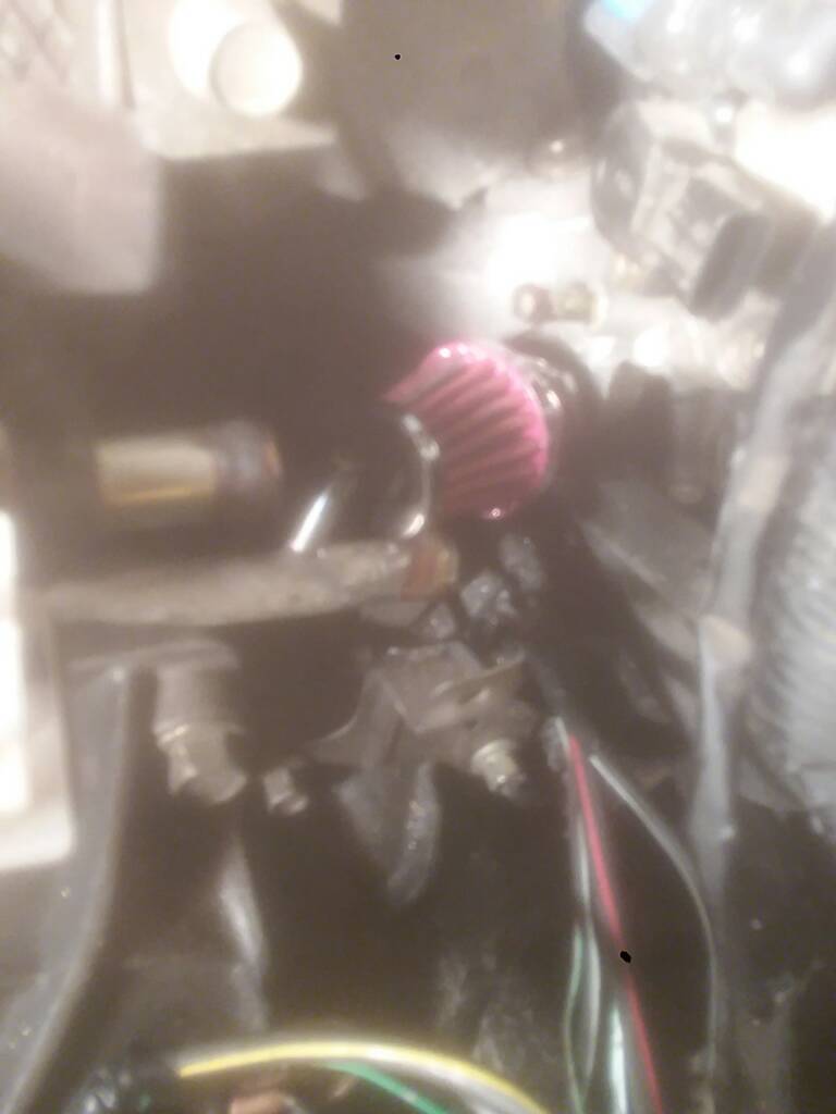

There's so many vacuum lines and little canisters and other crap that I just feel doesn't really need to be there. Personally I love older vehichles specifically because they are easy to work on. I want to make this car reliable and simple, i feel like computers do too much nowadays. Cars used to be dumb but at least they were simple and obedient. Thanks for that tip 323 I'm definitely gunna do that, just a universal baby air filter will work right? Ima just bring the pipe in with me so I get the right size
Thank you so much man, I was about to start pulling out the intake mani. At that point I might as well pull the engine haha. I'll update after a run to oreillys and autozone, I know i dropped a tiny bolt down behind the trans so I gotta fish that out and then steal a exhaust bolt from the 626 block as I guess I've been one short for 6 years haha
yeah all this talk about removing batteries, throttle bodies, and intake manifolds to change out a rear motor mount was a big turn off. pretty sure i'd create more problems removing and reinstalling my intake manifold lol. when i finally got to do it, all i took off was my intake pipe and strut bar. had enough space to get to everything luckily.
Ya I'm about at that point, add a couple split wires and a bunch of missing coolant lines and bingo. I finally got a look at the rear mount while doing this and Damn it is buried, I gotta say I really hate how over engineered this car is. I see so many easier options in other cars (like oil filter placement cough cough mazda) that it just makes me sad. When I look in my engine bay all I see is a mess of wires and vacuum lines running sporadically around the bay. Then I look at some of the threads and man your guys engine bays look soooooooo clean. I really wanna start digging into this car, I just need more space and I guess I have to rebuy half of all my tools. Damn things keep growing legs if ya know what I mean [emoji23]
I get the fram one specifically for the grip tape stuff on the end of them, my hands are always covered in oil so it really helps lol

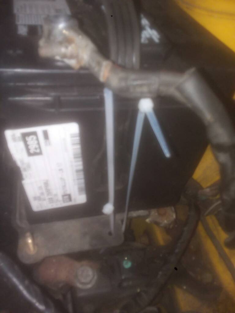

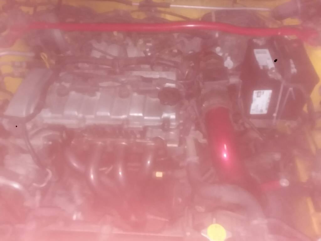

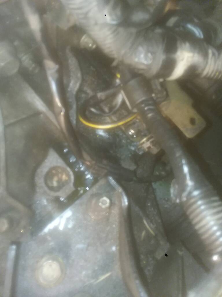

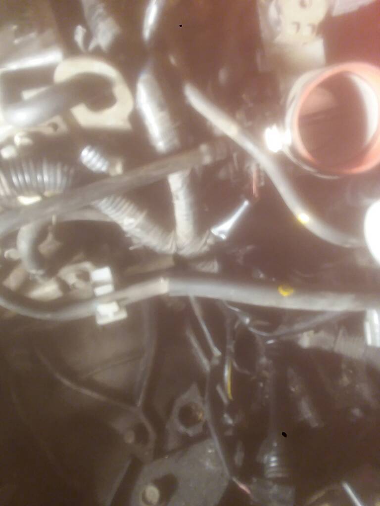

It's in!!! After a trip to ace hardware and oreillys I had everything I needed to put it all back together. I started up with patching the cut wires, got those wrapped up and started putting the baby air filter on the egr pipe stub. I had to chop it even shorter so the filter would slip past the hard pipe, it splits and has a smaller pipe run upwards to the throttle body and it is right where the filter needs to go. I managed to get it on kinda tucked behind that hard pipe, then I got all the coolant lines hooked back up. Then it was just finding a couple connectors and ziptying some stray wires that are missing their brackets (I'm very prone to breaking plastic clips and tabs lol). I got the intake back together and put in the bottom half of the battery box, I think I lost one of my battery box tie down rods so I just ziptied it in for now. The battery I got was a little bit bigger than the old one so I had to forget about using the battery box cover thingy. Putting the header on was cake after all that bullcrap, I put in some oil and antifreeze and yeller started right up. Sounds a little more raspy than I'd like but I have a big leak where the downpipe connectors to the rest of the exhaust. The donut gasket might need to be replaced, there a bit of angle on the connection so I might look into tweaking some exhaust hangers to try to get it to line up better. I just capped off the bung on the manifold with a brass cap, idk if brass was a good choice but it was all they had so that's what I went with. I'll try to get a sound clip up but it'll probably just be a YouTube link, I can't figure out this video stuff
