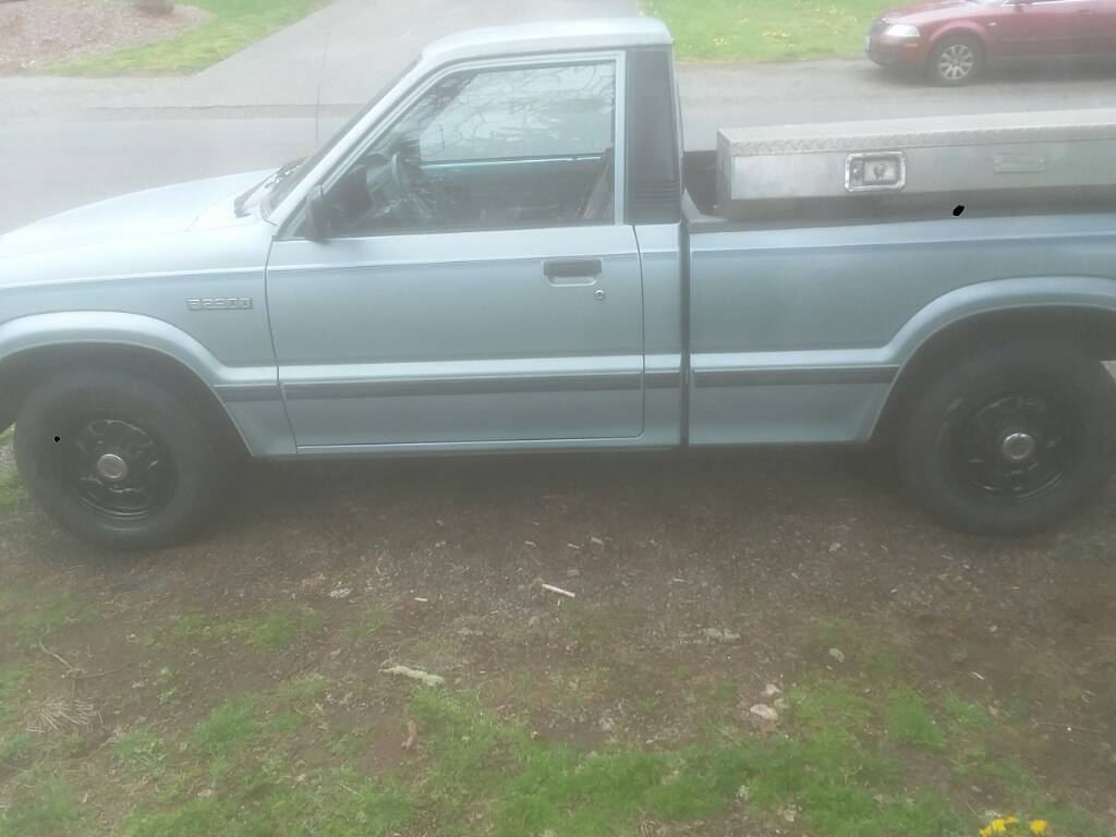

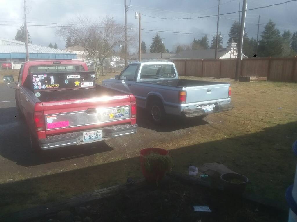

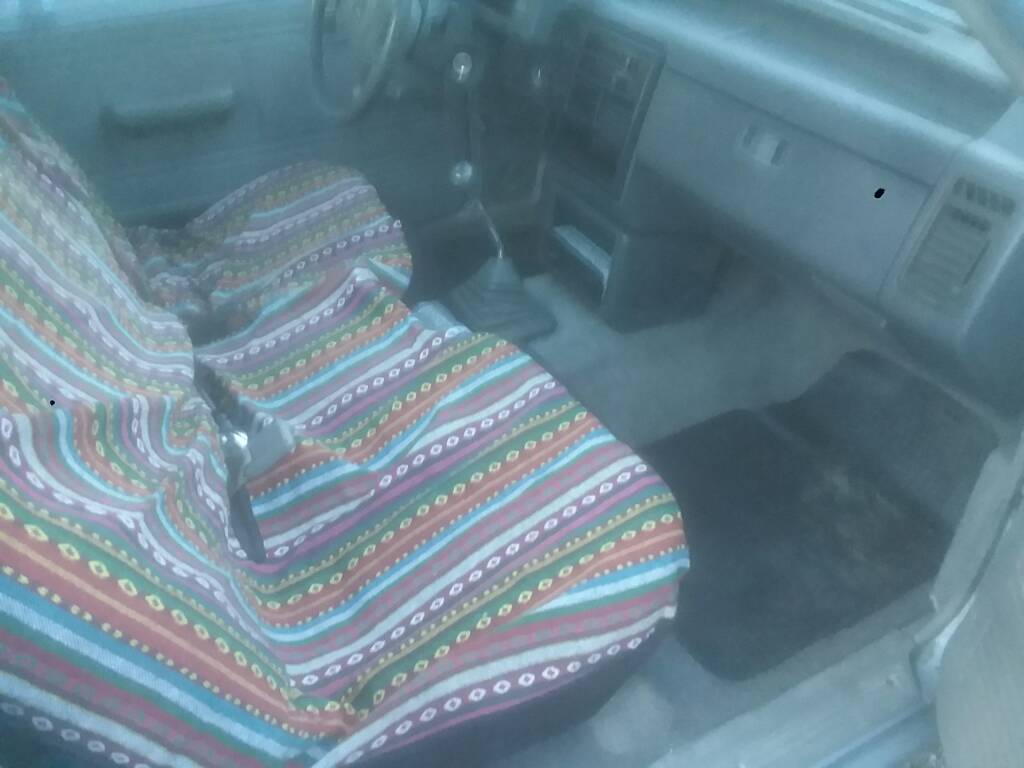

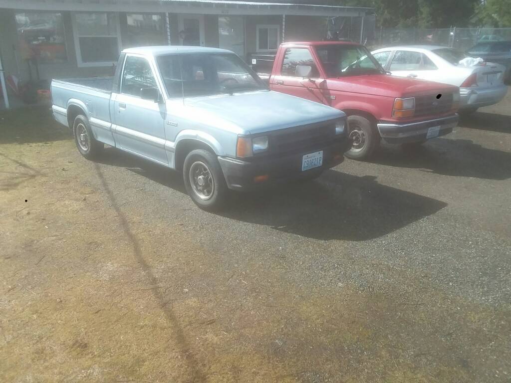

Sorry about the lack of updates, it's been a busy week. I ended up getting a 89 b2200 for work and pulled yeller off the insurance[emoji22]. This here is Tina, she needs a bit of love mostly lifters(tick like crazy) but that's where most of my cash will be going for the next month or two until she's running real good. Until then the pro5 is gunna have to sit on the back burner. Fortunately this gives me time to really dig into yeller and start finding rust and worn out parts, ima get some tall jack stands and pull the wheels off and start crawling around looking for broken s***. For now say hi to Tina the tiny ticking truck[emoji23]

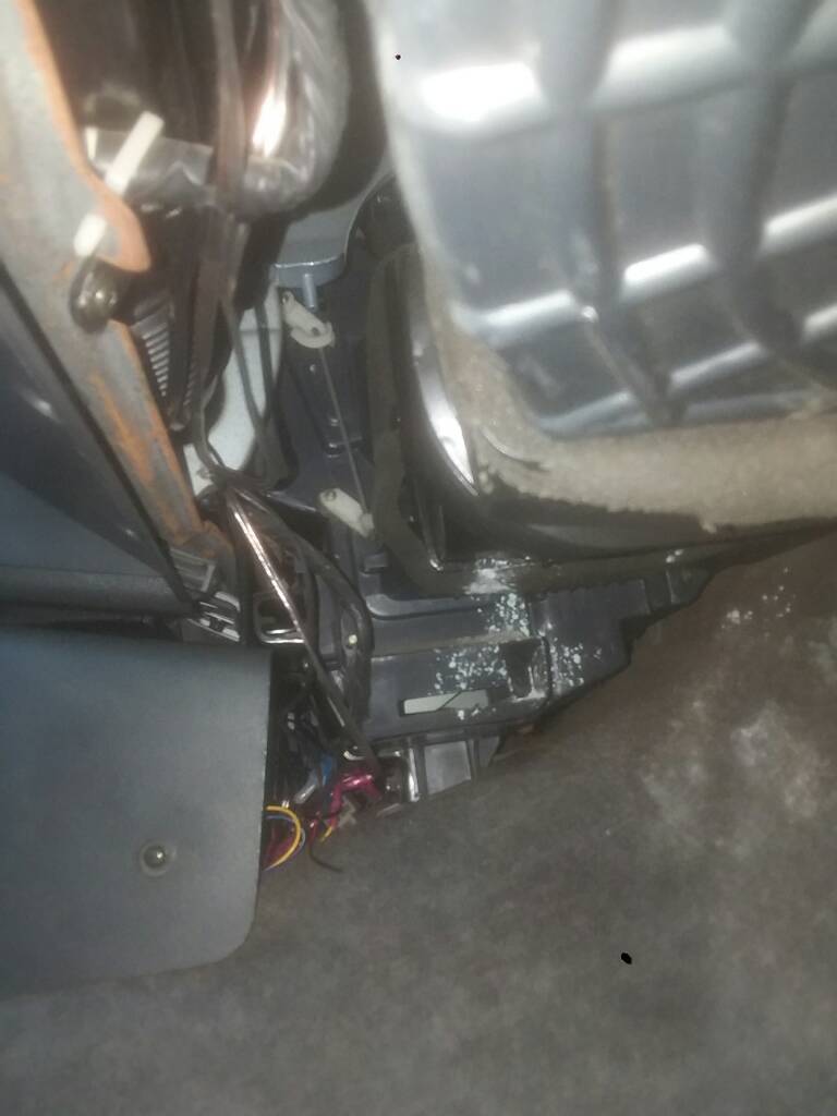

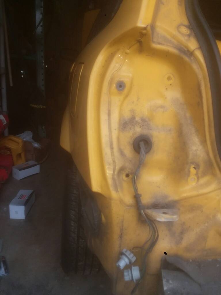

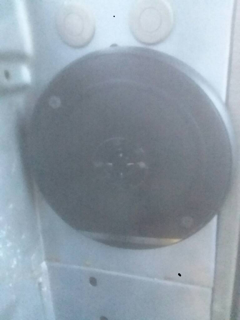

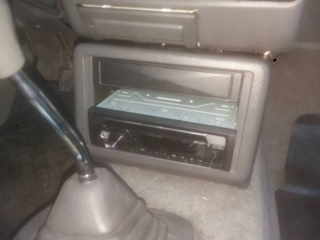

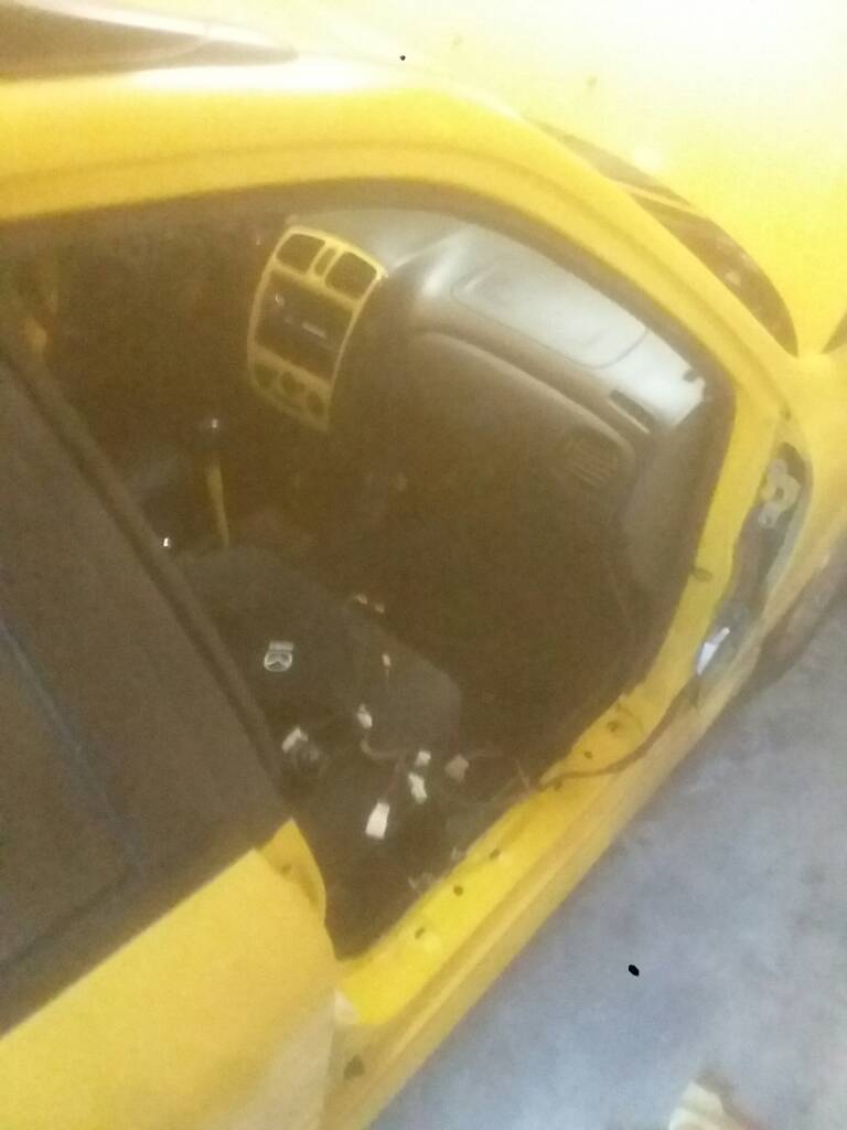

Well got the door off yeller today and Damn what a pain in the ass that was, there were waay more wire clips than I thought. Other than that I cleaned out tina and I put in a pioneer head unit and 6 1/2in rear speakers and 4in dash speakers as the stock stuff had been ripped apart, I had to completely rewire everything and then hide all the wires. Poor yeller is just a box for parts right now [emoji23]

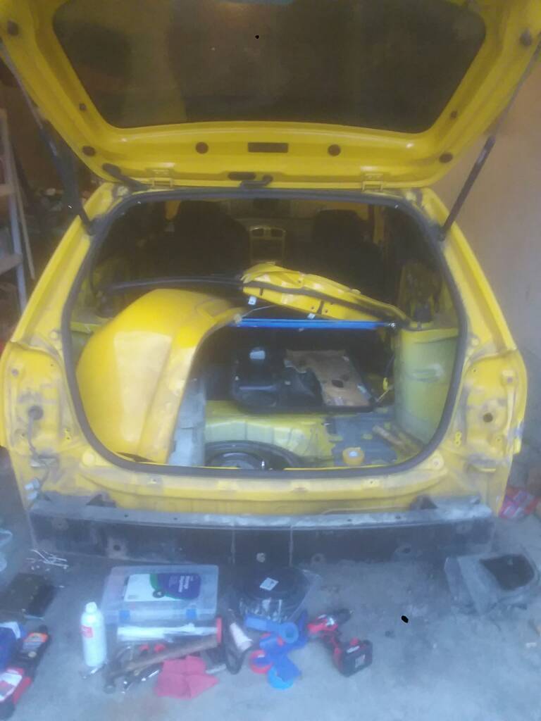

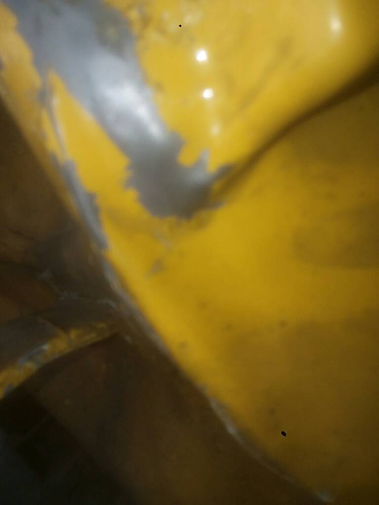

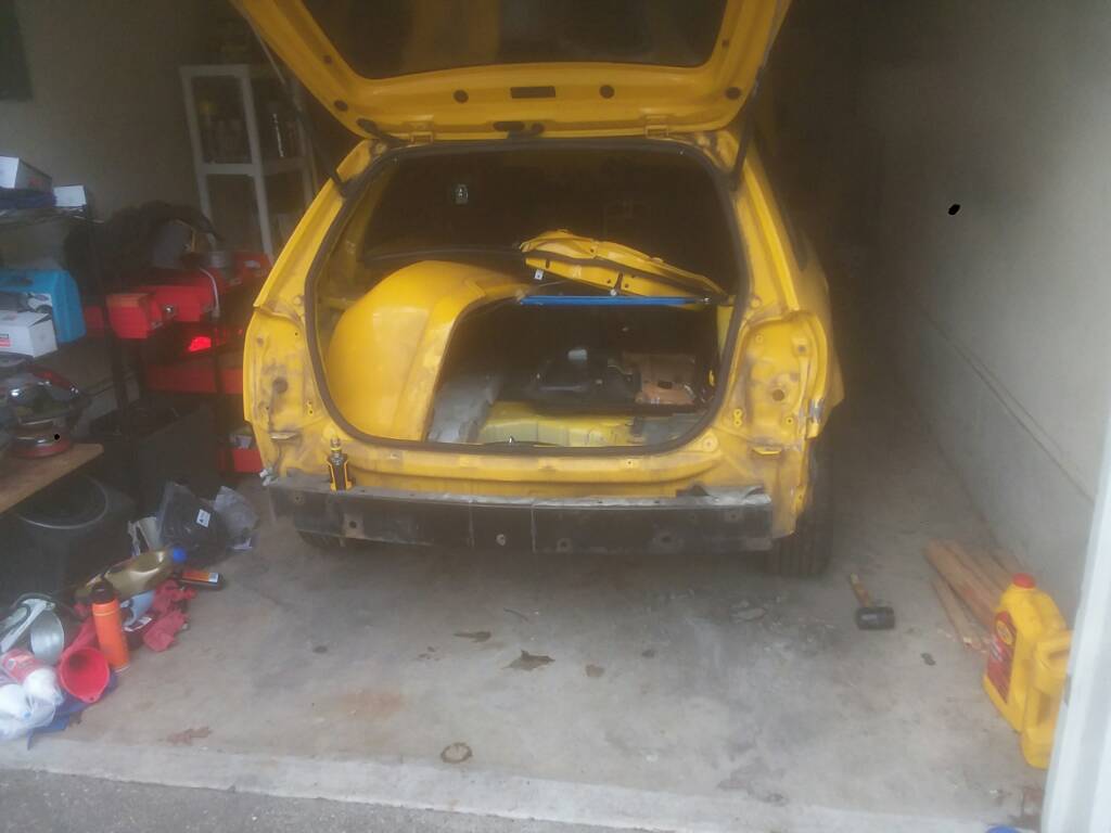

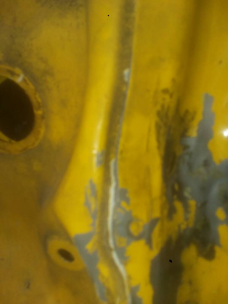

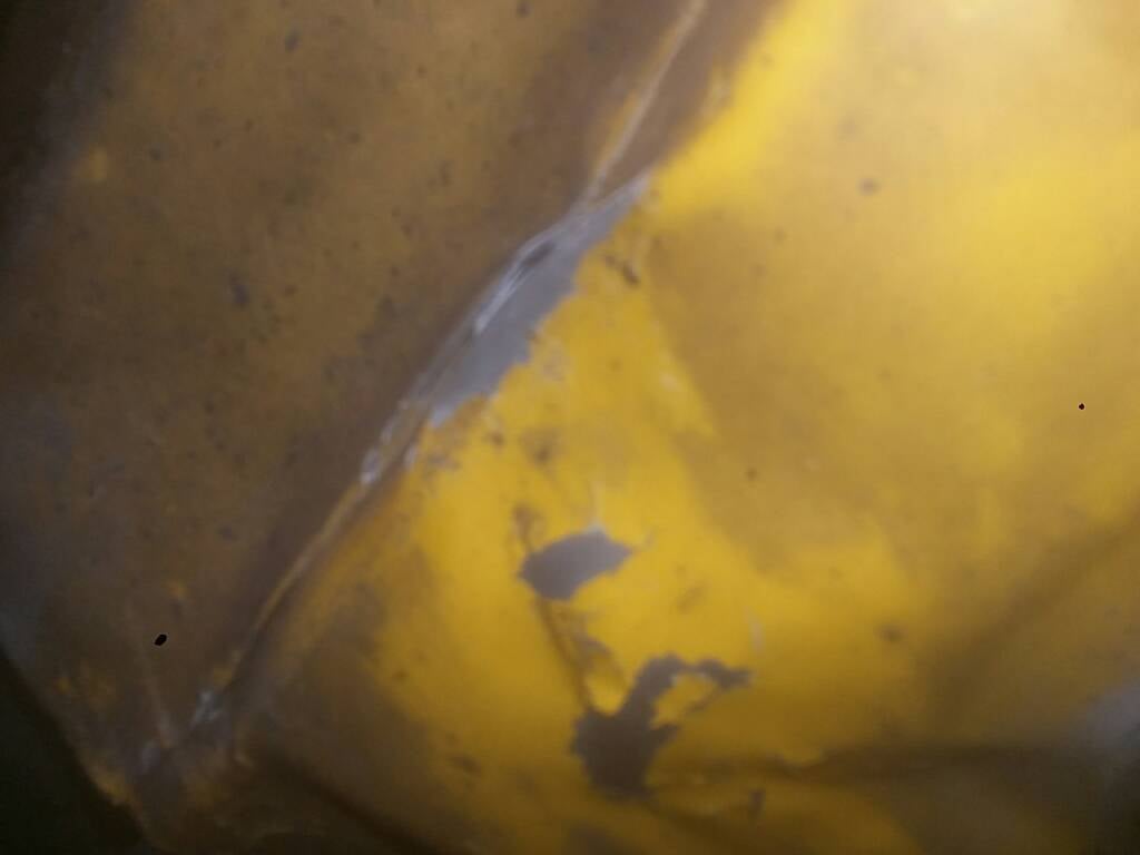

Kind of an update, I tried moving yeller to clean up the garage and found out the battery is dead. Shouldn't have been a surprise since I left the door ajar cab light on and with no door on that just drained the battery for a week lol. So I to a couple more swings at the rear, cleaned up a couple bigger areas. I can't get at three areas and it's really bugging me, I'm on the fence thinking about cutting the inside paneling to get to them. I honestly don't think it's a very good idea as I know very little about unibody body work and don't want to destroy this chassis (yet, or at least in the garage). Also small Tina update, she's on her second seafoam flush to get everything as clean as can be. Changed tranny gear oil next up is the rear differential and then drive it for 5000 and do another change. Currently using Lucas 75-90w I might change depending on how the shifting feels, it's still notchy but no worse than before.

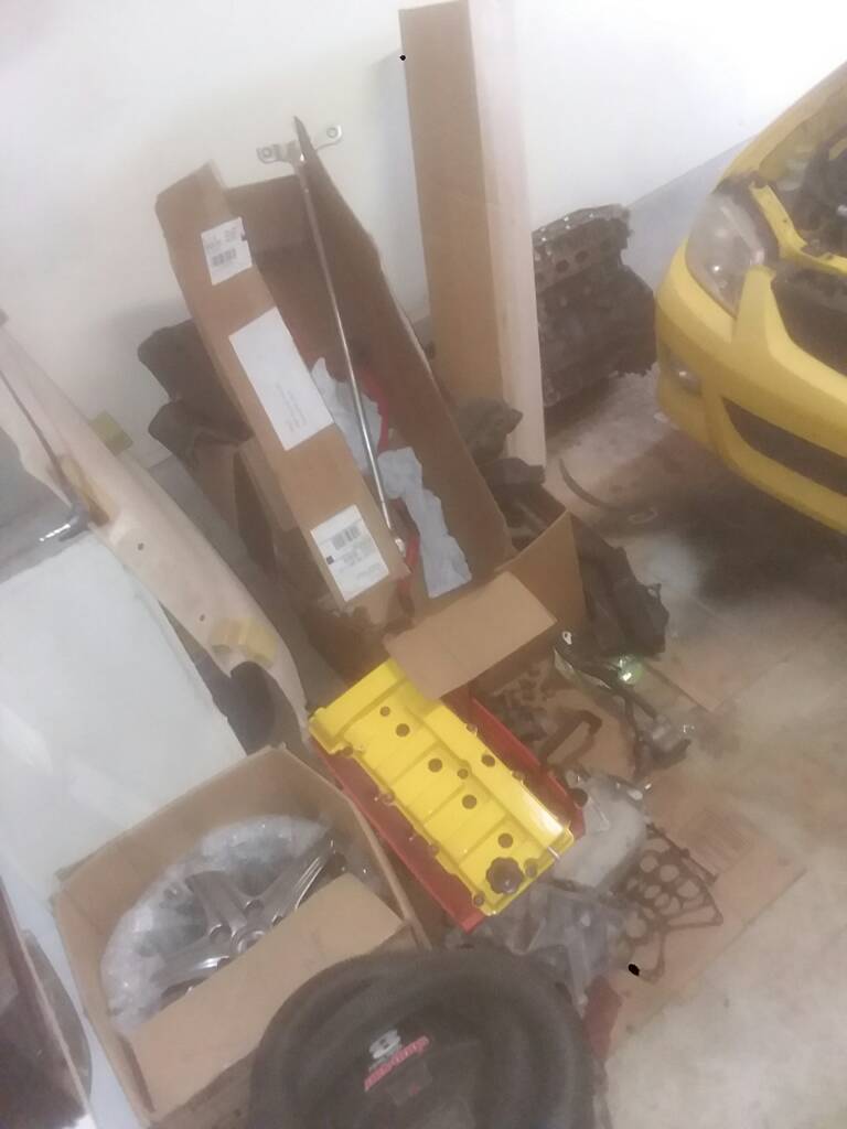

Well all in all the garage is still a mess, 626 engine still halfway torn apart, yeller still needs a bunch of tune up work, Tina still misses and runs like crap....... It's gunna be a fun broke summer [emoji23][emoji23]

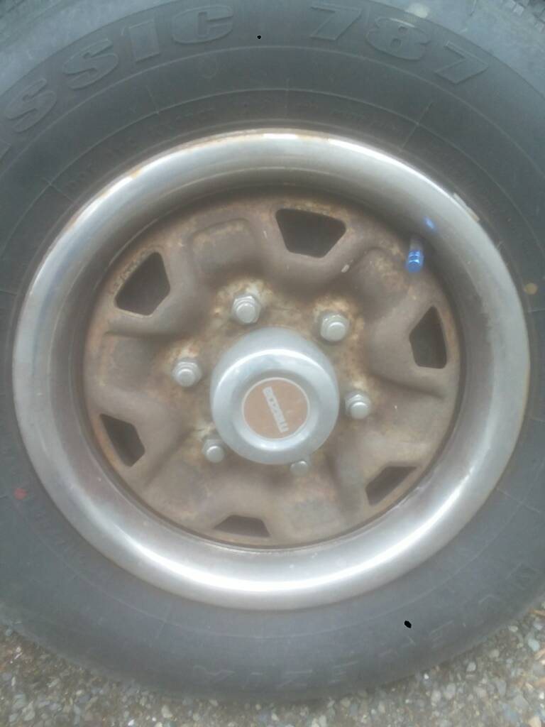

Still here lurking around but sadly no updates on yeller, Tina the truck got the engine oil flushed, trans oil changed, new air a oil filters and a pcv valve but still runs like crap. Pretty sure I'm hearing rod knock now yay but I got 2 rims painted and I was gunna do the other 2 today till the rain came. Lugnuts are gunna be changed out for some new ones wednesday so I got lazy and just painted over em. Right now I'm trying to figure out how I can squeeze a shop unit into my budget so I can use my tiny garage again and have room to work on the p5. Here's some pics of the rims, I'm a dunce and taped off everything except the brakes so now my rotor has a spot of primer but they already sound terrible, fingers crossed it just burns off without a fire

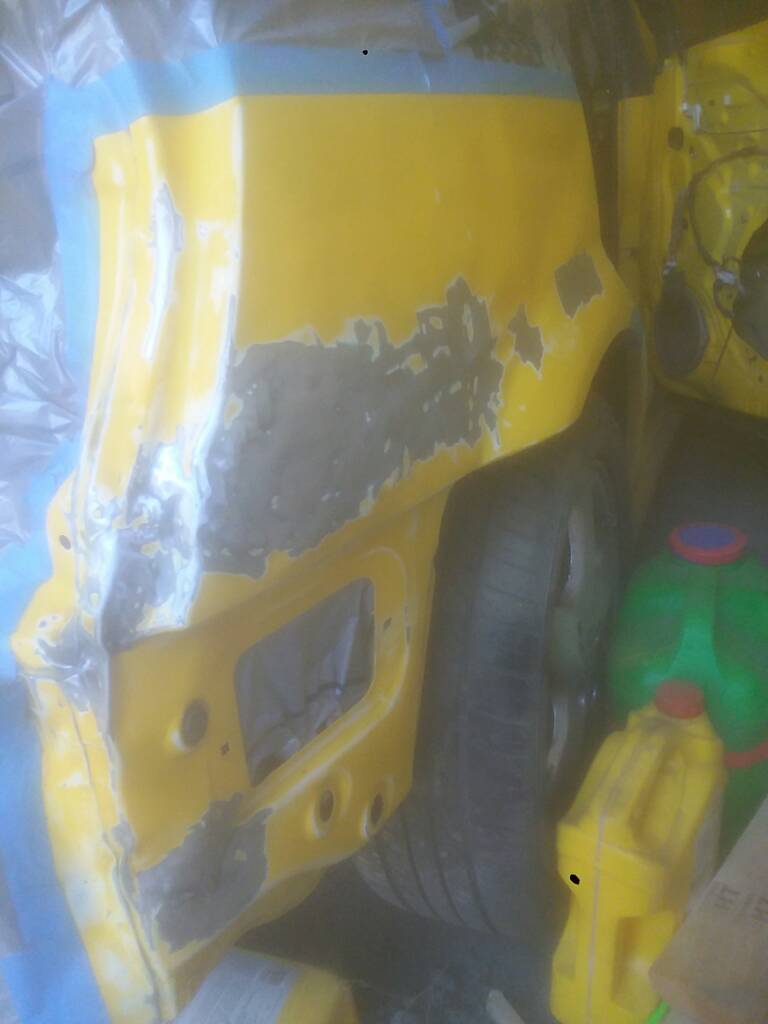

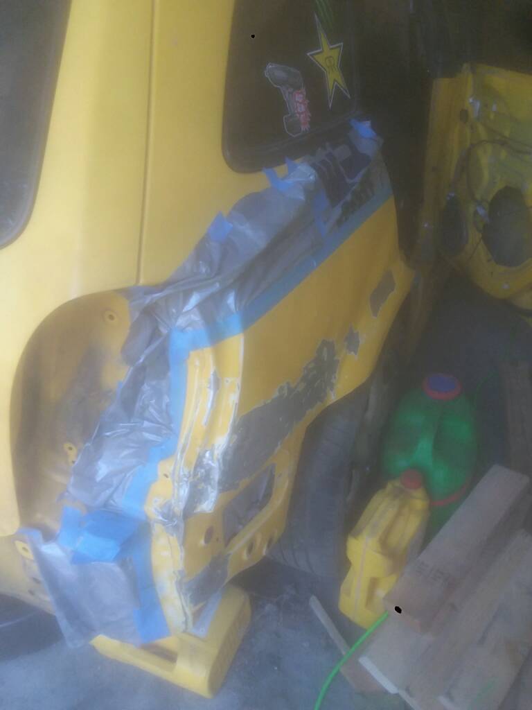

Old yeller is getting there slowly by the looks. Repairs look pretty good, are you going to fill and paint it yourself?

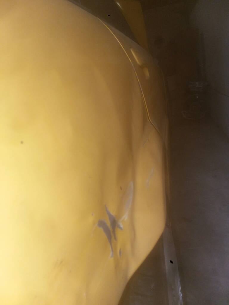

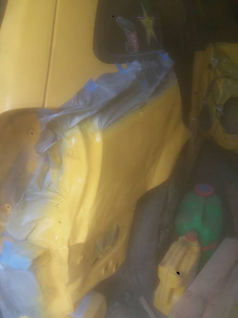

Thanks man and I thought about filling it but honestly it's not a daily anymore so I'm probably gunna wait till I can buy a donor car. Then I'll probably cut out the damaged paneling and weld in some clean pieces. I saw a guy replace the same panel on the driver side and it doesn't look too bad, just real tedious. It's just gunna be rattle can paint for now, I have some yellow and clear coat so I figured why not. I'm thinking about painting the whole car after I get new doors and panels ya know, do it once instead of trying to match paint later on.

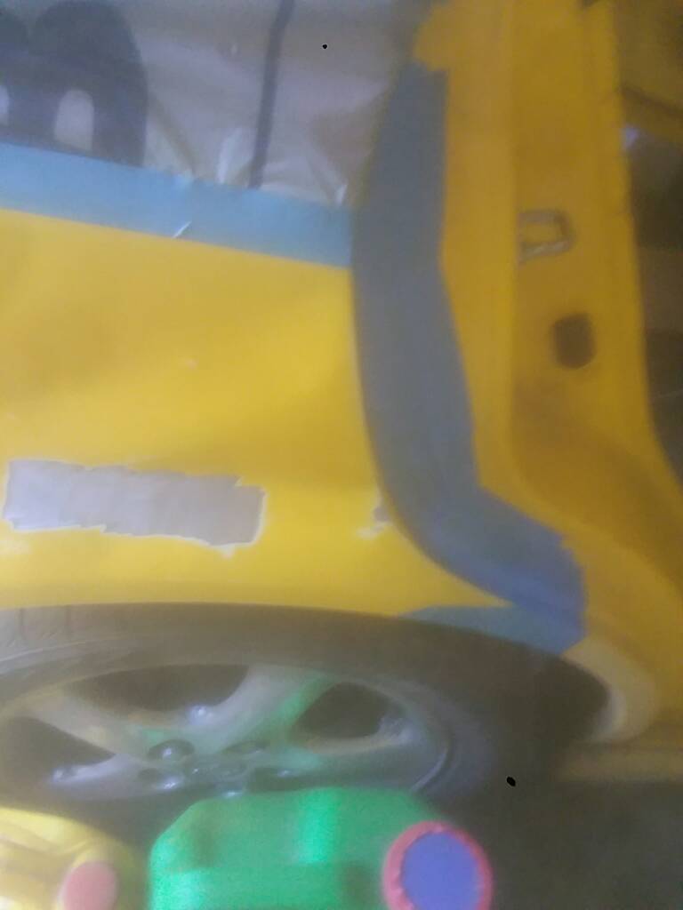

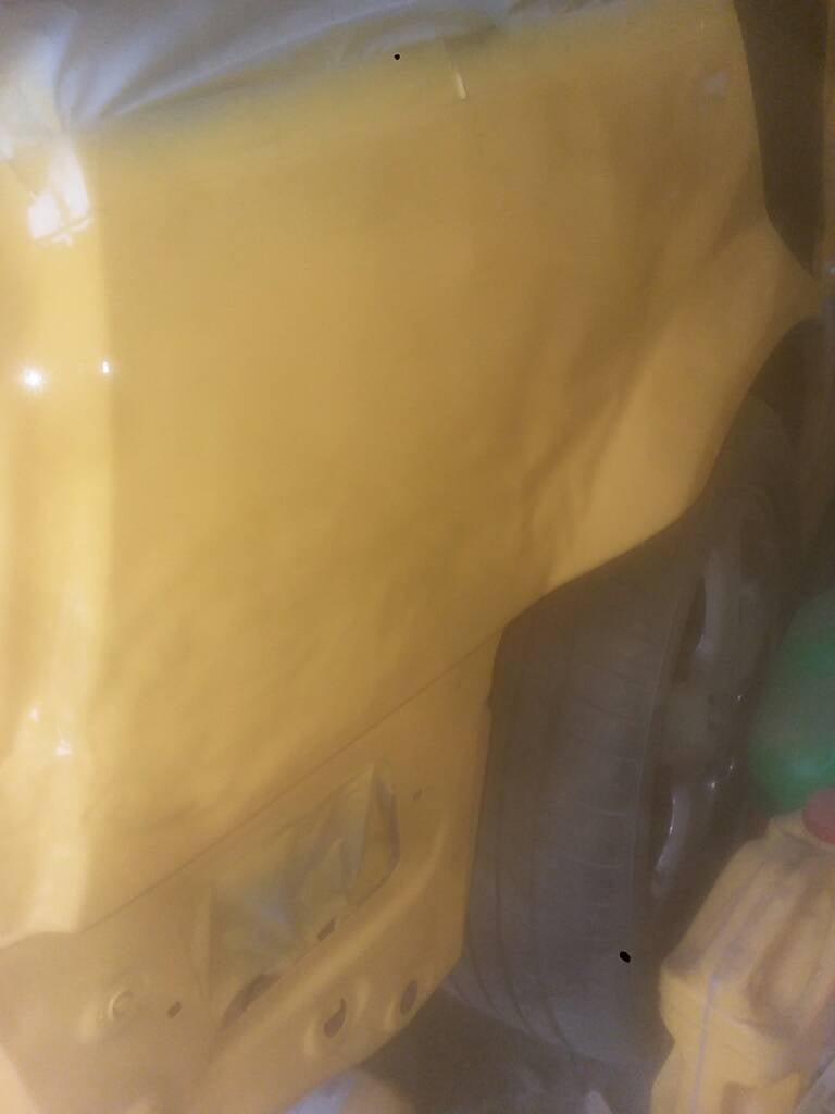

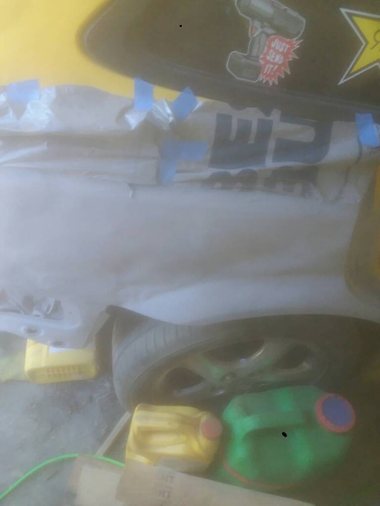

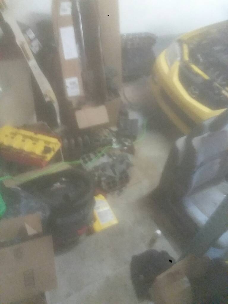

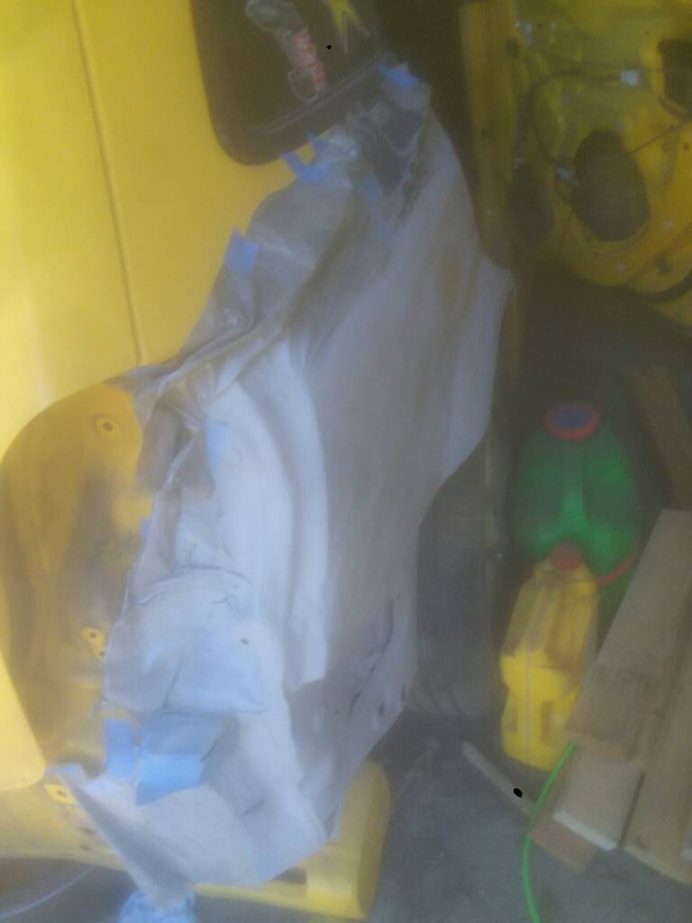

Well still working on paint when I get the time, second coat of yellow is on. I saw some primer poking through the first layer so I'll probably do another light coat just to be sure. As usual my paint job is pretty crappy, lines are inconsistent and it's starting to run here and there (Damn my heavy coats). But the color matches alright so I'm happy so far. Remembered I was sanding my intake mani because I pulled the vtcs, then I just kinda sat there as I realized I'm still on the first runner lol. Then I looked around and saw all the stuff I need to finish but have no room to do. I really gotta fix yeller up so I can clean the garage, it's a mess and I can barely walk through it let alone work in it. So ima try to save up for a door and a battery, and I might have a line on some goodies [emoji16] but that doesn't do me any good till I get the car driveable again. Btw the paint I'm using is plain ole rustoleum sunburnt yellow, it's matching alright so far but I won't really know till it's all done

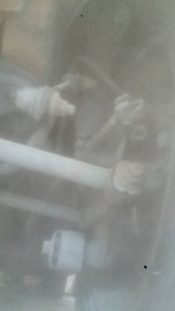

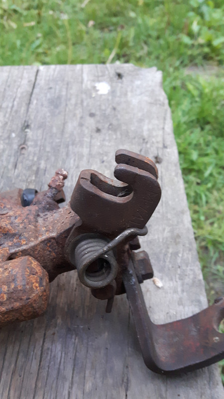

Got the first coat of clear coat on, picked up some garbage. Then I poked around my parking brake a bit. I tightened it down all the way and then worked it up n down with my phone recording what I believe is the parking brakeline. I can't figure out up loading videos so I just took a picture but that hook shaped bracket that the cable feeds through should be moving when I work the handbrake right? I have no movement but I get the tension in the cables, I also have no rear brakes atm. The rotors are ancient and I'm pretty sure I'm all out of pad in the back. When I bought it the previous owned told me it was a spring and I still had rear brakes then, any ideas? I've been looking through the repair Manual but it doesn't go too in depth on it.
This part is supposed to rotate when the parking brake is applied.
It not only applies the brake but adjusts the mechanism every time the handle is pulled.
If that doesn't rotate, your brake pedal height changes slowly and the front brakes start grabbing before the rears.
You may not be feeling the P-brakes actually grabbing but just the slack inside the brake cables tightening up inside worn out cables.
On my car the cables were seized enough that the coil spring on the caliper connection couldn't pull the cable back.
Try backing off your adjustment and see if you start getting movement.
Try prying the cable connection to help see if the cable is seized.
I put a spring assist on my caliper before I changed my cables.
Ok so I loosened it up, and did another videos, still no movement. I can pull the cable back and forth when it's loosened up so I don't think it's siezed. I tried moving that arm contraption and I couldn't get it to budge with my hands, I tried both sides results are the same for both. Could those arms be seized up?
