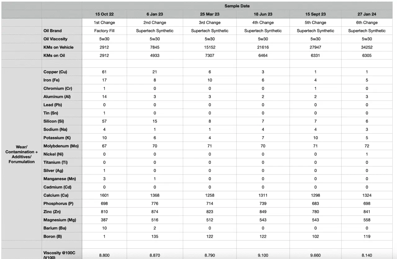

2022 CX-9 here: I just got my latest UOA back, and thought i'd share. This was my sixth change, and everything seems to be settling in nicely. I consistently have a small amount of Potassium showing up however.
Has anyone seen this, or hypothesised sources of K that don't include coolant leak? It's not enough to show any major signs of failure, but it's not ZERO.
I have heard that some cooled EGR systems can cause trace amounts until they fully break in, but I haven't really seen this in any of the examples in this thread (though there are a lot of pages!).
I'm also wondering how much affect environment can play. We're on the east coast, and live next to the water. There were also a few forest fires last summer, and we were close enough to have ash fallout on our property, apparently that can also cause trace amounts of Potassium.
Next sample will be with Pennzoil U.P. i'm curious to compare.

Mine has 0 Potasssium but I use different oil. I am in the desert if it matters but probably not.
The mazda factory fill had some Potassium on mine too.
It could be the oil type. See other UOA for the same oil and compare.
All seems good.

OK, nice! Fresh samples of Supertech Synthetic does not contain any K, but will keep watching.
All these samples I have been sending to Toromont for analysis. It's a bit costly to ship across border to Blackstone, but I probably should send one there to compare values.

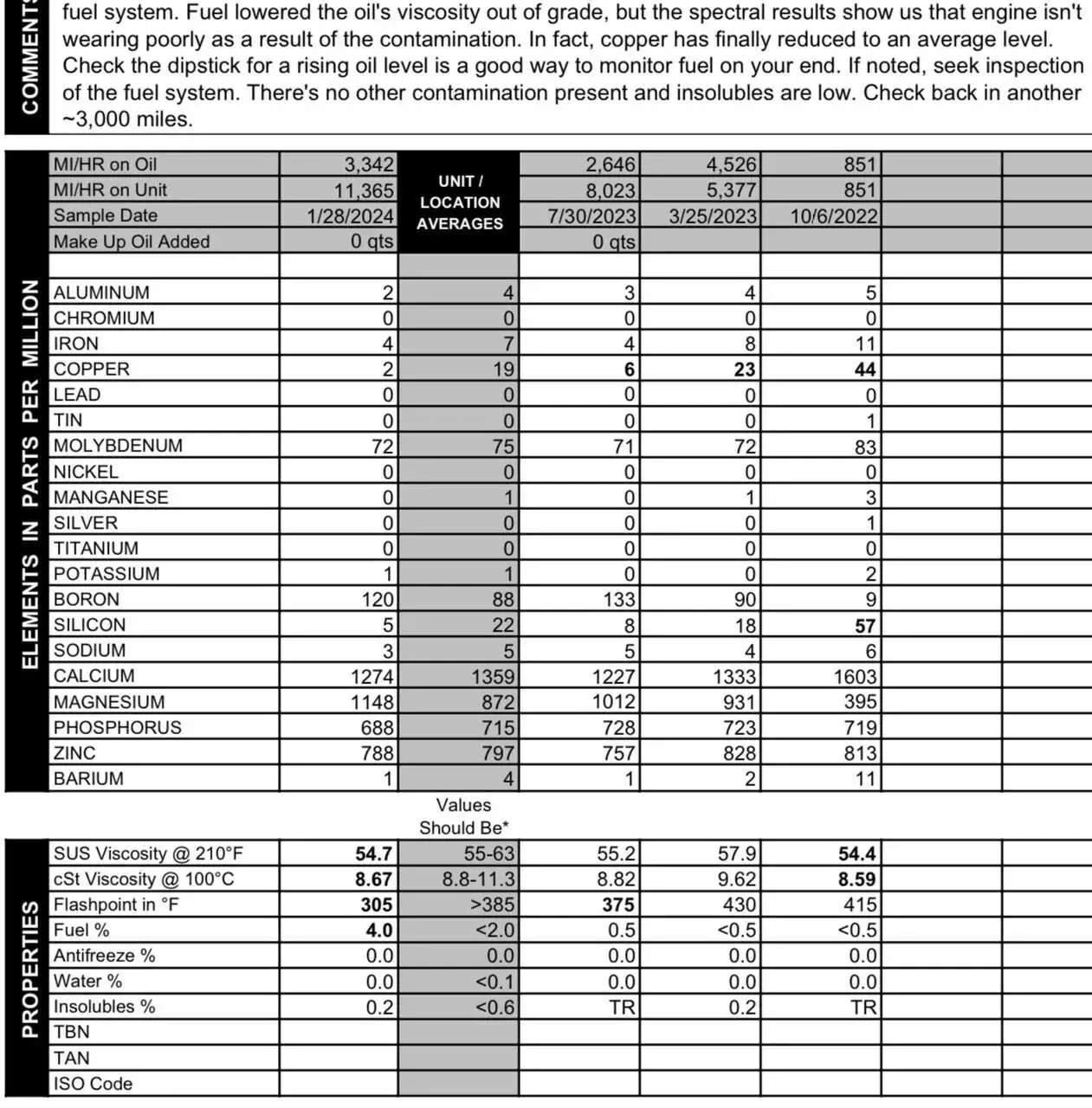

Latest UOA with Amsoil Xl 5w30 for 2.5T . Fuel is creeping up lately. Likely I would try another oil next time , something from the Euro league that has higher viscosity and hths.
4% after only 3500 miles. Viscosity is still ok, if not a little lower than in the past. Flash point is low. Do you think you went on throttle more this interval?
Yes. because of the summer uoa dillution , this time I went on a longer drive before removing the oil. But I do have terrible short term drives lately and this winter was unusually cold here. So probably that plays a role.
The oil held up ok for the interval but is borderline. The elements are almost none. But if I went for 6000 l-7000 it may have been different story.
Also I dont trust Blackstone fuel % - its likely more. Will check/compare other lab next time.
I rarely go at high throttle unless on ramps or highways and that probably also plays a role + short distances.
The euro c3 spec oils may be better fit for dealing with it. I do change oil frequently and because I dont drive the Turbo much its usually less than 3-4k miles per interval. The engine top is very clean when inspected from the oil cap.

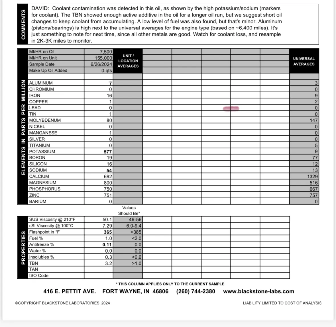

2017 cx5 bought new. We had the oil changed by the dealer for the first 100k. I’ve been doing it with Mobil 1 since then. Tested the oil for the first time (155k) and potassium and sodium was high. There was slight coolant loss. I’m about to send in a second sample after putting 1500 miles on it to see what we get.

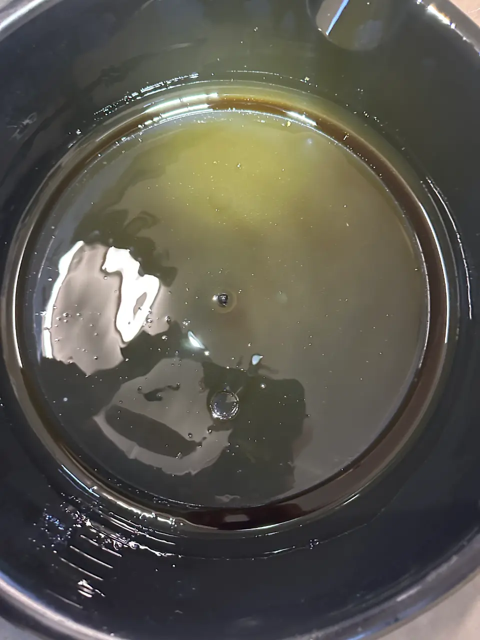

Also, take a look at the bottom of the bowl I used for the oil filter. Maybe 1/2 cup landed there but look at that glitter. I'm not sure if this is representative of the oil that came out of the pan, but the oil analysis gives me some peace of mind.
Why is copper that high in the 2nd oil change?
Iron is bit higher too.
mine (copper) was at 44 - 850 miles first oil change and then 23 after 4500 more miles next oil change. On the 3rd oil change it dropped to 6.
iron started at 11 then went to 4. I do change oil every 6months.

I suspect the glitter is there on most of these engines when new, but you have to look for it.

glitter is normal in a new engine here was mine..I have been changing oil in new cars since 1977 and first oil change and often second oil change especially if the first one was changed early which I have always done has glitter. if you want a shocker cut open the oil filter....
