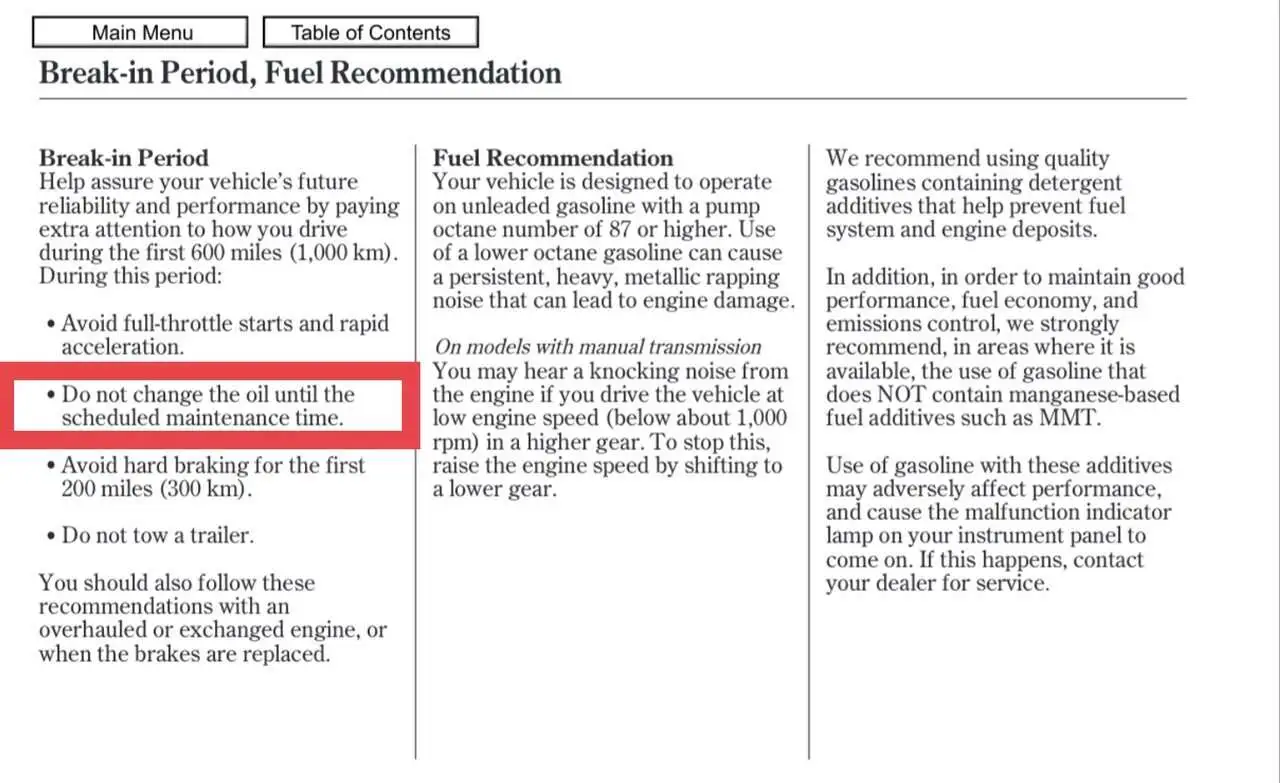

Firstly, Mazda uses high-moly factory break-in oil (on the 2.5L NA) with the purpose like Honda does. Honda specifically stated in its owner’s manual on break-in period that don't change the factory oil early. Mazda says nothing on this but it doesn’t say you need to change first oil early either. Use Flexible OCI as the guideline and change the oil accordingly would be my choice. This means the first oil change is like the rest, 5K~7.5K miles or 12 months whenever the Oil change due message is displayed. And I choose a bit earlier on the first oil change (30% oil life left) with the same Mazda Moly oil. Changing the factory oil too early may just throw away the factory “break-in” oil designed for the purpose.
