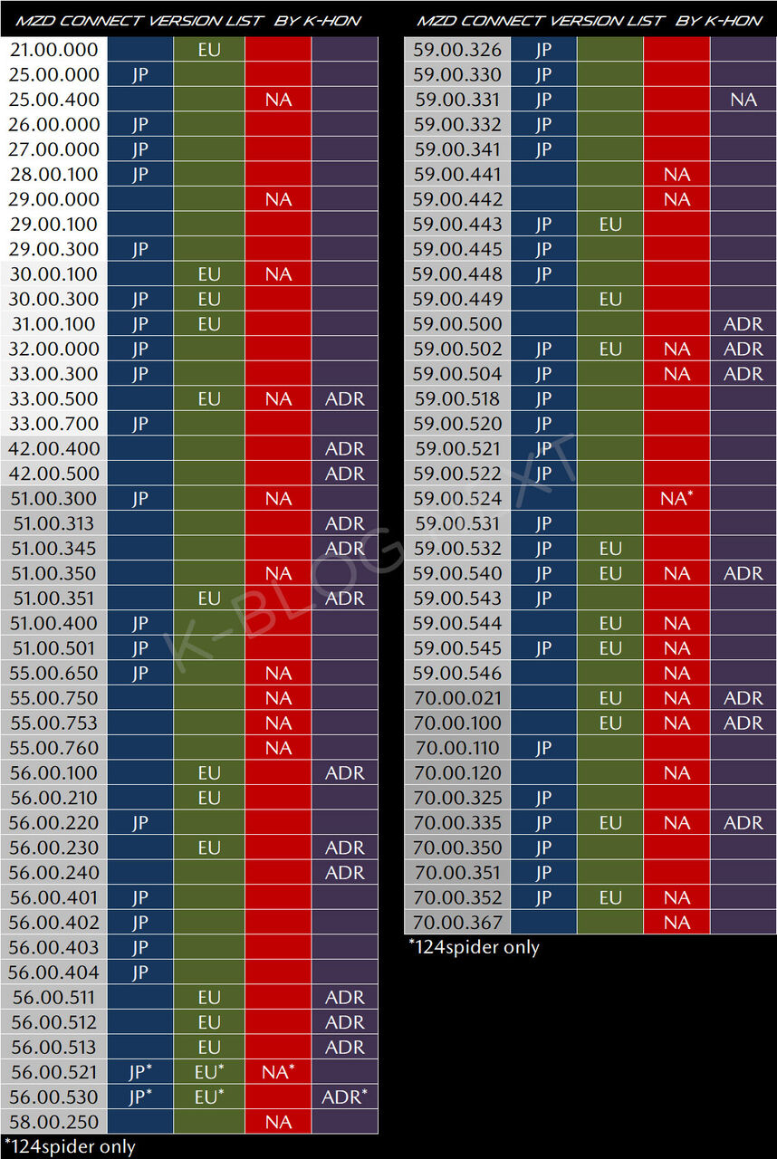

got info that a new update is forthcoming; no details; hopefully a fix for the Sirius issue as this firmware is for NA only:
70.00.367 has only been release for NA so far, and we have no release notes.
I pulled this image from a Japanese blog (https://kblognext.com/archives/7226.html) that shows firmware release history and which markets they are for:
