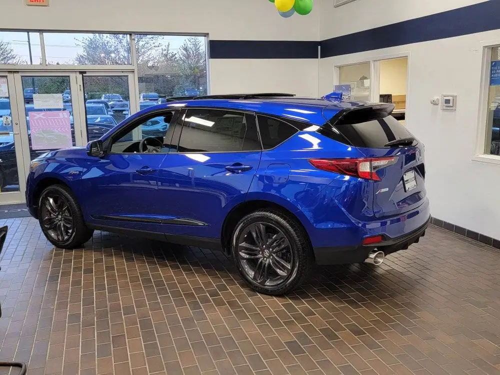

Yep. I traded my MDX and I must say the entertainment system in the Acura is worse than any car I've owned. It had bugs and it took years to fix it.
