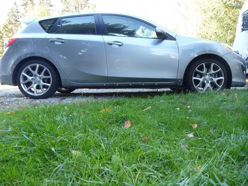

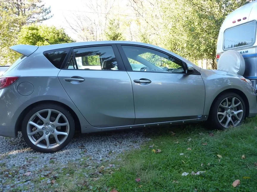

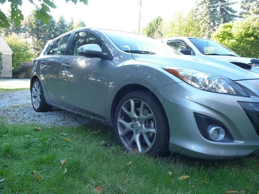

side skirt off
Had the unfortunate mishap of curbing my car a few weeks ago. I hit toward the rear wheel and it pushed the side skirt off of 3 clips and put some nasty looking scratches on the side skirt. Luckily most of the damage is on the underside and not too visible.
I decided to remove the entire skirt and will take it to get touched up or repainted.
Here are some pics with the skirt off. I managed to get it off without removing all of the clips. Once you remove the two clips behind the front wheel (inside the wheel well), the whole skirt can be slid off by pushing it toward the front of the car (a few spots need lifted before they clip will slide).
It's too bad they're drilled/clipped in like that. I actually thought about taking mine off till I found out there'd be a line of holes.
