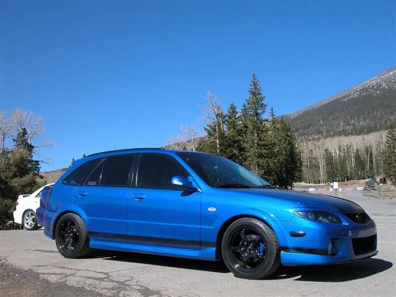

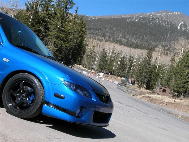

Is there any aftermarker (cheaper) side marker for the front bumper than the OEM ones. Orange or clear?? (see picture!)
if i just fill up the hole... what should i use to fill it up??, will it last???... even if i use it in winter -30 degrees celsius???will it crack?....

Not for the P5 specifically (that I know of). I know some members have retrofitted Celica or RX-8 markers on their bumpers. Do a search, IIRC there are some how-to's on how to fit them.
Others have used nite shades or even a flat black paint to tint them (wanting to do myself).
If you should find there are black (smoked) out there aftermarket please let me know!!
Mine are painted with night shades translucent black paint.
Otherwise do a search for posts started by azeli73. Eli did a how to with Celica lights.

96-00 celica, ebay 10.00 shipped + bulbs of choice + how-to mentoined above = circled area in picture in 1st post.

HOW-TO = http://www.msprotege.com/forum/showthread.php?t=20239&highlight=side+marker+how-to
EBAY LINK = http://cgi.ebay.com/ebaymotors/TOYO...33715QQitemZ8061039203QQrdZ1QQsspagenameZWDVW These are a little pricey compared to the ones I scored. These are the same ones I used but there are some for other year model rx-7s & some others too. The celica ones I know have the same bulb fixture as the P5 so it will twist right into the celica housing & probably the rx-7 housing- not sure about the fixture on other lenses.
