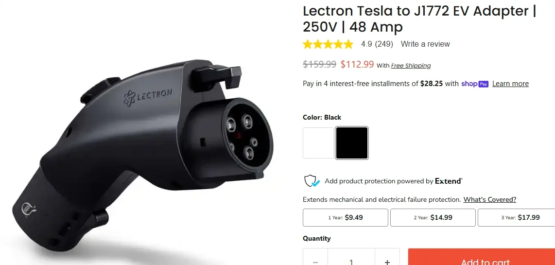

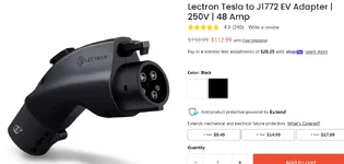

Hmmm...I was just looking around at adapters myself, but just to be able to use at other charging stations on the road. Here in Hawaii J1772 chargers are hard to find. Would be nice to be able to put on an adapter and use any other charger. I just wanna make sure we don't run the risk of any damage. I think you need to try to find out how many amps that tier 2 charger has. I mean, with an adapter, does it matter? Does the adapter only allow for a safe amount of power? If so, then should be good. Here's one I'm looking at.
The plug in your garage is likely just a 240v outlet, but that is already a great start.
I think you need a level 2 charging cable/charger, that will plug into the outlet in your garage. I don’t think you can use the level 1 charging cable you have even with an adapter because it won’t be rated for that current and voltage.
You can check that post (although it gets a little confusing because it is a mix of comments from people having your set-up and other people having to get electrical work to wire the plug that you already have).
