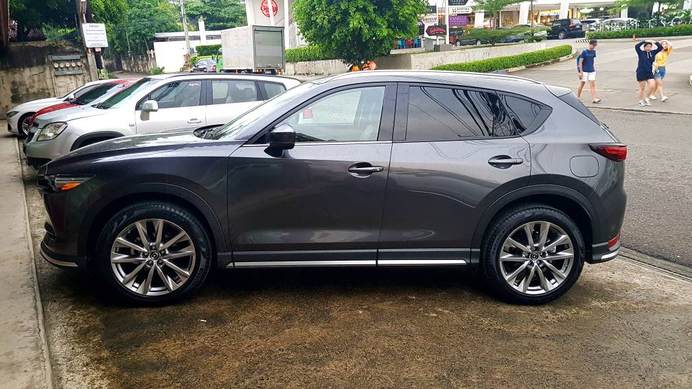

Put on some 2017 CX-9 take offs. 20x8.5. Now I don't know whether to add a coil over drop or not...
The xtra width makes them close to flush
That's a great looking wheel on your car, but my guess (from the way the tire/wheel fills up the wheel well) is that you're using the tires from the CX-9 as well which means they're 1.3" larger diameter than what the car came with. If that's the case, what's it doing to your gearing, speedo/odo readings, etc. It doesn't look like it needs lowering, but that may be the least important issue here.

loving the liquid silver paint.
you need to lower the car though ;)
