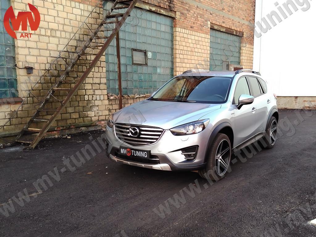

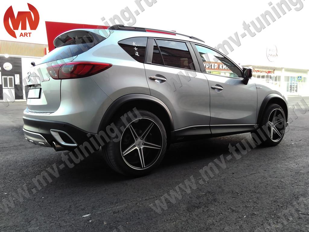

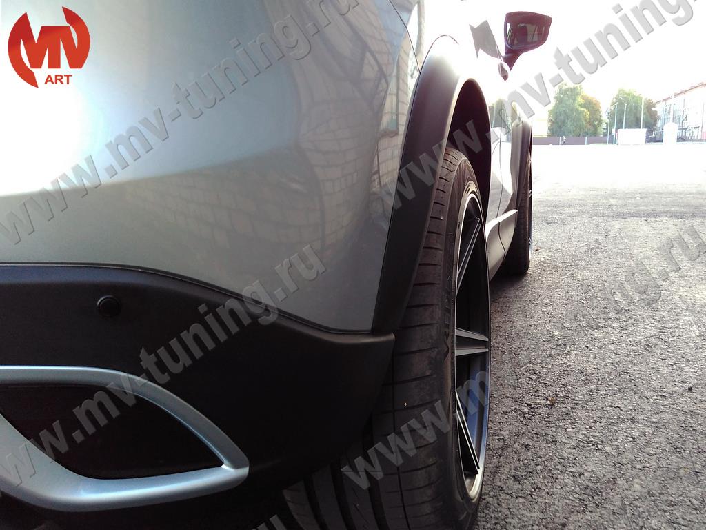

ImVKool
CX-5 2015 Diesel 2.2 sportsline black all incl.
275/40R20"J10ET35
In my opinion a bit more black would fit good and would lift the optic a lot. Maybe foiljob on the doors or the hood or both and of course the underride protectors must be blacked and the things around the fog lights as well. Otherwise I would always suggest to color the fenders in the color of the car, what is the usuall routine.
But in the end the owner must like it and I like the work in it!!!

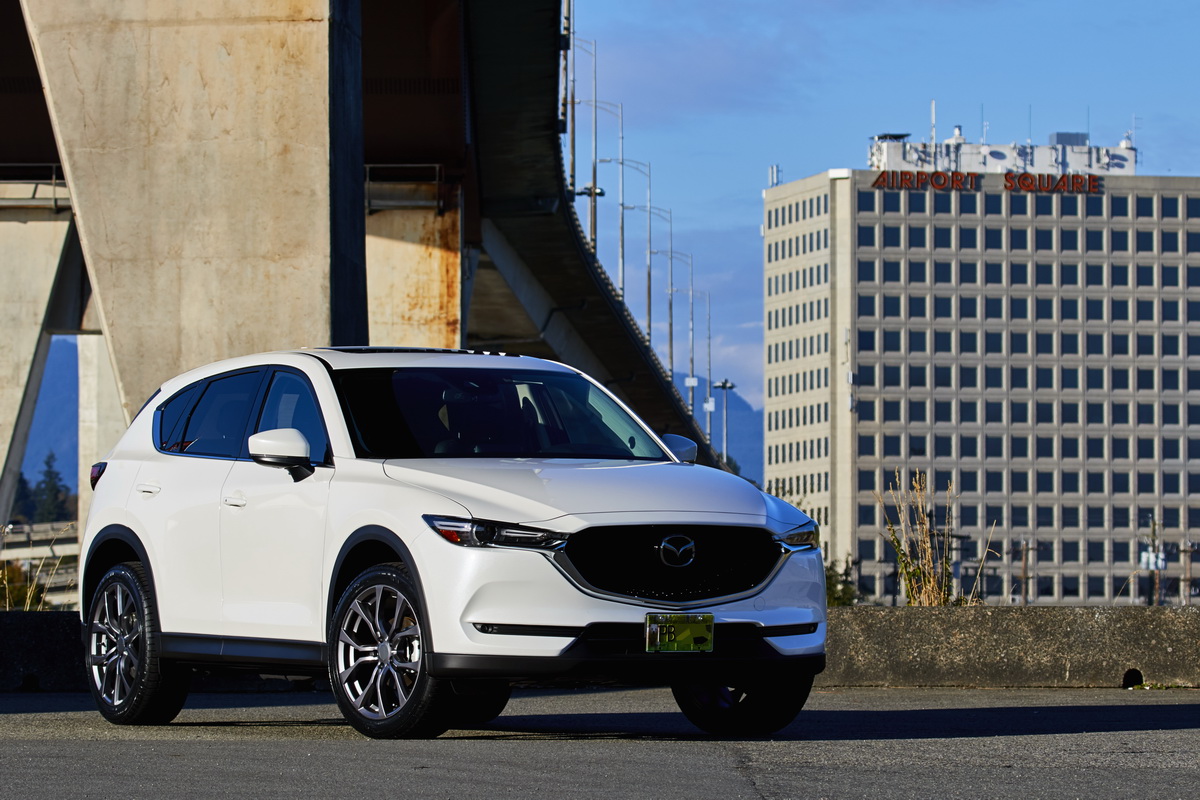

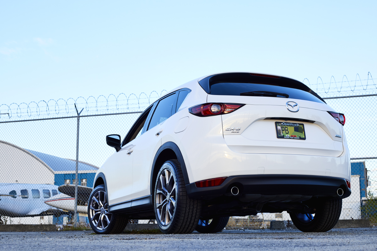

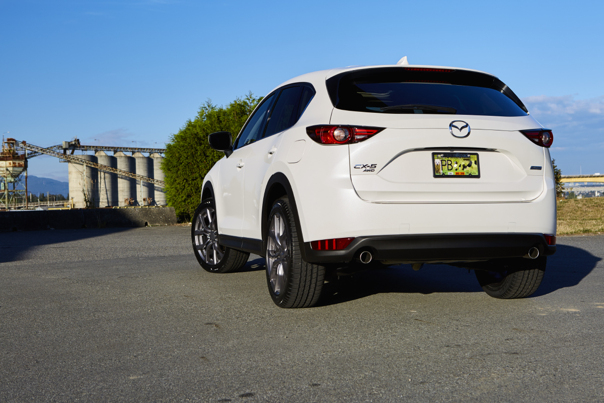

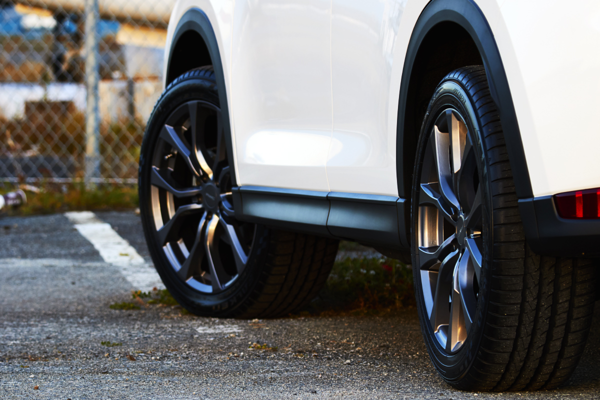

SndChsr
2017 CX-5 GT
Here are a few of my RWC MHK80's
20/8.5 ET42 wrapped with Falken Azenis 255/45 R20
These are quick shots. I plan on a proper photoshoot in the next couple of weeks.
SndChsr
2017 CX-5 GT
Gorgeous! How does the ride compare with the OEM wheels/tires?
Thanks Pete. To be honest, the ride quality did take a bit of a hit. It no more "floats" over the roads, but at the same time, it doesn't also feel like an Sherman tank. I think it's quite acceptable.
