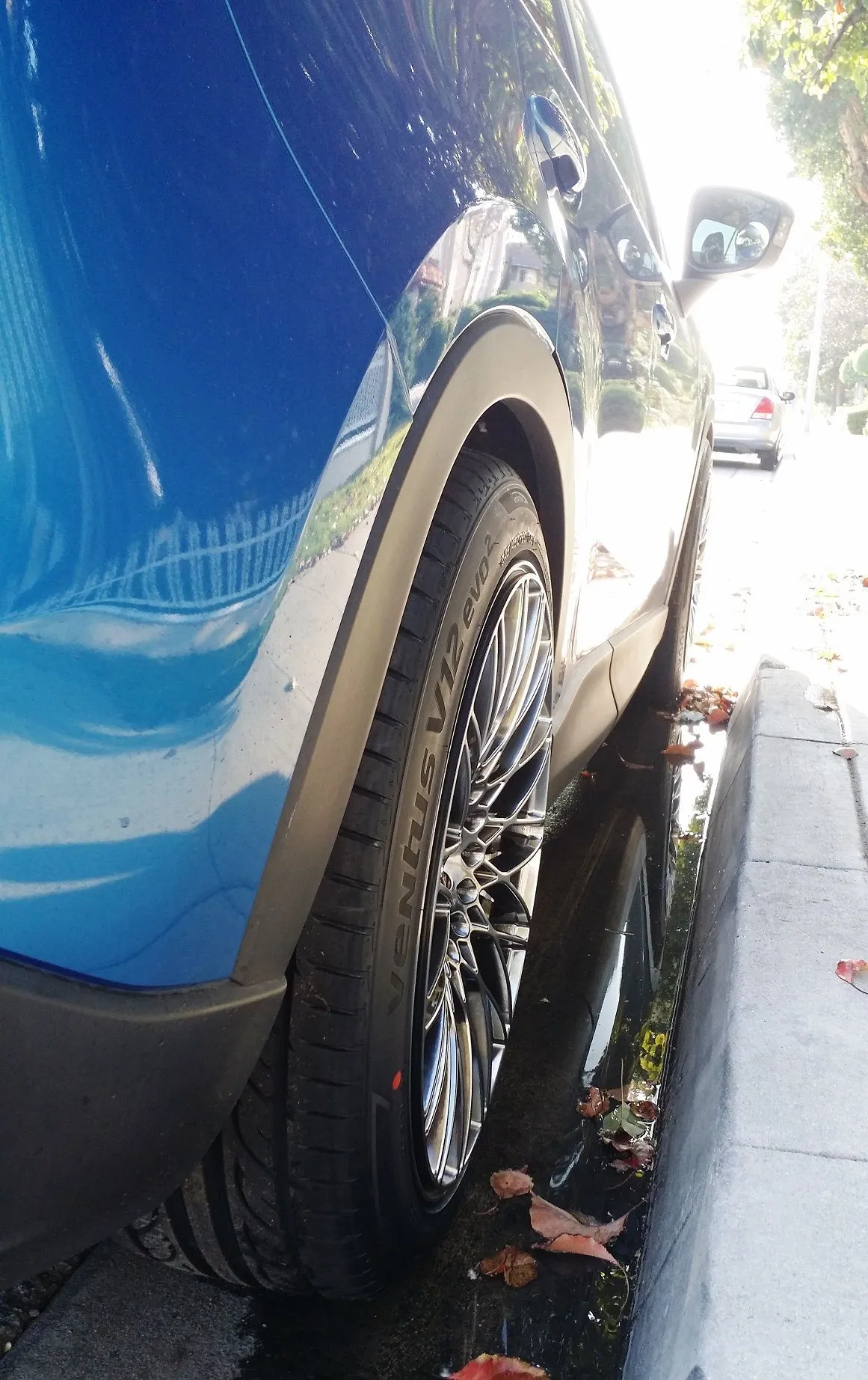

Hi LoinCLoth. The wheels look considerably larger than stock. Much like you, the thin width and whimpy stance bugged me. If you want to stick with OEM wheels, then increasing your width is limited. I think 235 is the max you can go. There is a great thread that lists all possible wheel/tyre sizes for our cars.
As far as rubbing, I don't think you need to worry about that unless you go to a 275 tire. My wheels are pretty much flush with the fenders now. I am however debating 5mm spacers. We'll see!

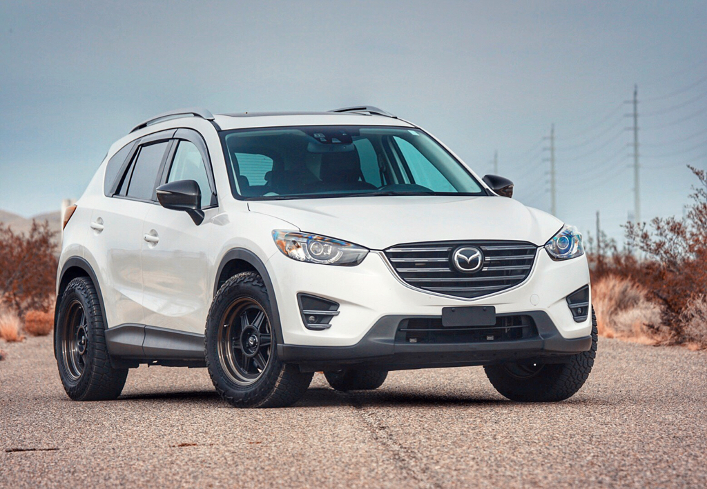

With some inspiration from SIGNAL_CX5 installation, I went with the following install today: Removed the stock 19's and replaced them with 245/65/17 Falken Wildpeak AT3W on Velox Apex Black 17x7.5 offset 40
They look good, but how is the ride? I'm guessing that the ride should be more "floaty", no?
I'd be curious about the same thing. Did you lose much steering response? I'm sure you gained a more comfortable ride. Was there anything else you noticed with the change to the 17" from the 19"?
Looks great! You won’t be winning any races but the ride is a lot smoother than the 19s for sure. Feels a lot more sure footedness. You may rub on full lock. I notice is mostly on U-Turns.
Looks great! You wont be winning any races but the ride is a lot smoother than the 19s for sure. Feels a lot more sure footedness. You may rub on full lock. I notice is mostly on U-Turns.
Would you happen to know your wheel and tire specs? Looks great by the way! Contemplating on going to 17" for a winter set up. Thanks.
These tires have stiff sidewalls, so they corner very much like the 19's did. Overall, there is a better ride, a little more dampening. I have air bags in the rear, so the rear-end is still a little firm.
The only major difference I notice is the speedometer is 2mph off (slower than actual speed) So you have to set cruise control to 73 in order to drive 75mph.

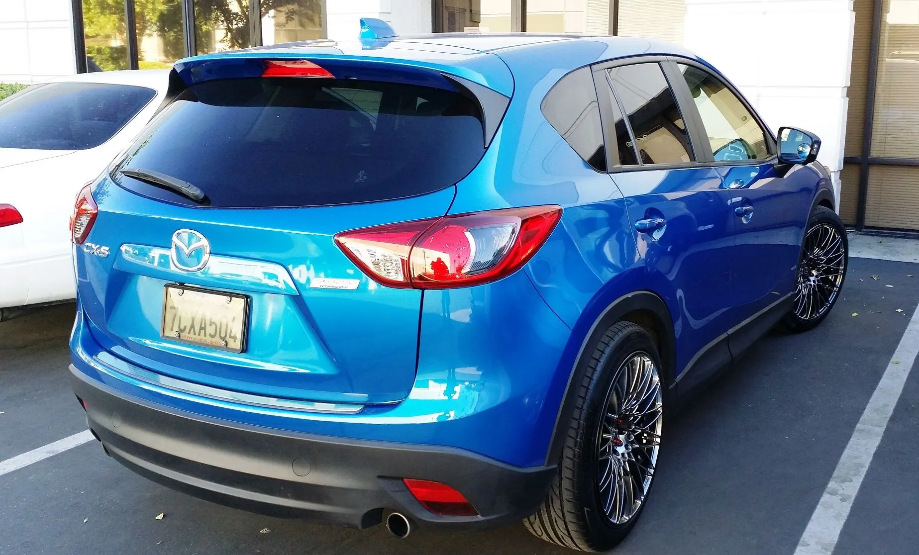

Here is mine:
attachment.php
attachment.php
attachment.php

Here is mine:
attachment.php
attachment.php
attachment.php
I love the look at this. Could never lower ours though. Family car.
