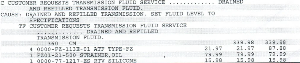

I finally got the transmission serviced, and the total with tax came to $523. I didn’t get the coolant done since it’s fine for now, but I’ll take care of that myself once the weather warms up.The transfer case and rear differential, I will also do this once it warms up.
What exactly did they do for $523?
Replace transmission oil and replace internal filters.
The trans pan was removed, the internal filter changed, and the pan resealed along with how many quarts of FZ? They did use FZ right?
Seems like a high price for this service.
The receipt looks good, the right fluid and the right amount are both listed at least.
Actually, $500+ is about what dealers charge for ATF drain-n-refile in CA. (SF Bay Area)
10 yrs ago, it was about $250.
Cost of living is very high here. Everyone needs to make a living.
